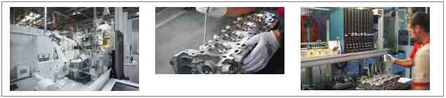

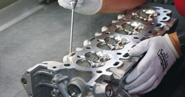

I am entrusted to the technicians who will work on the two cylinder heads of our V8. The first stage, using automatic high-precision machines under continuous control, consists of the so-called roughing-out. The front and rear side and the side that will accommodate the cam cover are smoothed. The machine carries out the milling and drilling operations automatically. At this stage nothing is done by hand, not even the magnetic insertion of the valve guides and seats using the thermal interference technique.
Here two robots – called Romeo and Juliet, given the complementary nature of the operations that they carry out – insert steel seats and guides (cooled to -196 degrees at the minimum dilation) into the head (which is heated to +180 degrees at the maximum dilation). The two components eventually unite and, on returning to room temperature, become solid without the need for any further operation. It was interesting to see that each component is photographed and scanned by a machine that, if it detects even the slightest defect in shape, rejects it immediately.

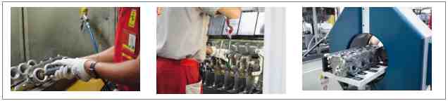

Although I am in a high technology workshop, manual operations have certainly not been abolished. As we used to do as kids, when we dismantled the engine of our car or motorbike to polish the ports and get a bit more horsepower, here accurate finishing work on the crankshafts and the camshafts is carried out by hand. As if this were not enough, the components pass through the metrological room – where the environmental conditions are identical throughout the year – for the final compliance checks.
