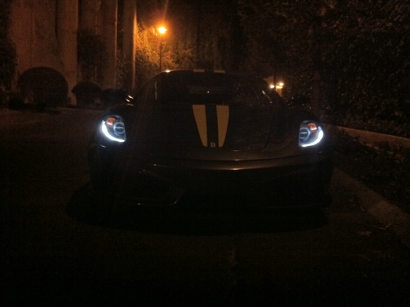

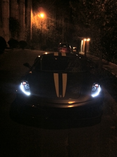

430 scud led lamps

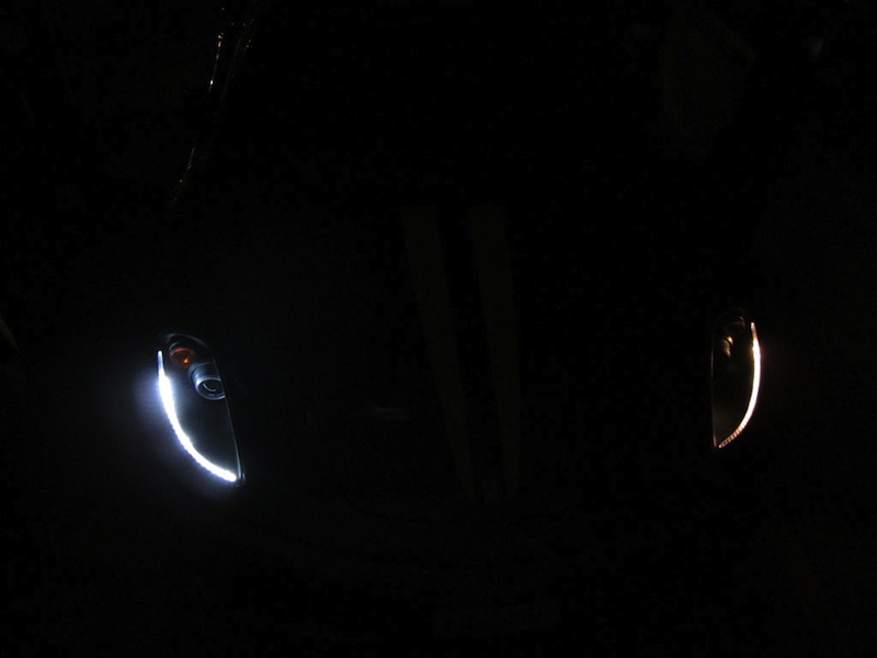

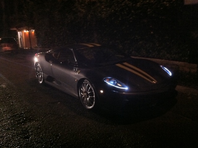

I made this mod inspired in the work of another forum member.
It make the car a more actual look.

I did the same to mine but yours looks different somehow. You didn't use the Ikea lights did you? Did you use the newer ones suggested by lilleprins?

Sooooooooo sick. You have one of the best looking Scuderias I have seen.

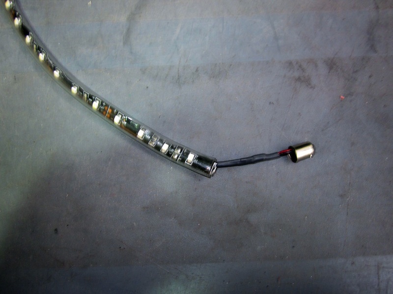

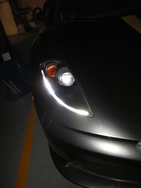

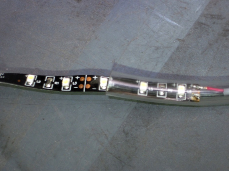

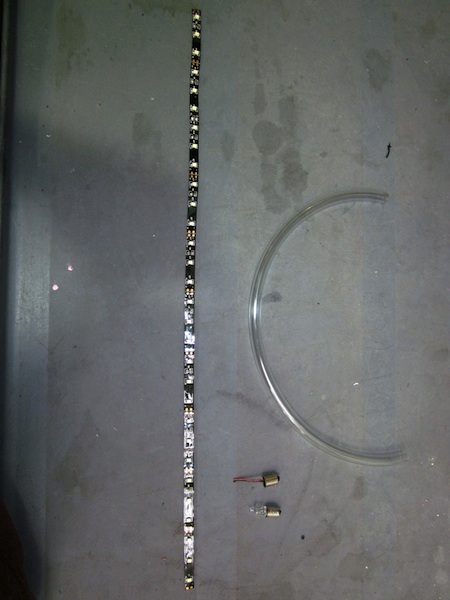

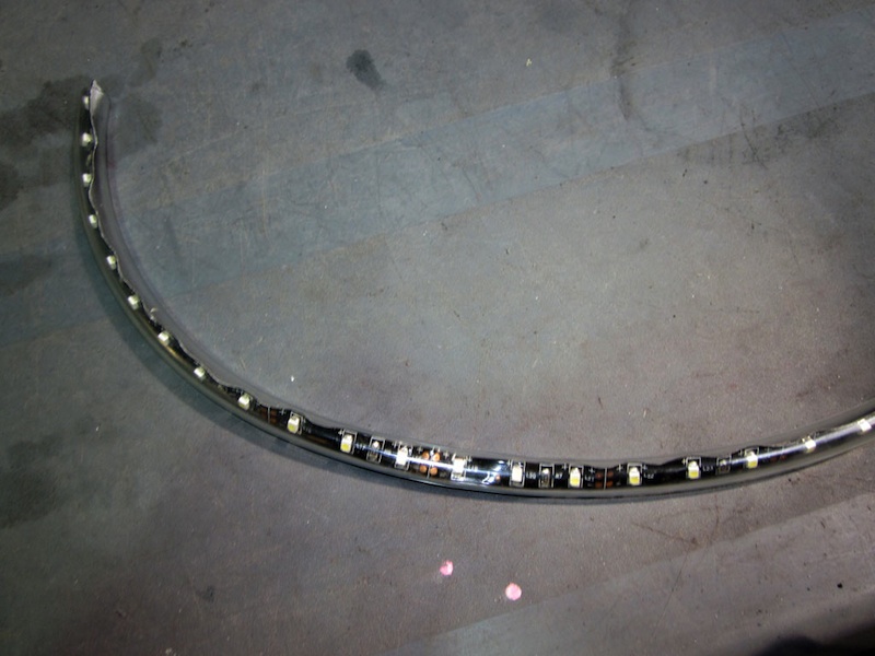

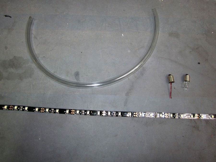

-Wow havent been in TS for some days and didn't know this mod was already discussed.
-No I didn't used Ikea I used another cold white leds,I also have Ikea but haven't test them I will like to install the ones with the little optics.
Here is how I made my installation,the transparent tubbing really helped and the adaptor connector also made a very clean installation I got them already built from Wurth.

Wow, that looks really good!

I really like how beight it is. Great job

Looks great.
And I absolutely love the color on your Scud. Gorgeous.
