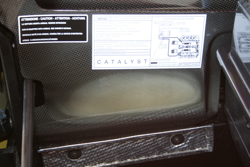

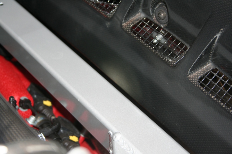

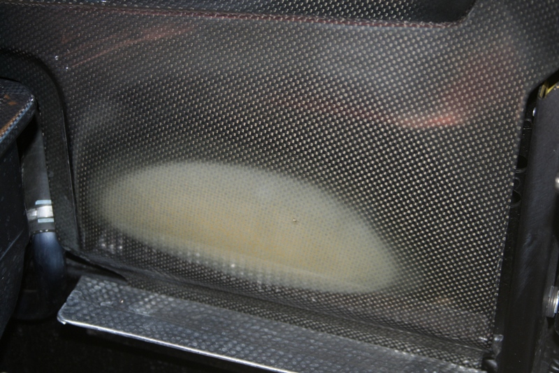

For owners of a Scuderia, there's a current campaign regarding the discoloration of the C/F in the engine compartment. I checked my car and sure enough there's major discoloration. I'm told the fix will be new c/f engine compartment panels and new heat shields. The current heat shields are very small and I'm told the new ones will be much larger and will be hand bent by the dealer techs to cover more of the c/f. As for the discoloration up in the middle of the engine compartment, it seems like they don't have a fix for that yet and will probably end up replacing the c/f again? I'm told by my dealer that I'll be the first one to have the c/f replaced. Love being the first...not. I've attached pictures of both sides so that other owners can see what it looks like. Hope this helps.

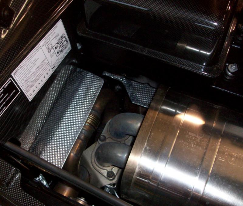

Here's a picture of someone who has already had the fix under the campaign with a new larger heat shield.
