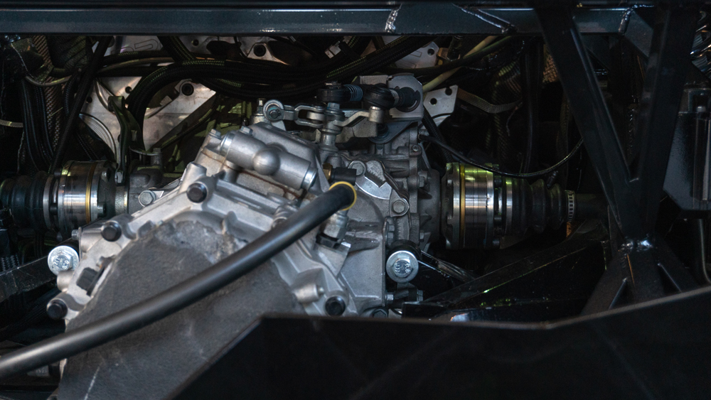

Steinbacher is no stranger to rebuilding wrecked cars. However, after his insane SEMA project from last year, a Datsun 240z essentially body swapped onto a BMW M5 chassis, he wanted to step his game up. It wasn’t good enough to just rebuild a Huracan. Instead, he opted for a manual transmission. To make this a reality, Steinbacher installed the manual transaxle assembly from a Lamborghini Gallardo. Of course, this wasn’t just a bolt-in type deal. A custom setup to run the assembly is necessary, as no manual Huracans exist. This means the shifter linkage, clutch pedal assembly, axles, and everything in between are custom.

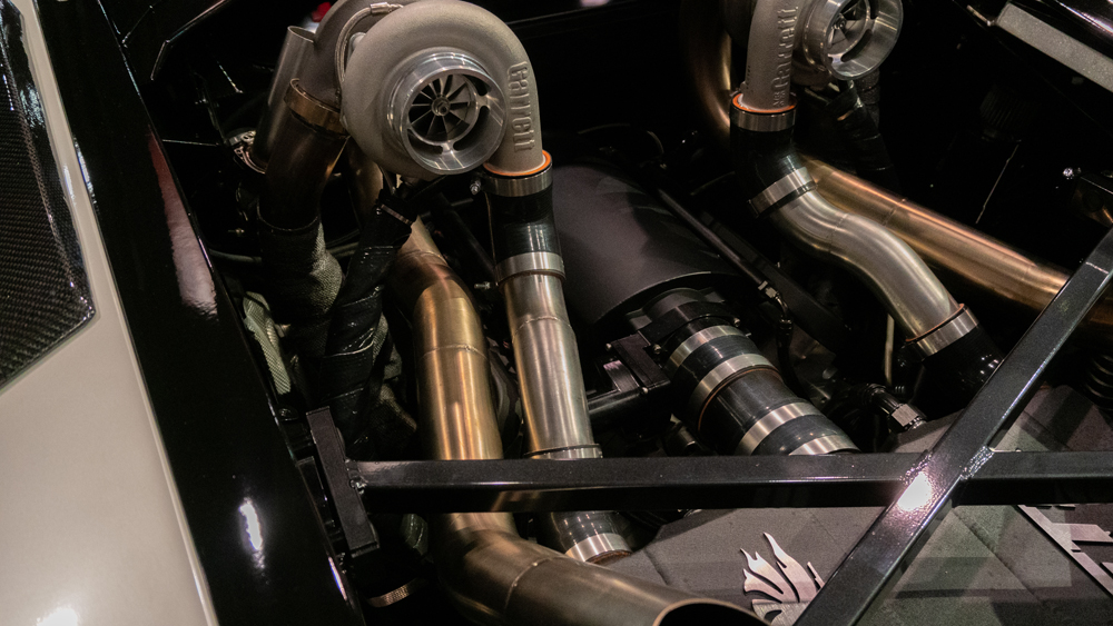

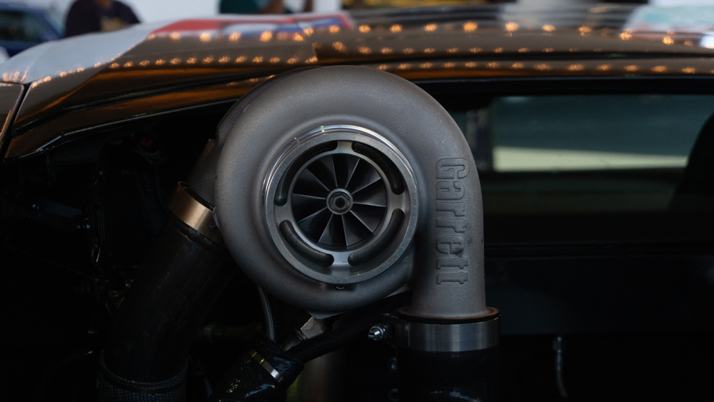

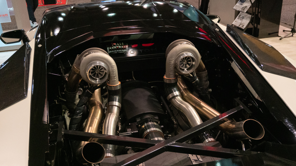

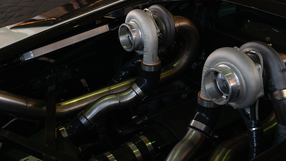

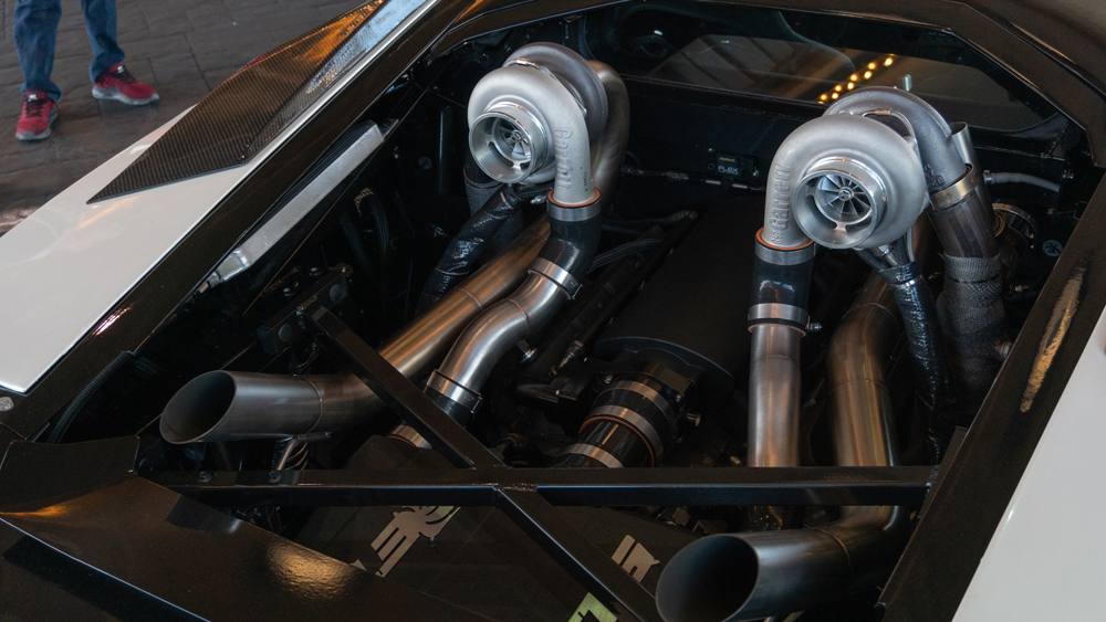

Twin Turbo Texas Speed 1,500 Horsepower LS Engine in Lamborghini Gallardo at SEMA 2019
This means, then, that merely bolting the beastly V10 up to the trans would be child’s play, right? Well, it’s not quite that simple, but Steinbacher again took a never before seen direction. Instead of the screaming Italian ten-cylinder, a twin-turbocharged Texas Speed LS engine powers this monster. It is said to make 1,500 wheel horsepower. That’s more than enough to give you the ride of your life.

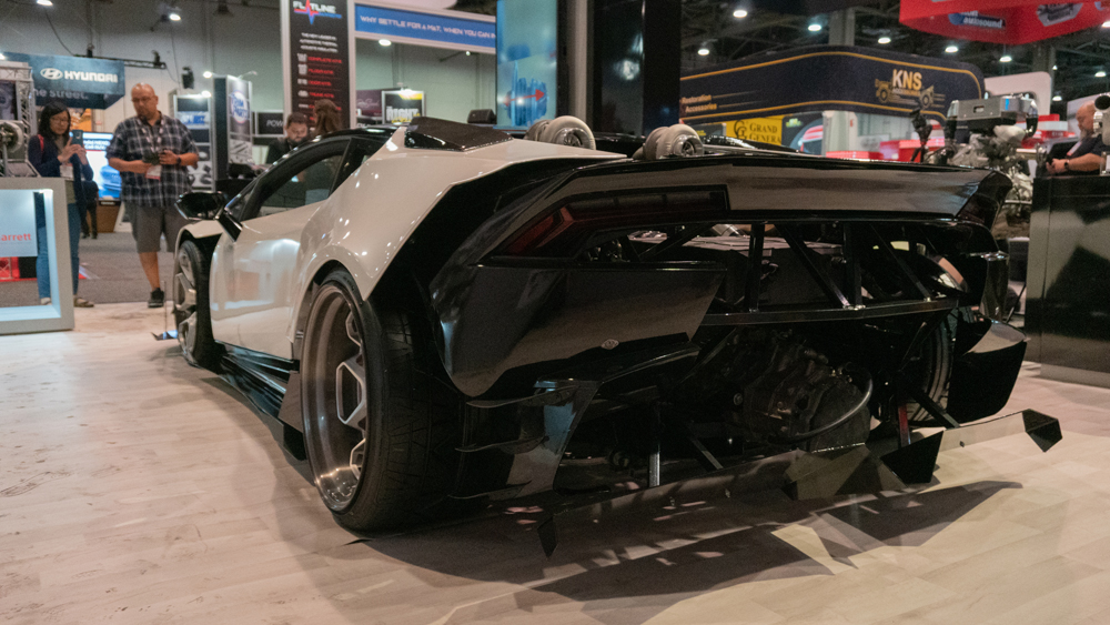

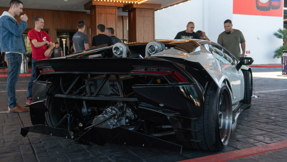

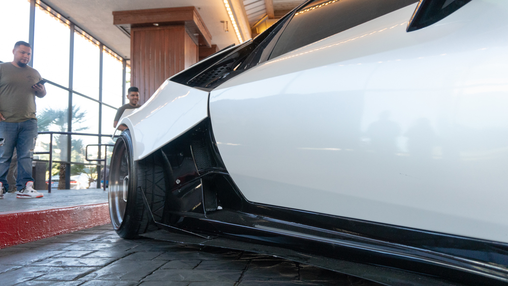

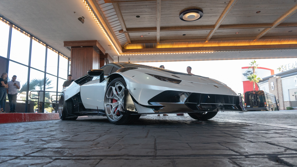

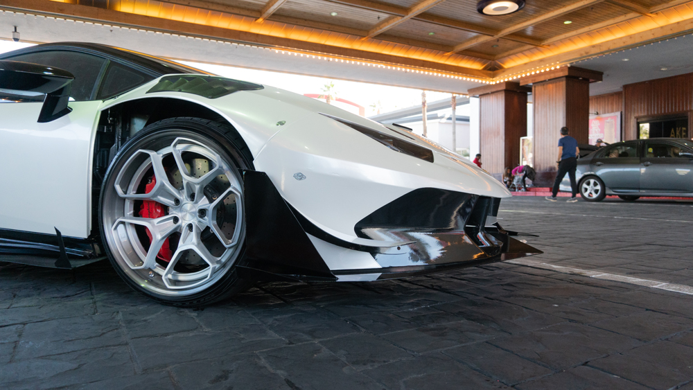

This Huracan is far from stock in terms of its body parts. Many of the parts you see are handcrafted by Steinbacher and crew using Carbon Fiber vacuum bagging techniques. Additionally, most of the front end is from an actual Lamborghini Huracan Super Trofeo race car. There is virtually no part of this vehicle that hasn’t been modified.
Custom Widebody twin-turbo Lamobrghini Huracan with manual transmission and LS swap at SEMA 2019

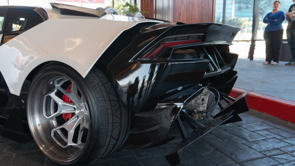

To accommodate the massively wide Rotiform wheels, the B is For Build crew designed and built this carbon fiber widebody rear-end from scratch. There is not another one like it in the world. It’s pretty remarkable to look at. While some have criticized the panel fitment and specific design elements, it’s worth remembering that this entire build was done on a shoestring timeframe. Even without considering that, pictures just don’t quite do it justice. Seeing this car in person would change anyone’s mind.
