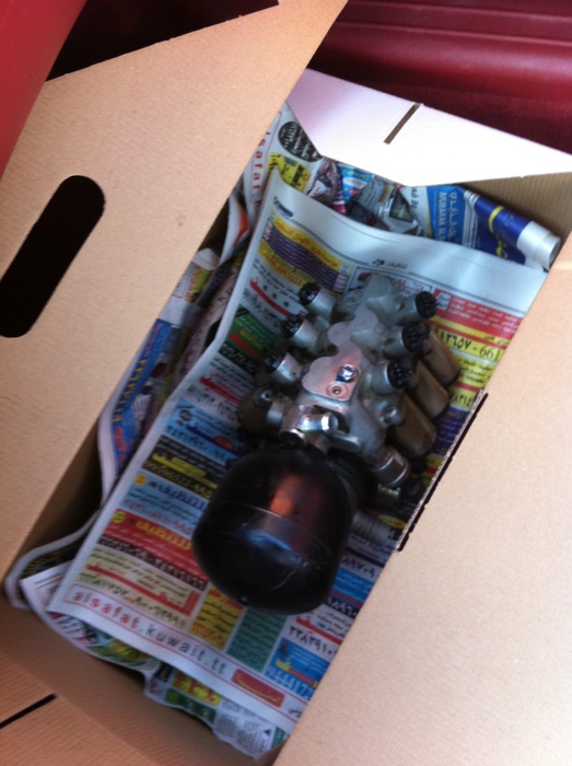

car is drivable again but, of course there is always a but, on the original 355 pump. which means that the mech said the car STILL flashes sometimes. mind you, this is on other (not brand new) solenoids
so the power unit i bought (pic in box in my previous post) seems to have taken care of the butchering that the independent shop did with my original unit's solenoid valves
i will now see if those 355 motor pumps can be sourced independently, 99.9% chance is that it is a huge NO, but whatever it is worth a shot
otherwise, i would still much prefer of course to install the Hill Engineering adapter and a 360 pump
i am happy, but a bit underwhelmed when i got word that it is "drivable", i think i will need seat time to boost my energy again

the hurt of missing the 355 has become bit more bearable although its superiority has indeed been confirmed. this led me to think with a straight head. the original indy shop owner spoke with me telling me to bring the car back to him since all doors are now closed and he is confident they can get it back to its original state: in other words, it would shift with the original power unit with my original pump and everything as it was. with a new clutch, sensor, bearing, if the flashing/blinking of the gear selection continues, i seriously have no idea what else i can do other than buy a new power unit, suck it up, and stfu
as it is now, at my friends' shop, the car is back on my original setup (original 355 power unit with 355 pump) as i have returned the used power unit (in post #71) i have gotten from another 355 owner who was gracious to return the 1.8k collateral i deposited.
my car now engages Reverse. this is what tells me the car could be "synced" as there is clear communication between the tcu, unit, and mechanical parts.
i will take it to the shop on saturday and will keep you guys posted if anything "interesting" happens.
at this point, all i want is for the car to drive as it was (even with its original nuisance of gear selection blinking when it heats up)
i will be so happy to park it right in the middle of the driveway and will have a smile on my face seeing it sporting the challenge grill even if i do not take it out except for times after 11.30pm on weekdays
ps: @Mietek i found a brand new power unit for the 355 for what was $11k but is now $11.6k this is from eurospares.co.uk, i can see myself spending that much on the 355 but not just yet. i soooo cannot afford it right now and even if i did i refuse to be so selfish in such a short time tbh!
