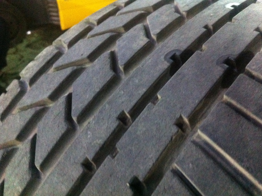

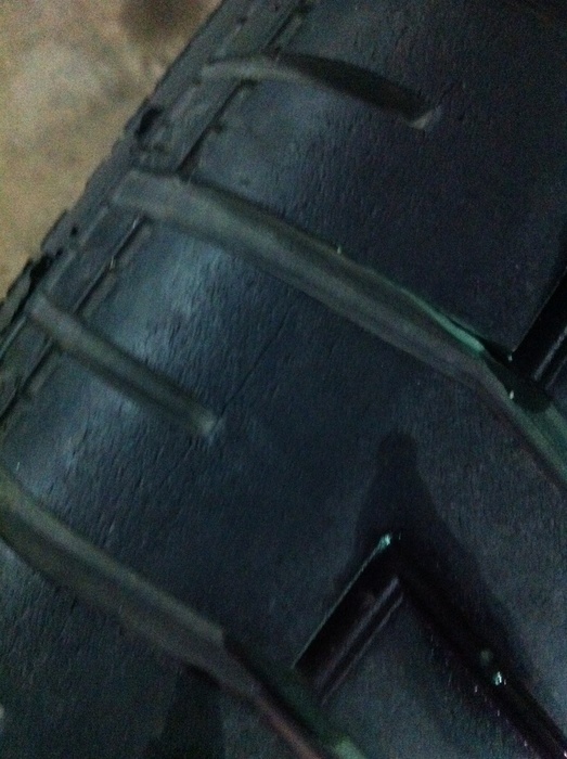

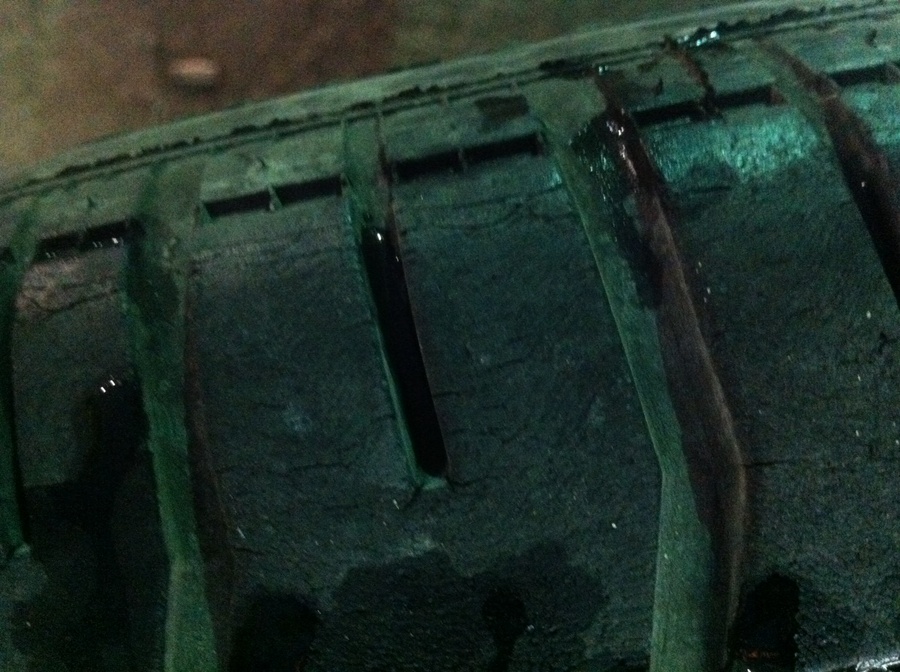

got the car yesterday, fitted grill and took apart the ac vents. i already cleaned them and they look great from 1 meter away, but up close still have the goowy touch so i kept them at the shop and will look at them on saturday. whatever i do to them will be done to the centre console switches so it's kind of a big deal to me. tires not the best in the world, but they will have to do for now. or a long while lol.
