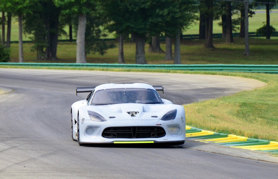

The 2013 Viper GTS-R takes to the track!
Enjoy some behind-the-scenes driving of the 2013 Viper GTS-R at Virginia International Raceway thanks to drivesrt.com!

Changes to the production 2013 Viper GTS enhance every part of the car. The chassis is the same in the GTS-R and the road-going Viper, in compliance with ALMS rules. The wheelbase of the GTS-R remains 99 inches as is it on the street-legal version of the Viper. The basic car looks the same for the most part, with changes to aerodynamics. Here are the major differences between the GTS and the GTS-R.
  • Engine size is reduced to 8 Liters by changing cylinder bore and stroke
  • Maximum engine size is 5.5 Liters, but the governing bodies allowed the 8-liter Viper V-10, requiring a restrictor in the engine’s intake tract
  • A new intake manifold is created to work with the restrictor
  • The engine will run on E-85 — 85% ethanol
  • Transmission is moved to the rear of the car and will be sourced from Xtrac
  • Dry weight of the car is reduced, with rules defining minimum weight as 1245 Kilos, 2740 lbs. dry
  • A new roll cage is incorporated
  • Bodywork is carbon fiber composite, with aerodynamic changes (body sides are lowered and front splitter/rear airfoil incorporated)
  • New front and rear suspension systems designed to work with Michelin racing slicks
  • Front and rear track increased
  • Car has a climate-controlled cockpit, as required by the rules to keep the driver cool
