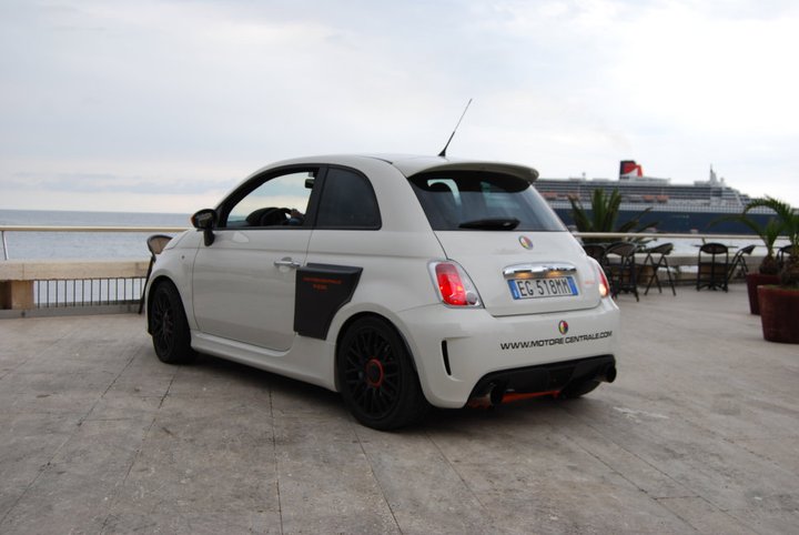

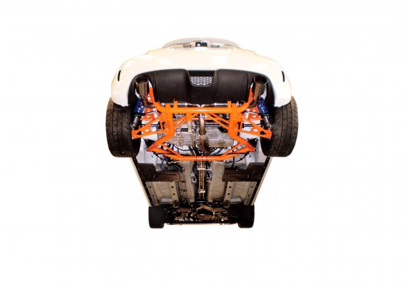

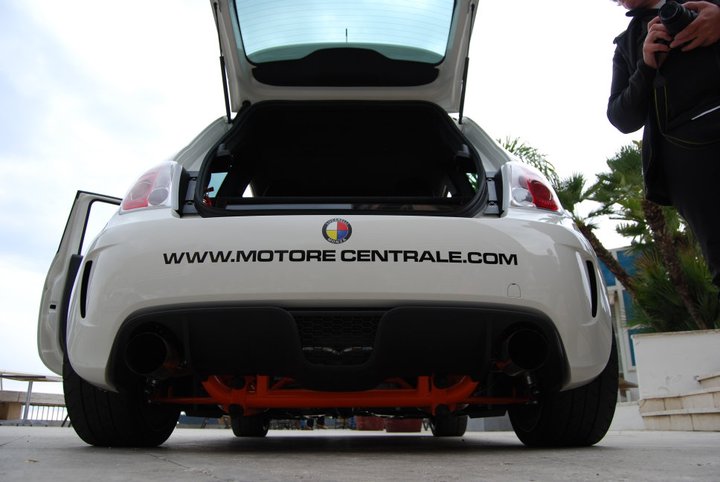

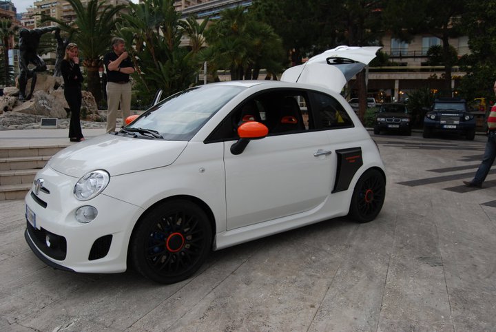

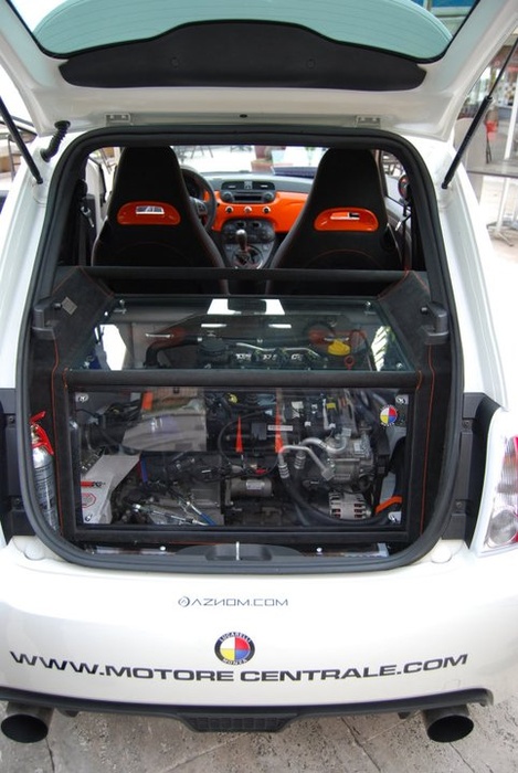

During the upcoming Top Marques Monaco (April 14-17) Aznom Lucarelli and the company will present the Monza-engined R230, the original "fun car" with features comparable to driving cars far more noble ed'elite. This is because the central engine derived from a simple Abarth 500, modified in its primary components by engineer Lucarelli is pulling back, the rear suspension geometry earns a double wishbone and the four-cylinder engine is transferred to the central part the car body, with the sacrifice of the rear seats. For this reason it was created an extra frame, engine and transmission that supports and helps to strengthen the central body.

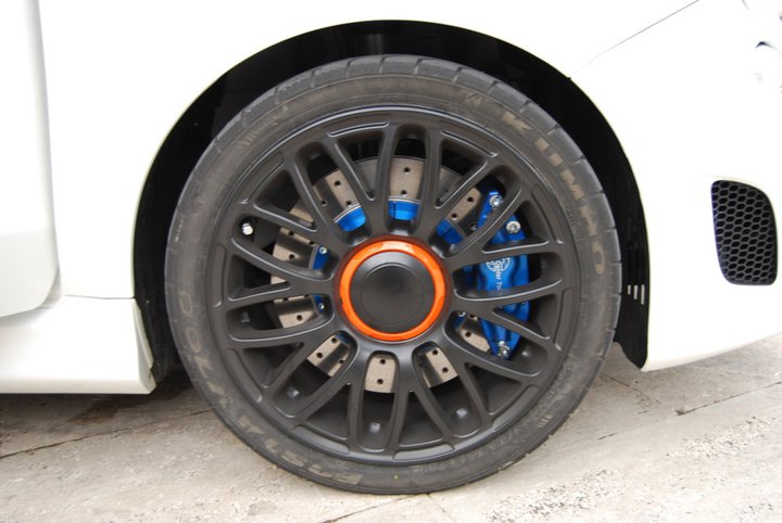

The central engine and there is new attacks for the suspension, Bilstein shock absorbers and adjustable Khum semi-racing tires. Thickness also changes for the 1.4, which in this version delivers 230 hp and 330 Nm The conversion is completed with the use of a braking system with discs 335 mm front, 305 rear and 4-piston calipers with the tank and the battery pack positioned at the front in order to optimize the weight distribution. The motor unit 230 will also be offered in version Runway, homologated for road use, however, and with 280 hp engine, fully adjustable suspension and shocks, full roll cage, locking differential, telemetry system and a weight of 900 pounds. The treatment of interior and bodywork is maintained by Aznom according to the instructions of the 30 clients that feed into the annual production.
