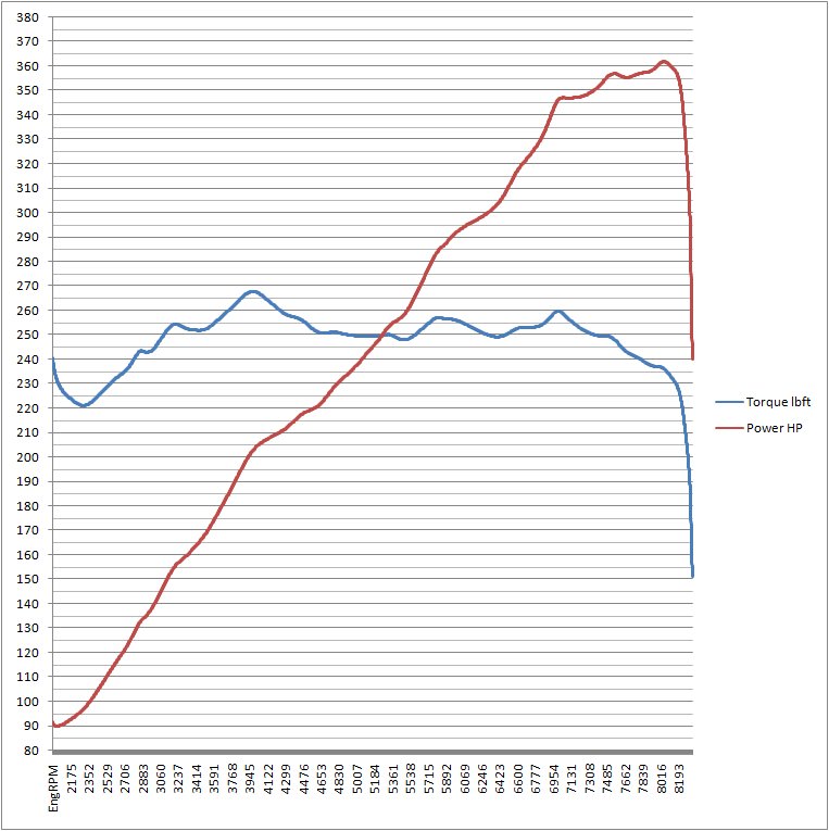

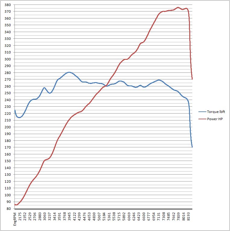

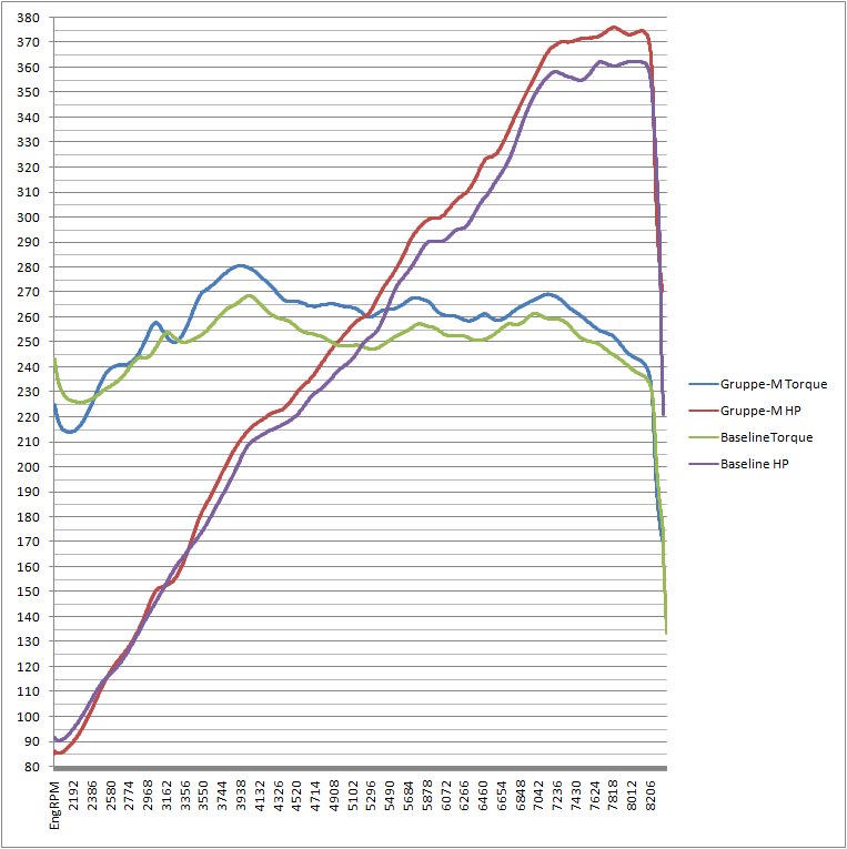

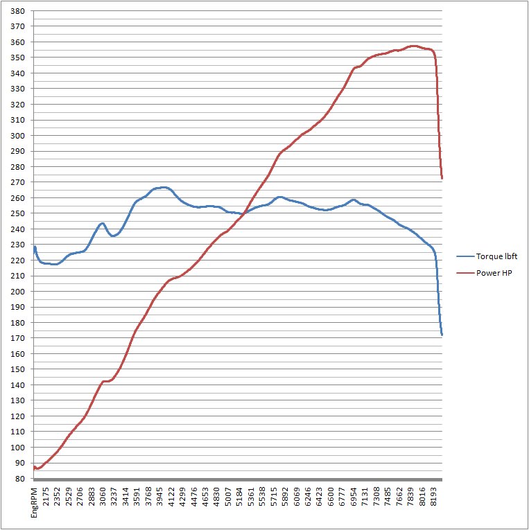

"Here's the dyno results for 2008 BMW M3 and Gruppe-M Cold Air Intake on 91 octane gas. The baseline is the same motor with Evo Sport Power Pulley.
The Dyno: Dynapack 4000 Chassis Dyno (wheel hub attachment).
RPM Range: 2000-8400
Max Torque: 280.7 ft/lbs @ @ 3933 RPM (Run-1)
Max HP: 376.3 @ 7830 RPM (Run-1) - +10hp Gain
Other graphs: Run-1, Run-2, Run-3

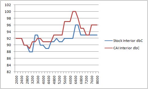

SPL vs. RPM (Stock vs. Gruppe-M CAI)

To compare dyno charts using the Dynapack viewer:
* Follow all of the instructions above to load the dynapack data file.
* Download the Evo Sport baseline, or 91 Octane baseline data file. Save it in the same location as above.
* Click Display->Status & Relative Graphs (or press the 'Home' key on your keyboard)
* Press <F8> (Folders). I don't think the function keys actually work here, so place the mouse over the <F8> key on the screen and left click.
* Press the "Import Files" button.
* Locate the file you downloaded and saved on your computer. Highlight it, and click "Add" then "OK"
* Select the "Vehicle Folder" on the left of your screen where you just imported the dyno results. On my system, it was in my TEMP directory, so the folder name is "TEMP"
* Double Click on "PencilGeekDyno-2008-08-16, Power Pulley" or "PencilGeekDyno-2008-08-16, 91 Octane Baseline." When the "Load Data" dialog box is displayed, select "Comparison"
* When promted to overwrite the current vehicle setup, select "NO"
* Continue following the instructions above for viewing the dyno data.
