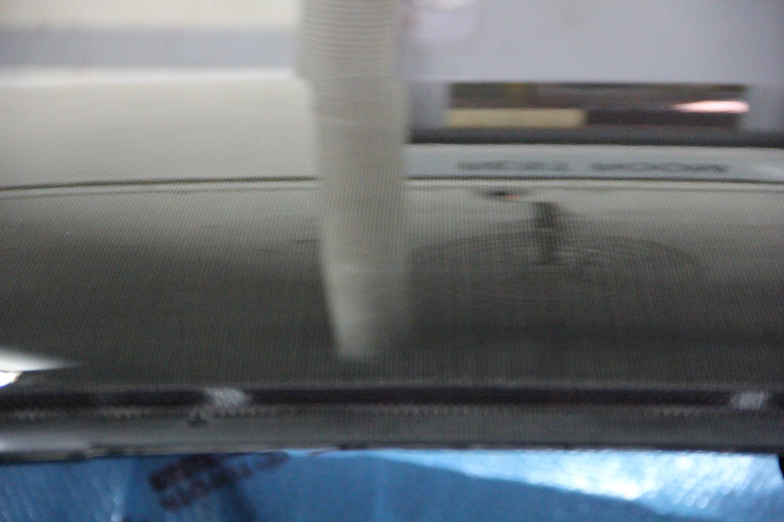

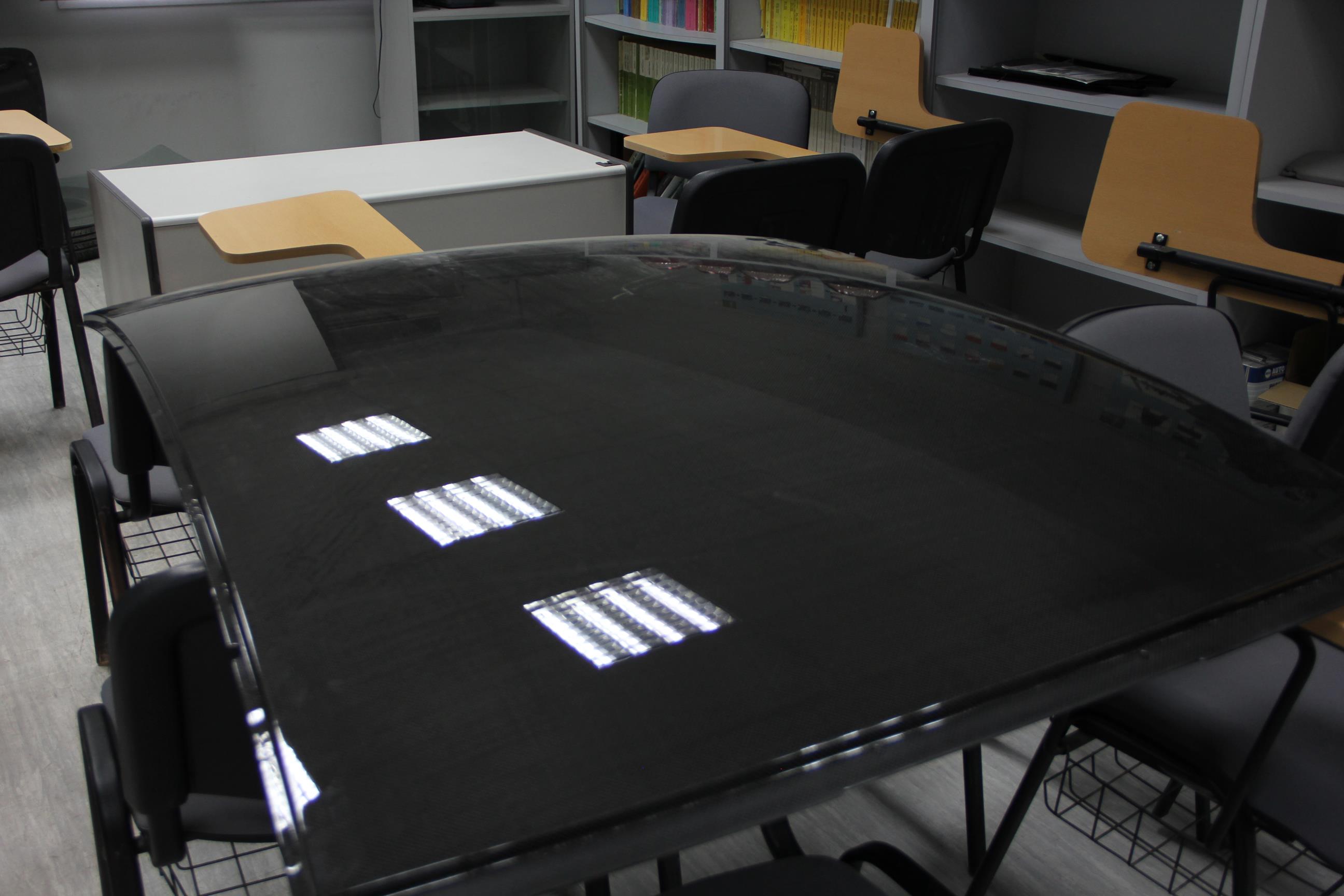

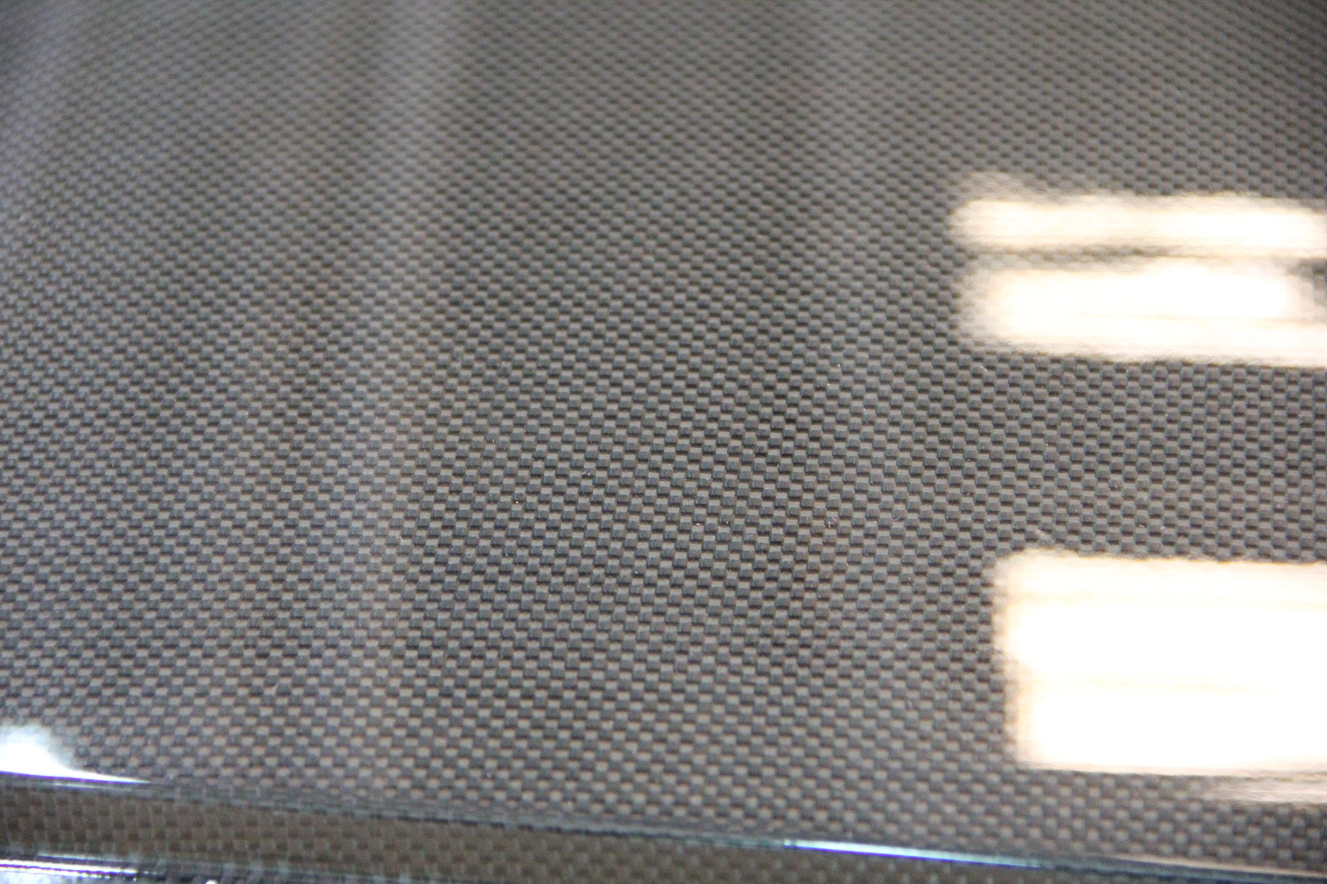

I got a wonderful gift from a good friend and member on here, an OEM CSL roof. He had it lying around at home since last year but didn't get the chance to install it. We came to an agreement and he dropped the roof off at my shop a few weeks ago.
I set about ordering the adhesive, applicator gun and front and rear window seals. Everything arrived in a week but the adhesive took 5 weeks to get here. Thanks to member disapr for the advice on which glue and gun to get.
Some pics.....

Dropping the car off at ekanooracing on Saturday for the install. Thanks so much to ekanoo/brn996tt and staff for the support.
I'll keep the thread updated with as many pics i can during the install.

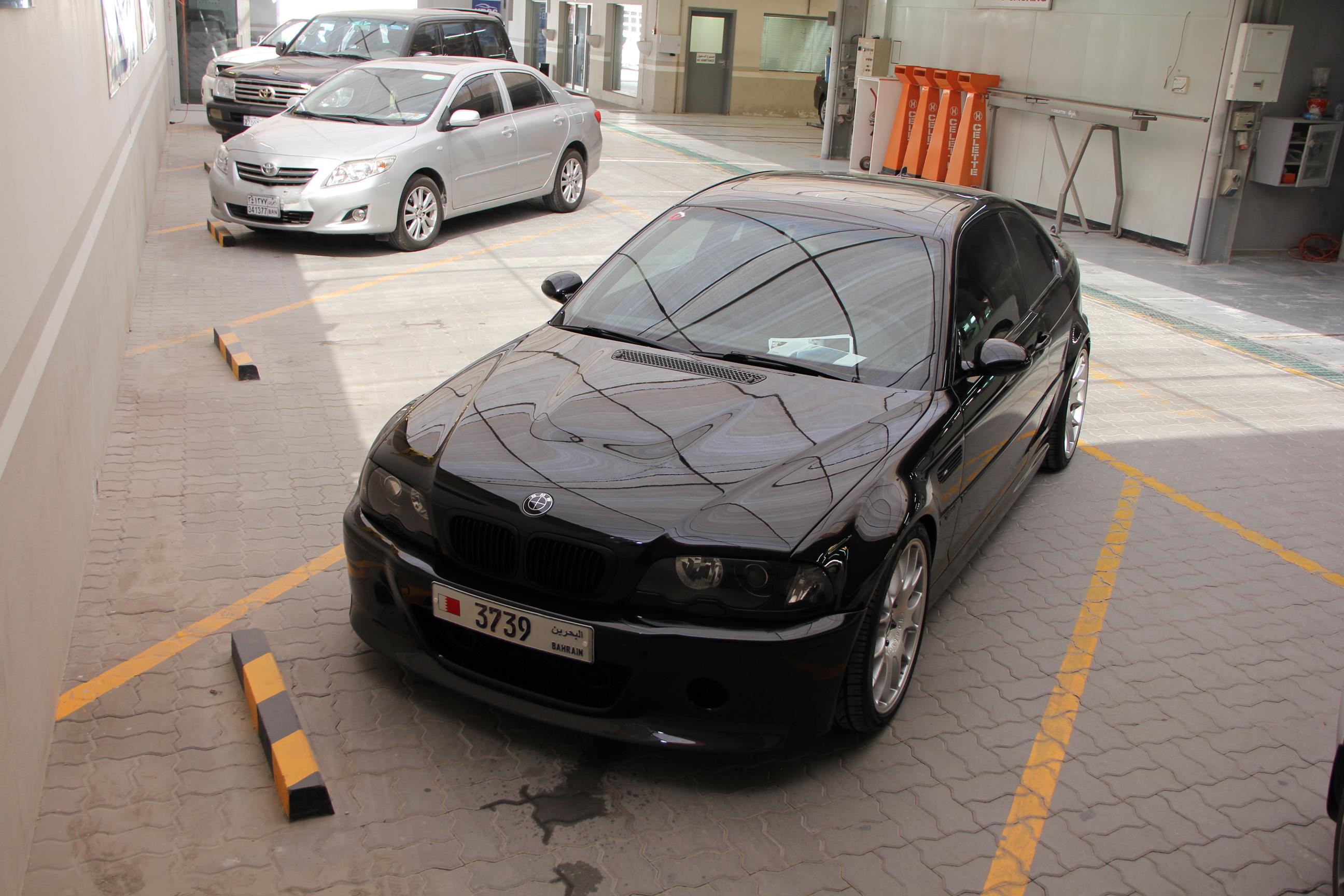

Dropped Darth Vader off at ekanoo racing body shop today as scheduled.....
More updates to come as work starts tomorrow.....

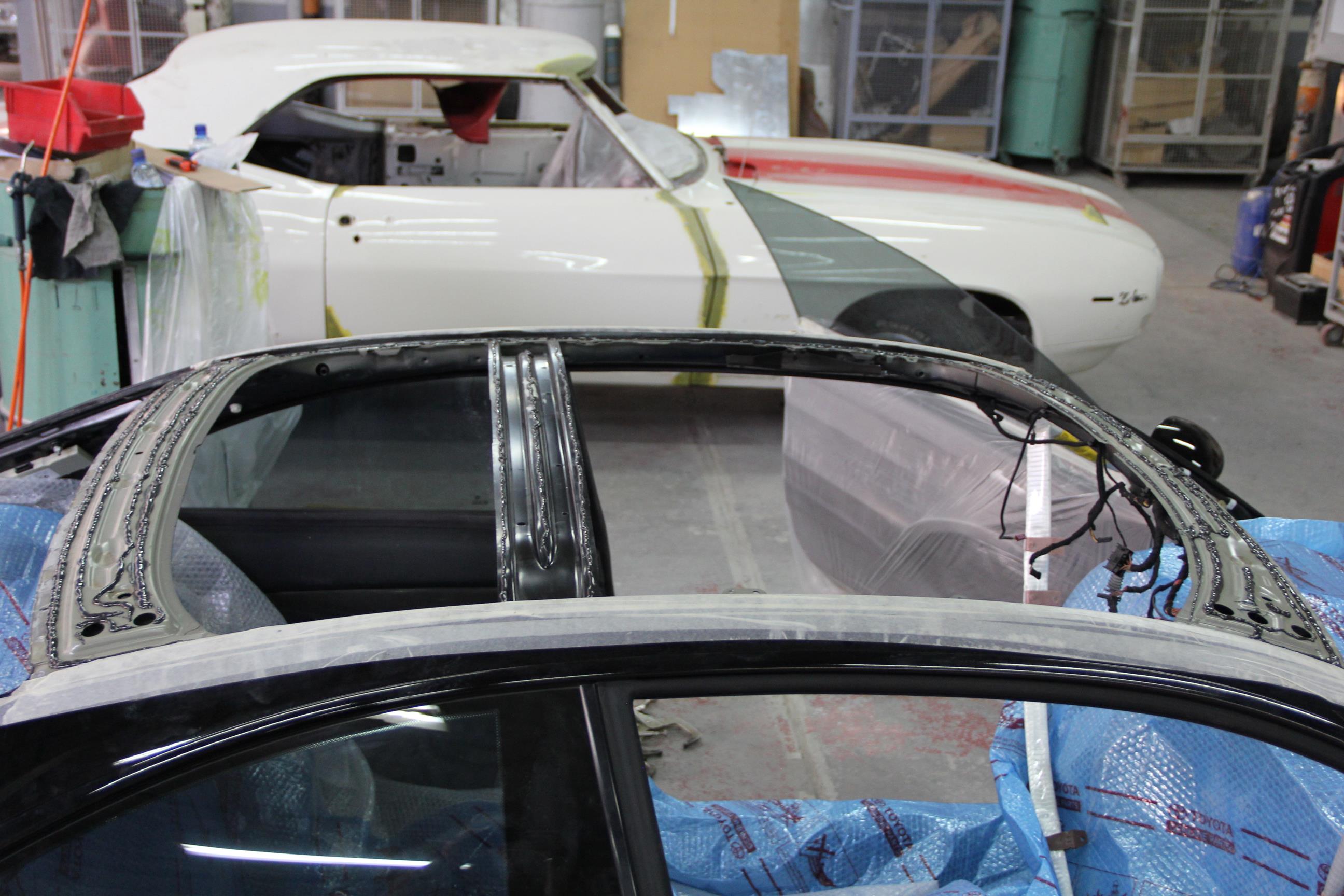

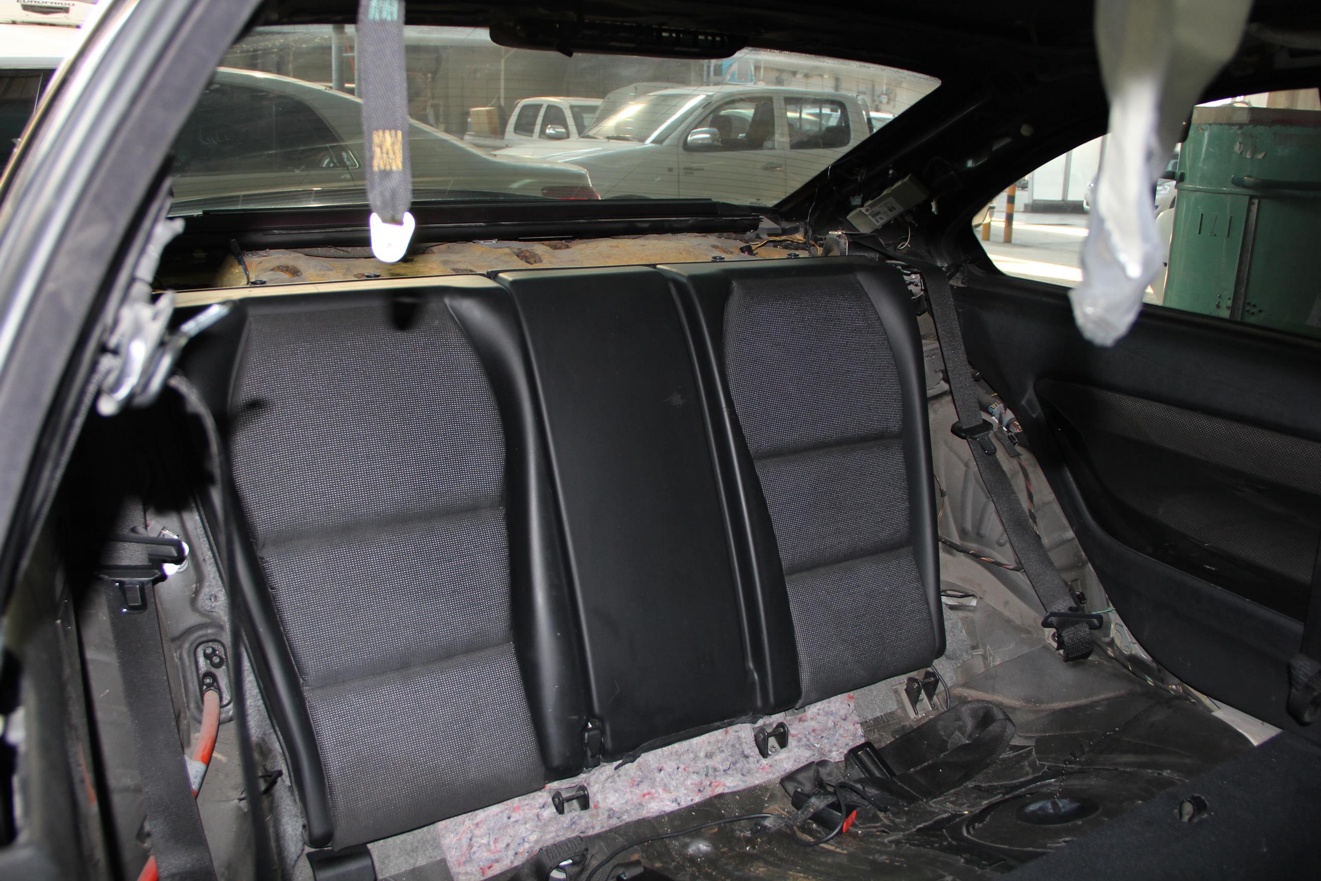

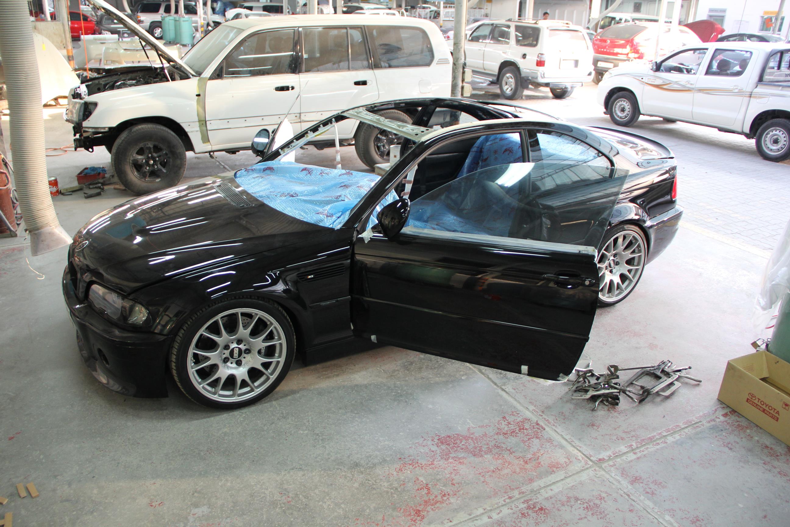

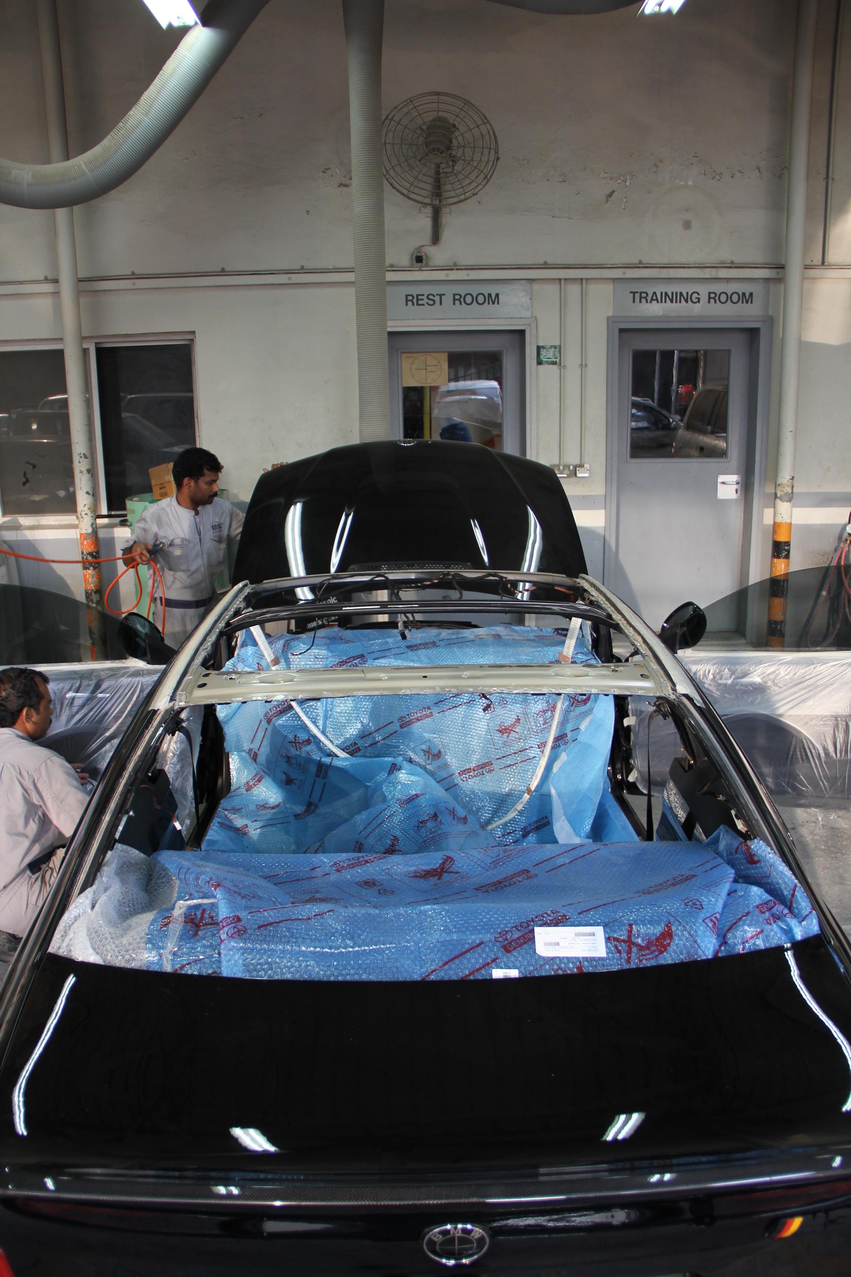

So here are pics from today with the interior removed and ready to start drilling and grinding away spot welds etc.
This is in order to remove the roof. I have been told from tomorrow they will not be pausing for pics So i'll have to make do with any pics I can take when i get a chance to visit the garage.
more updates to come tomorrow.

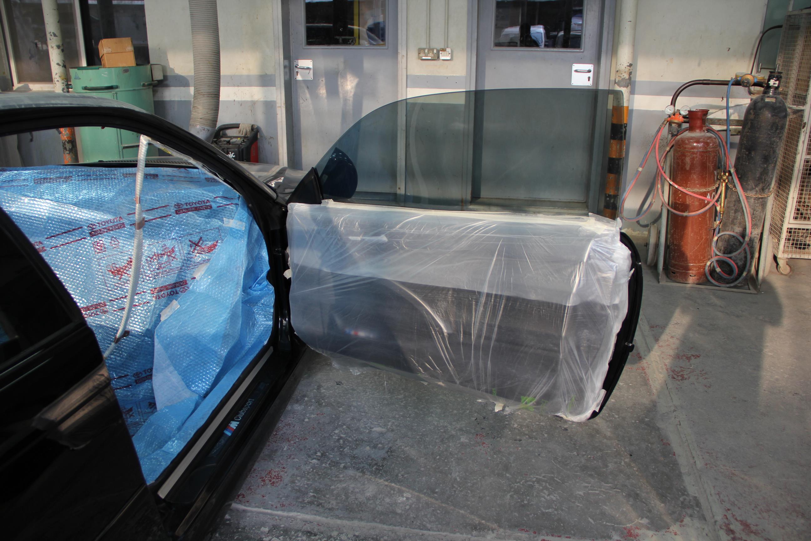

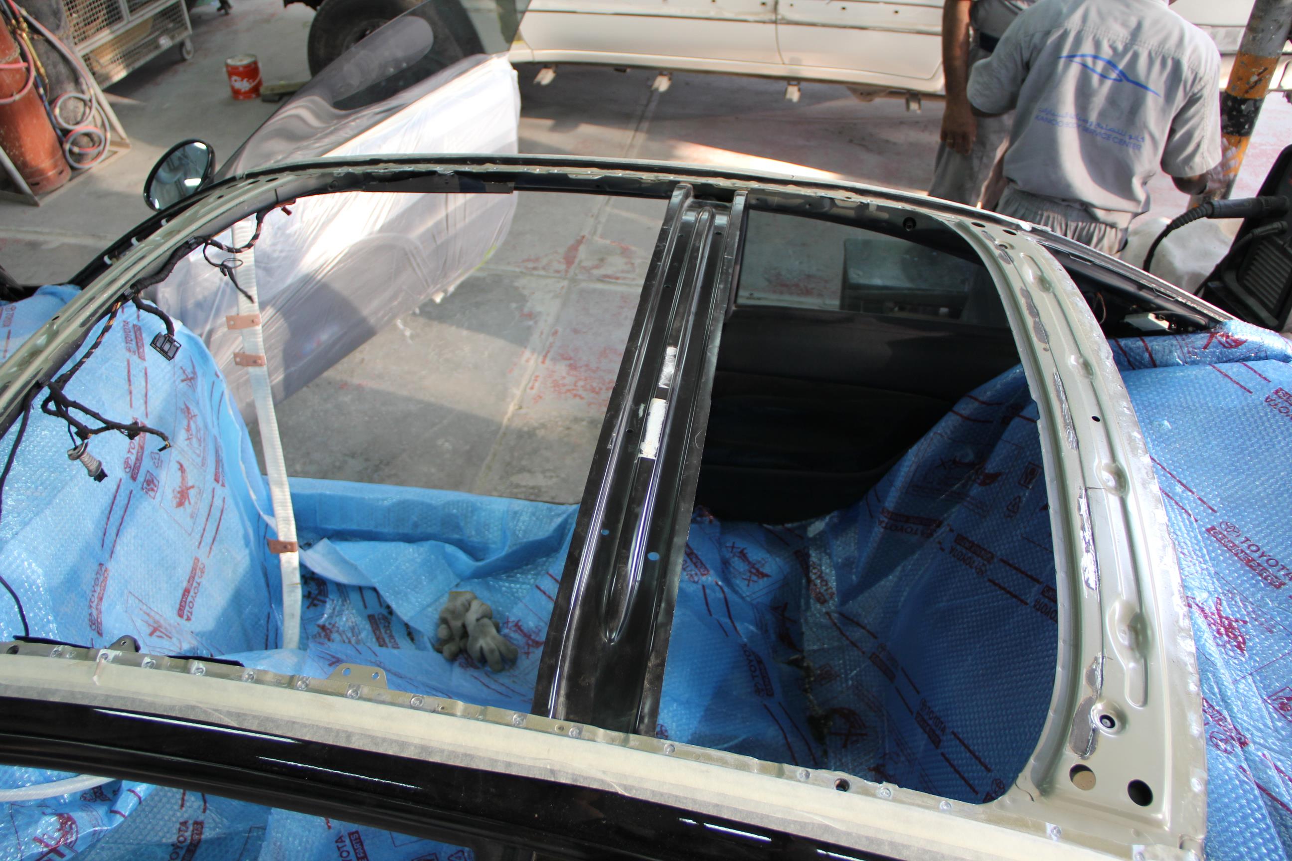

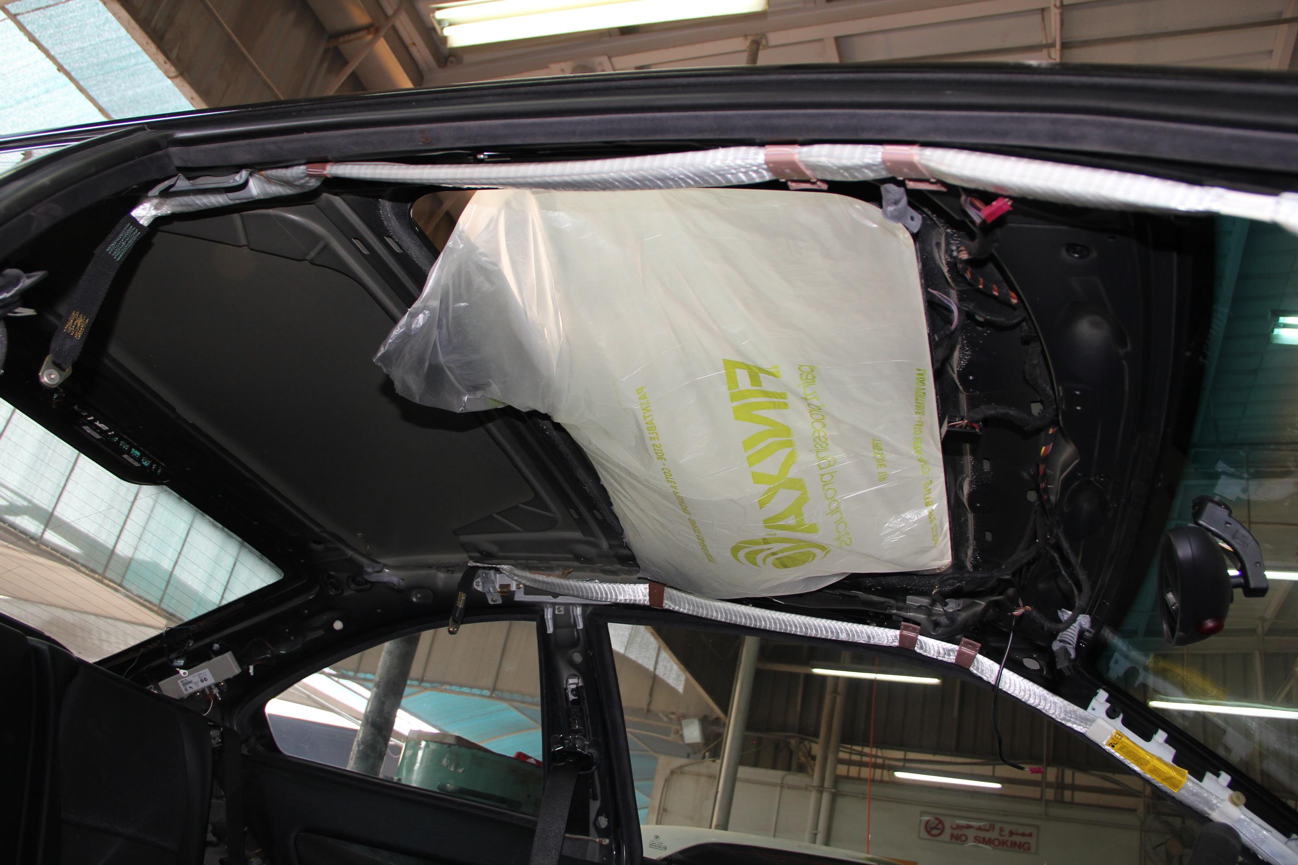

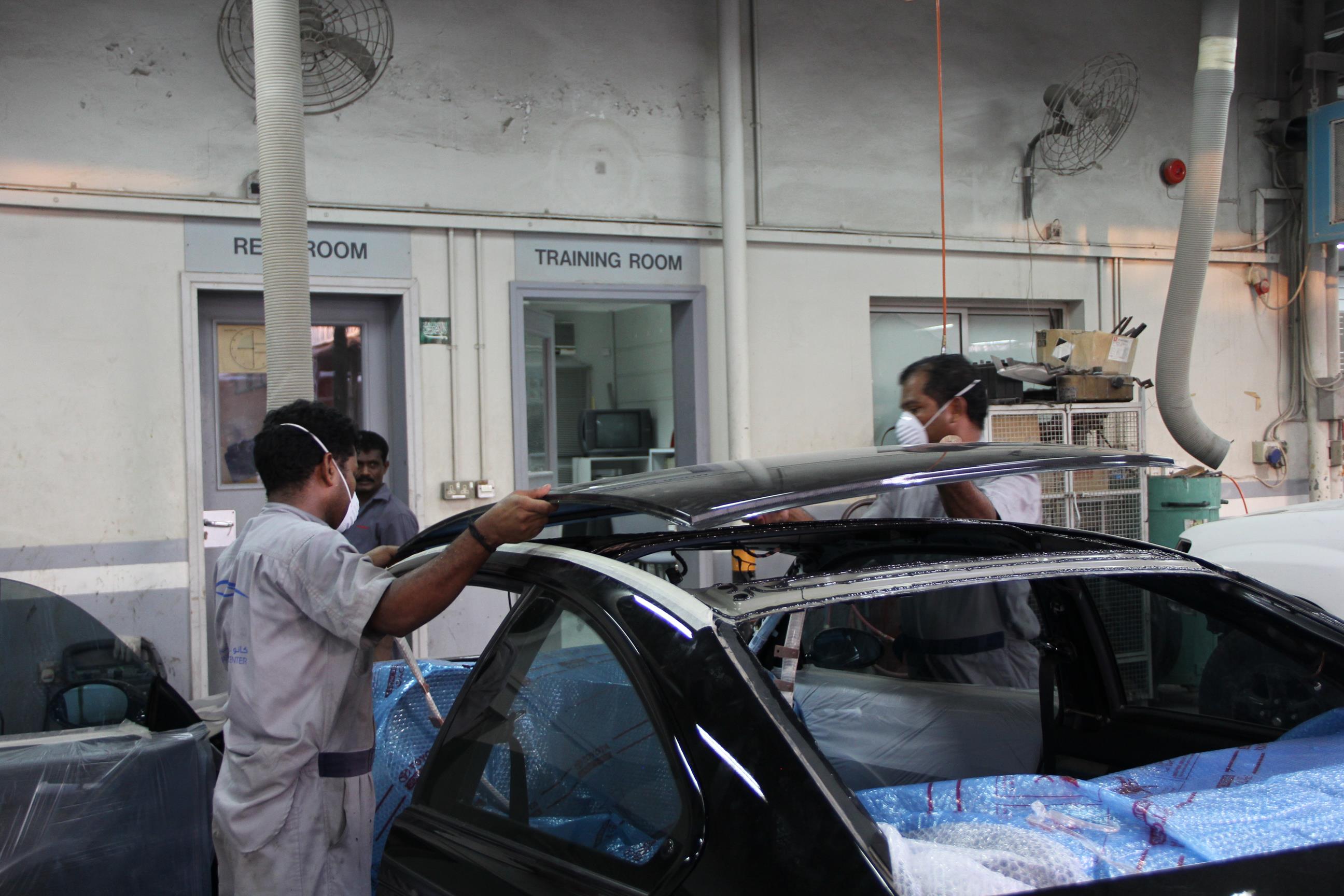

UPDATE:

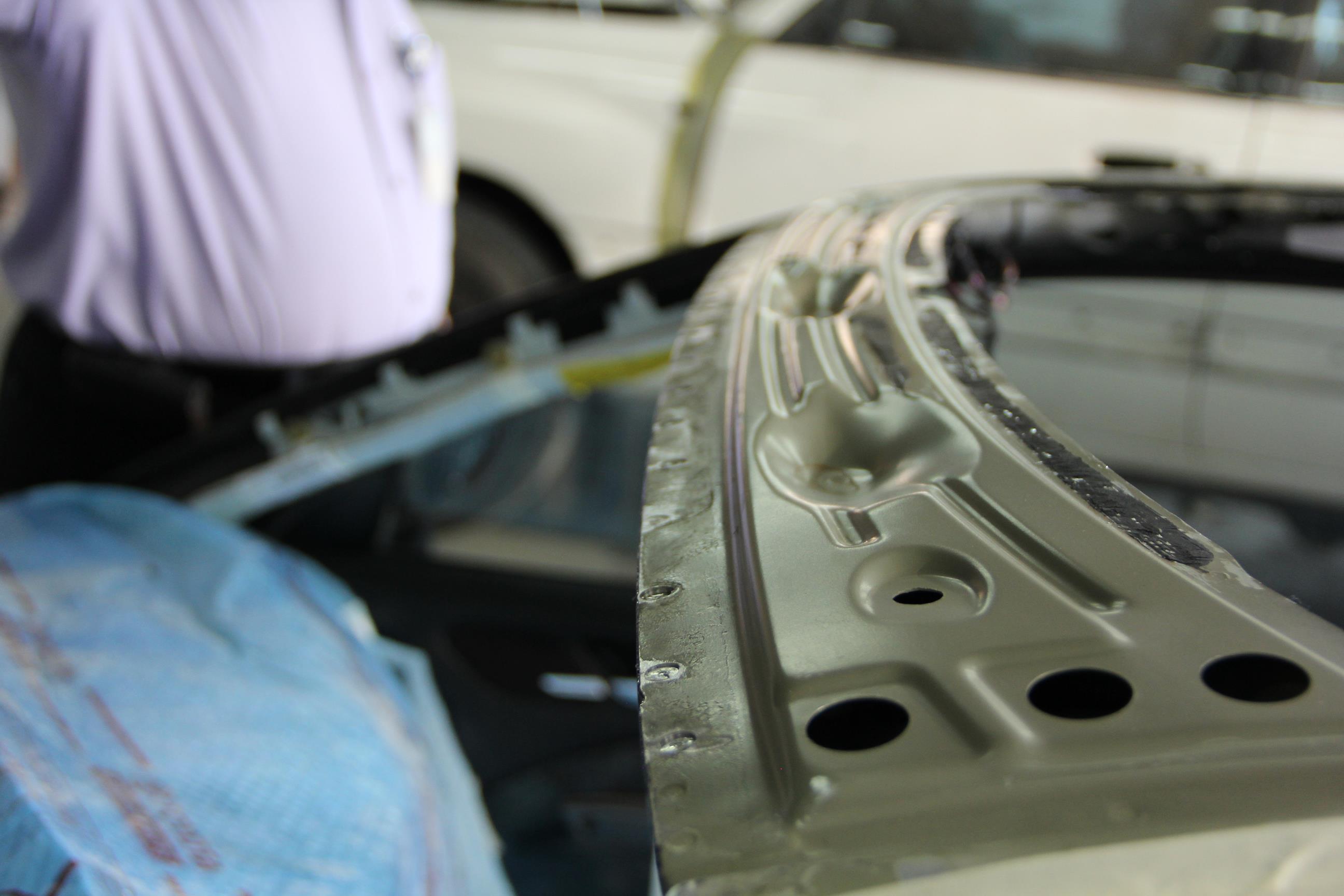

OEM Sun Roof panel is off......

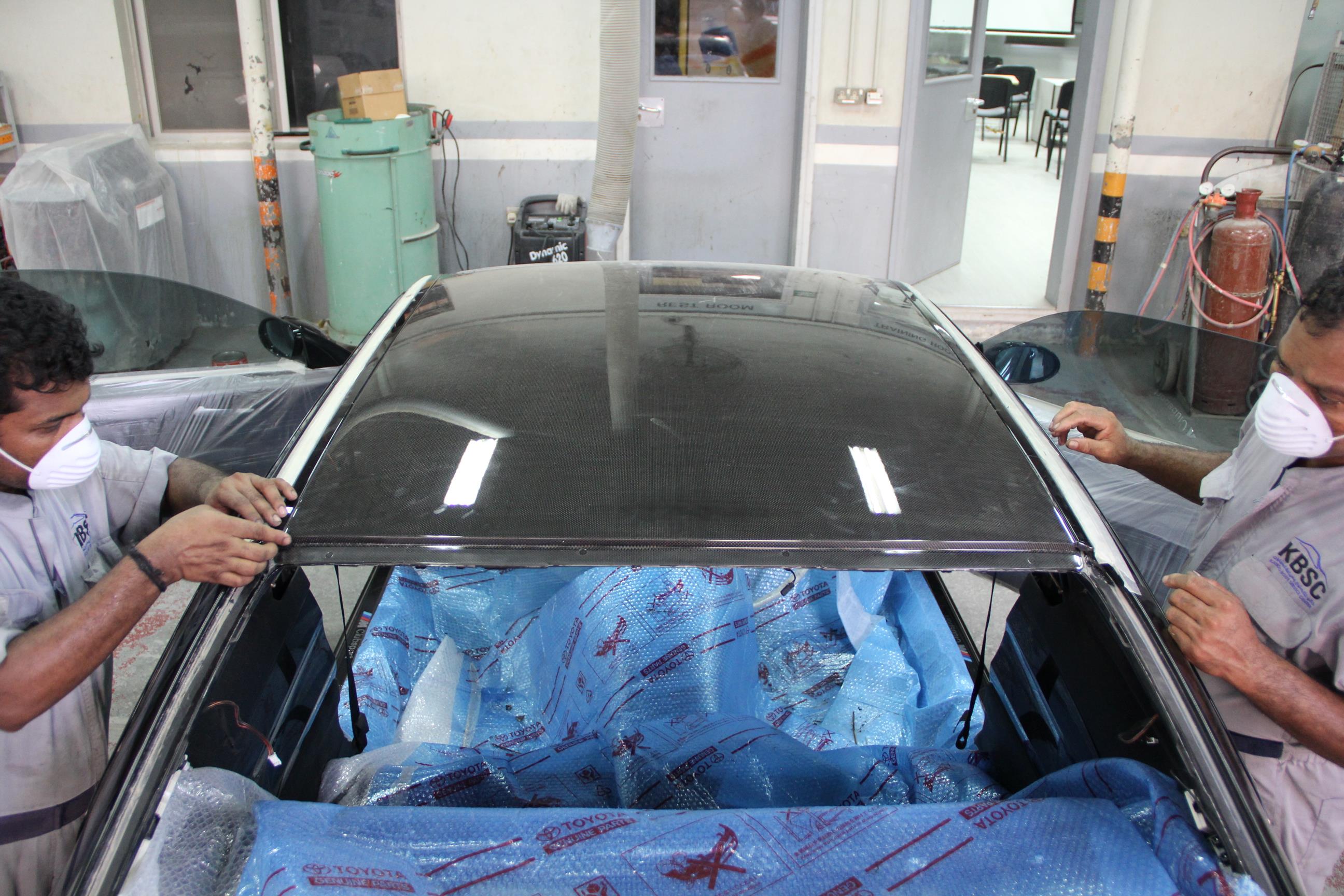

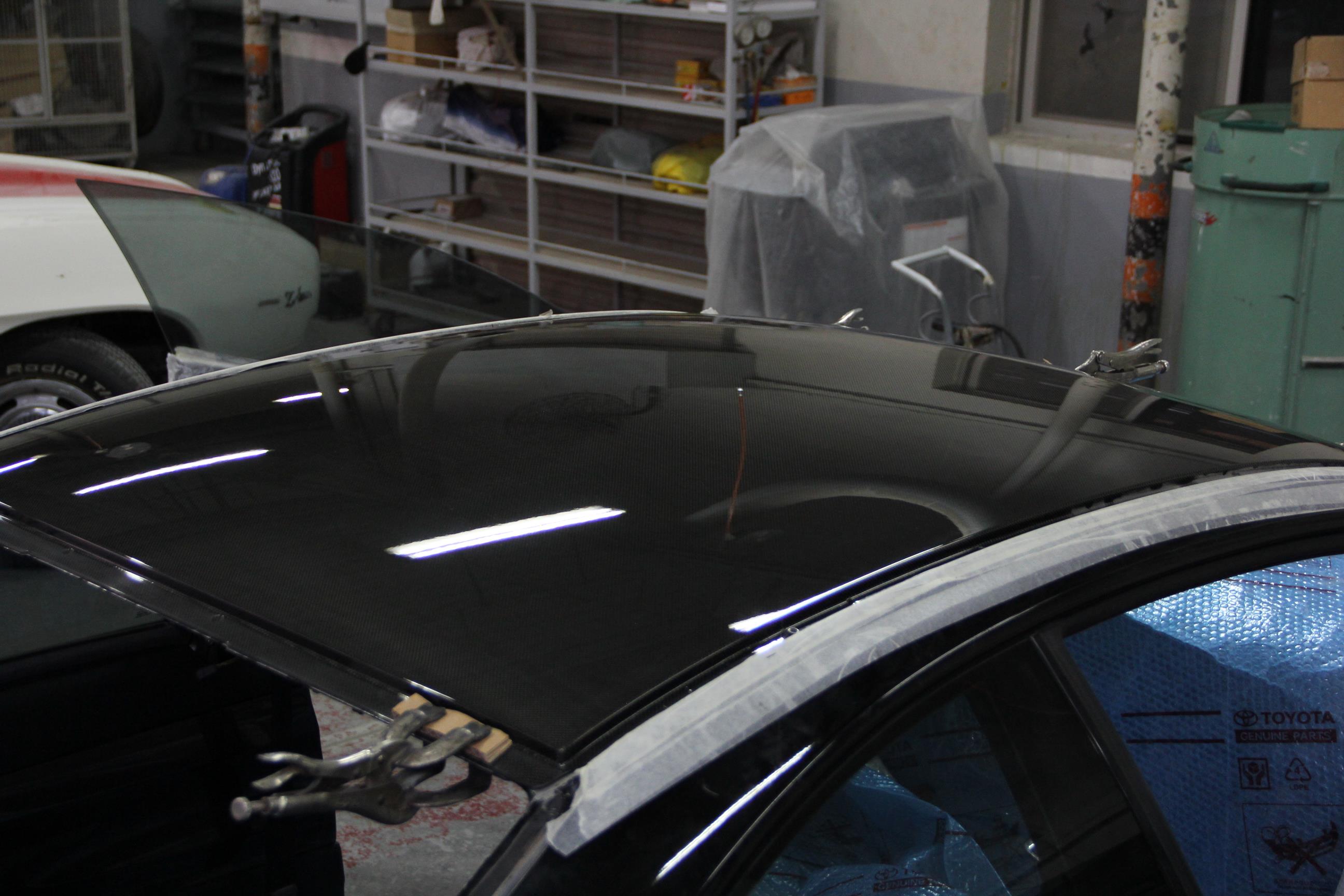

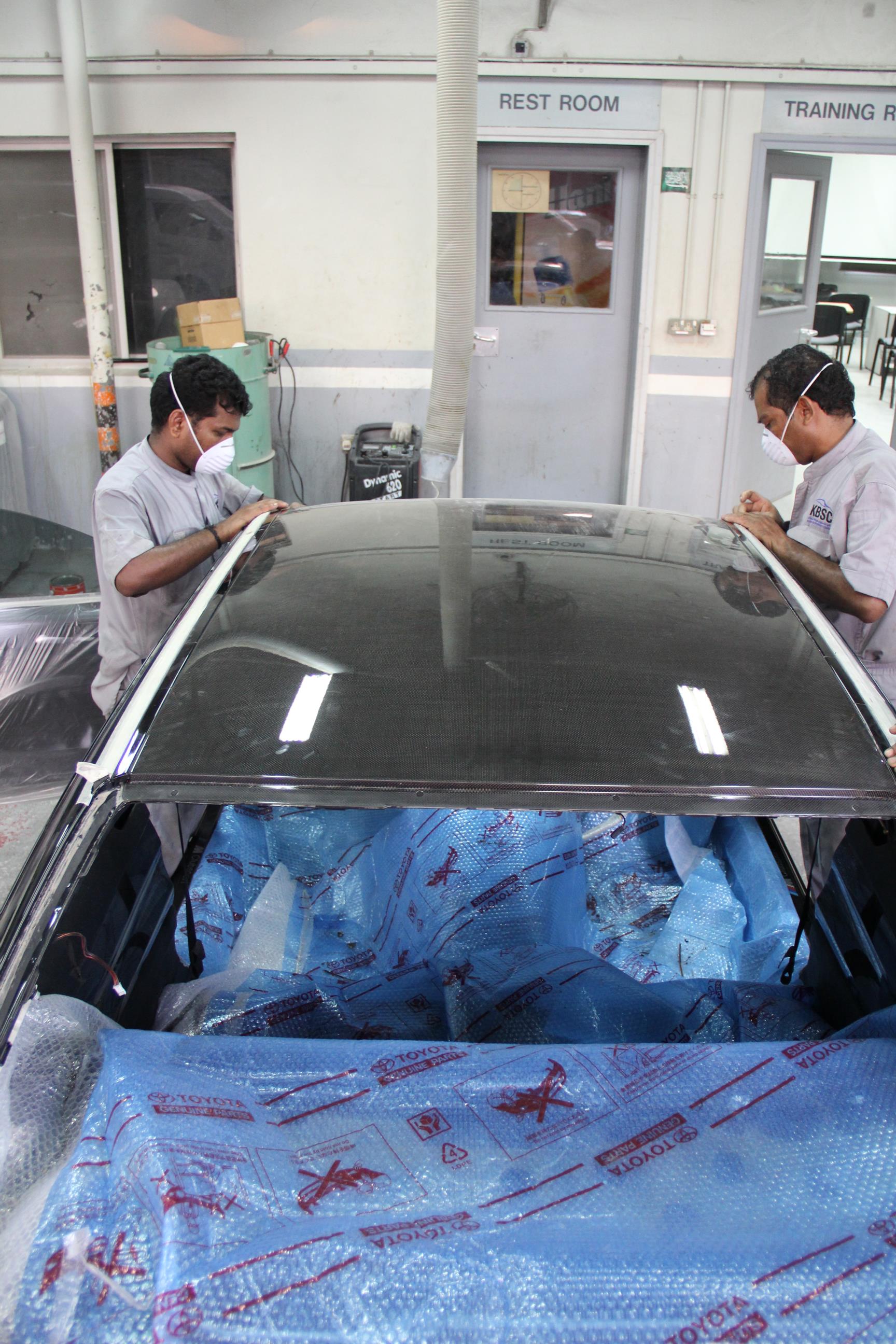

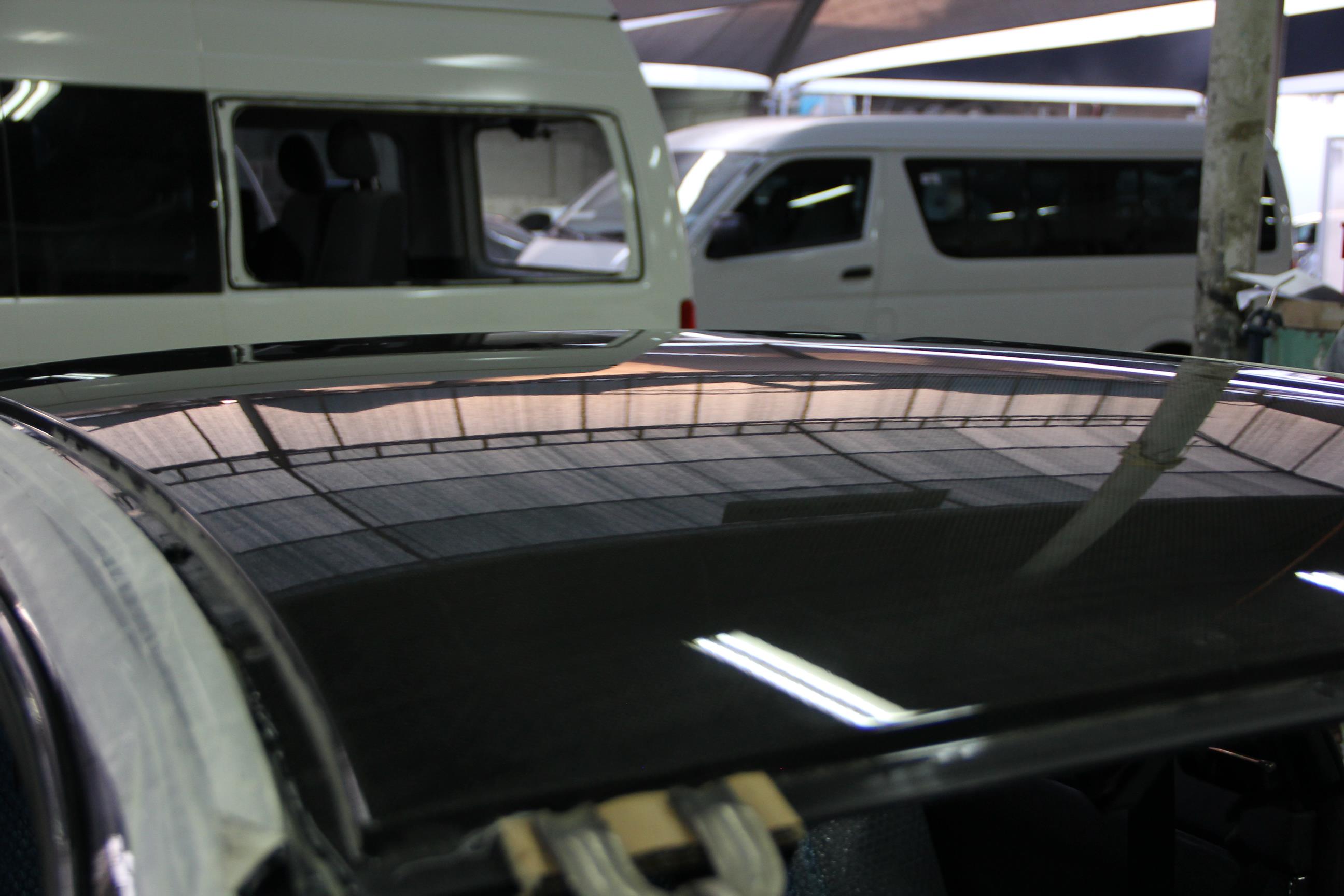

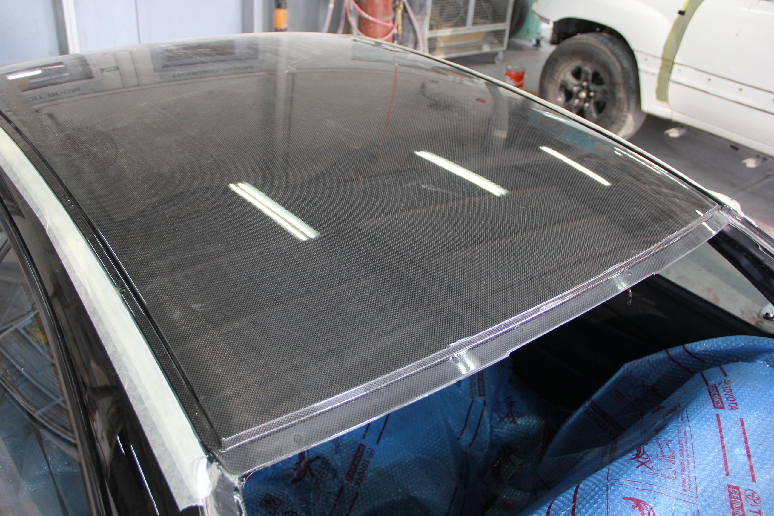

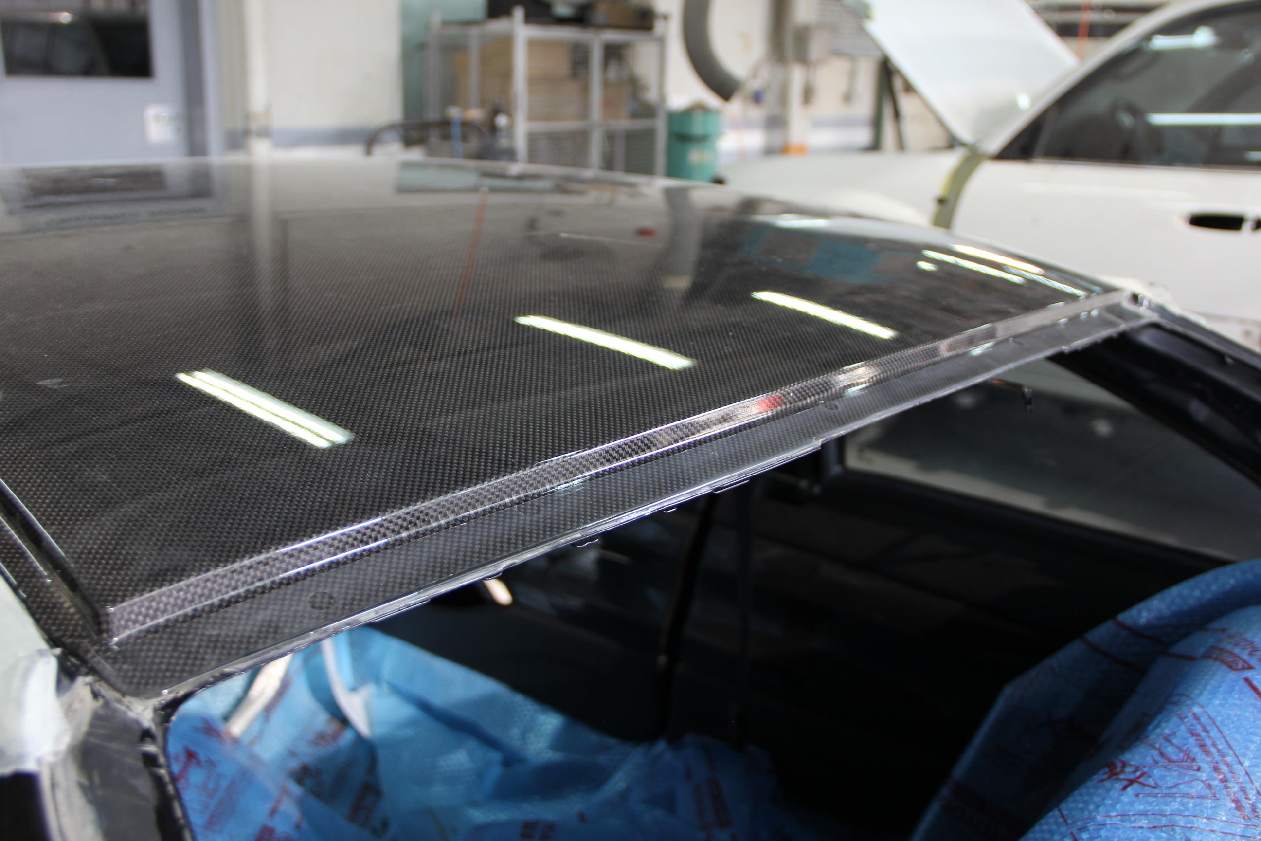

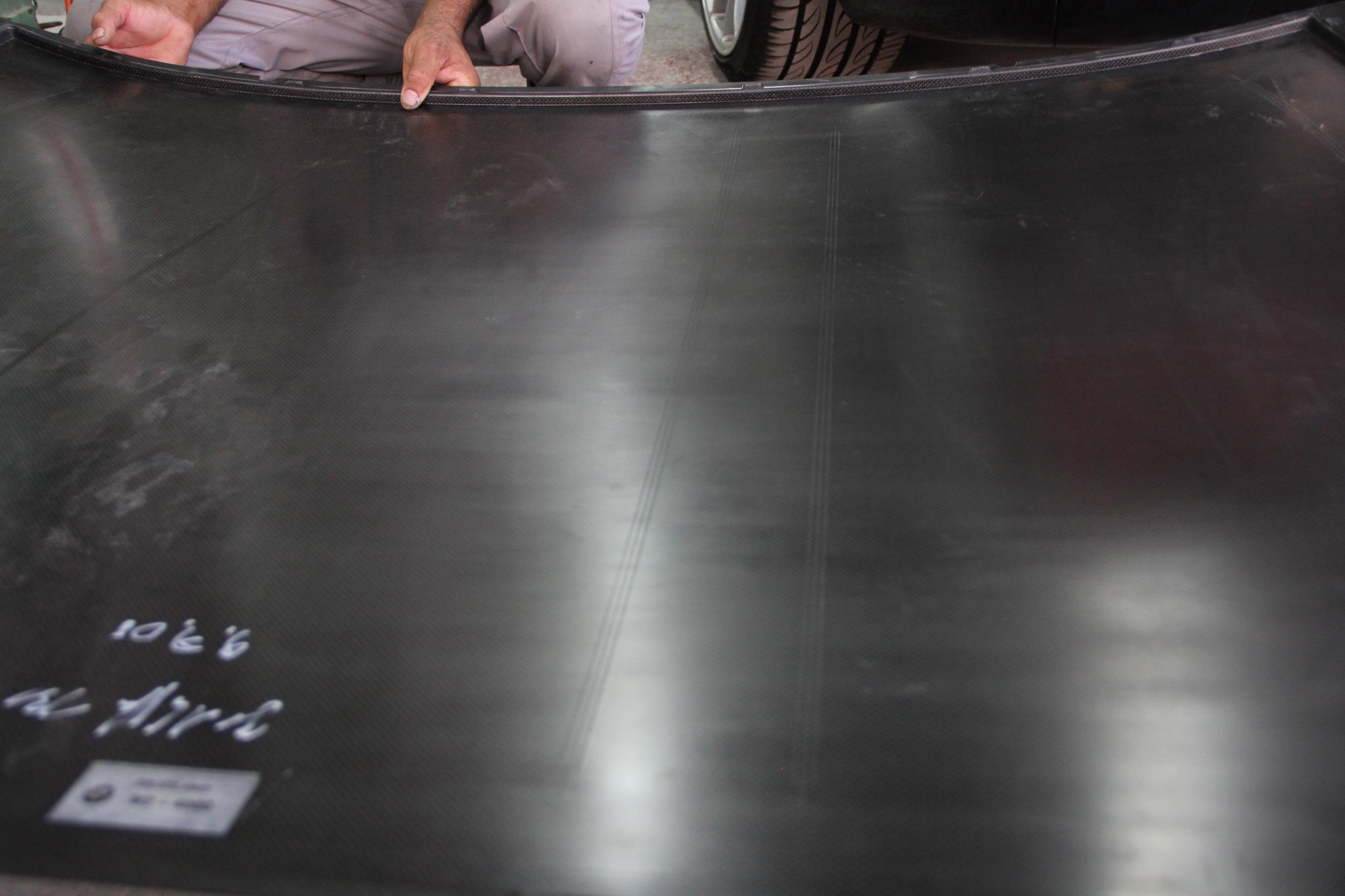

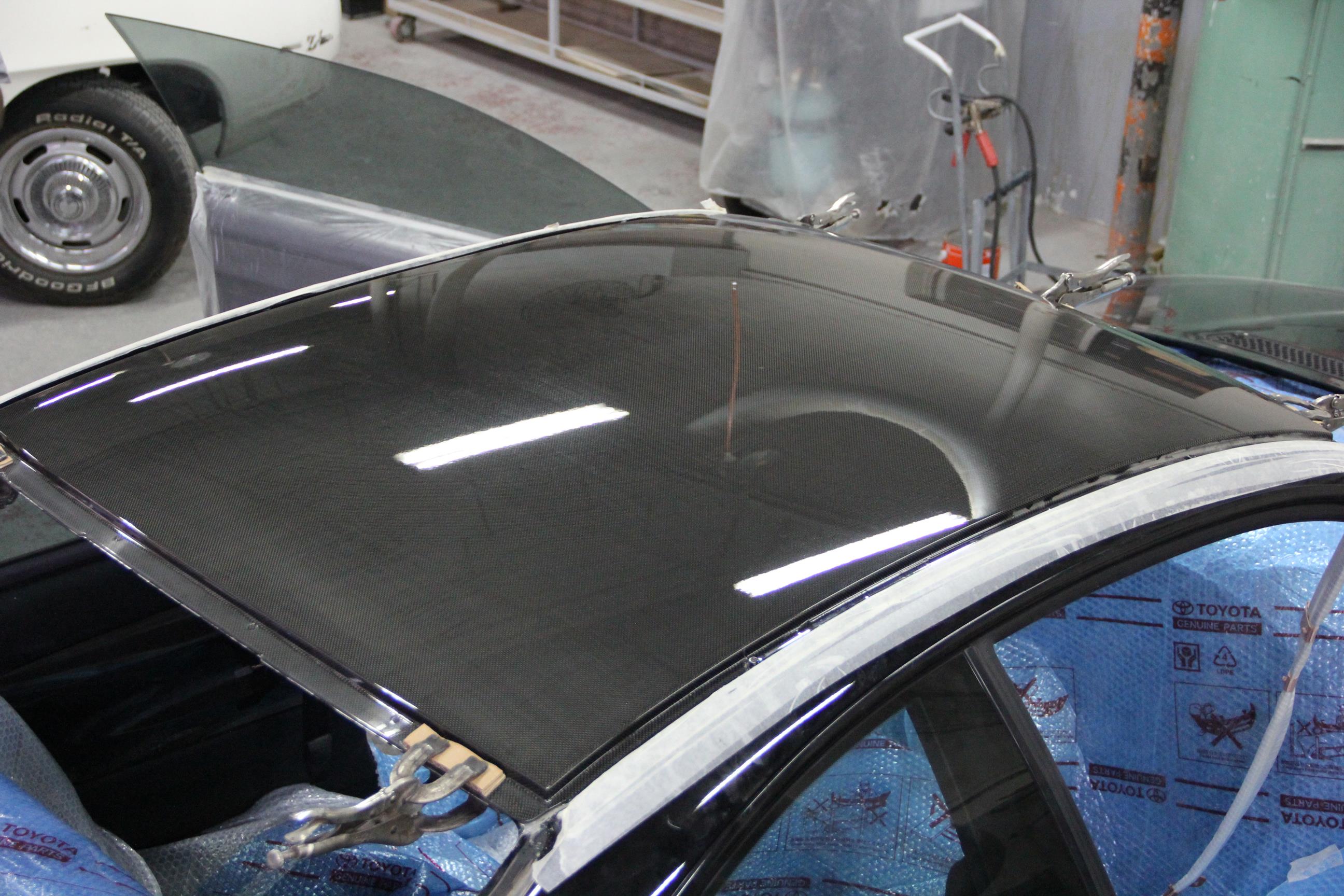

Test Fitting OEM CSL CF roof....

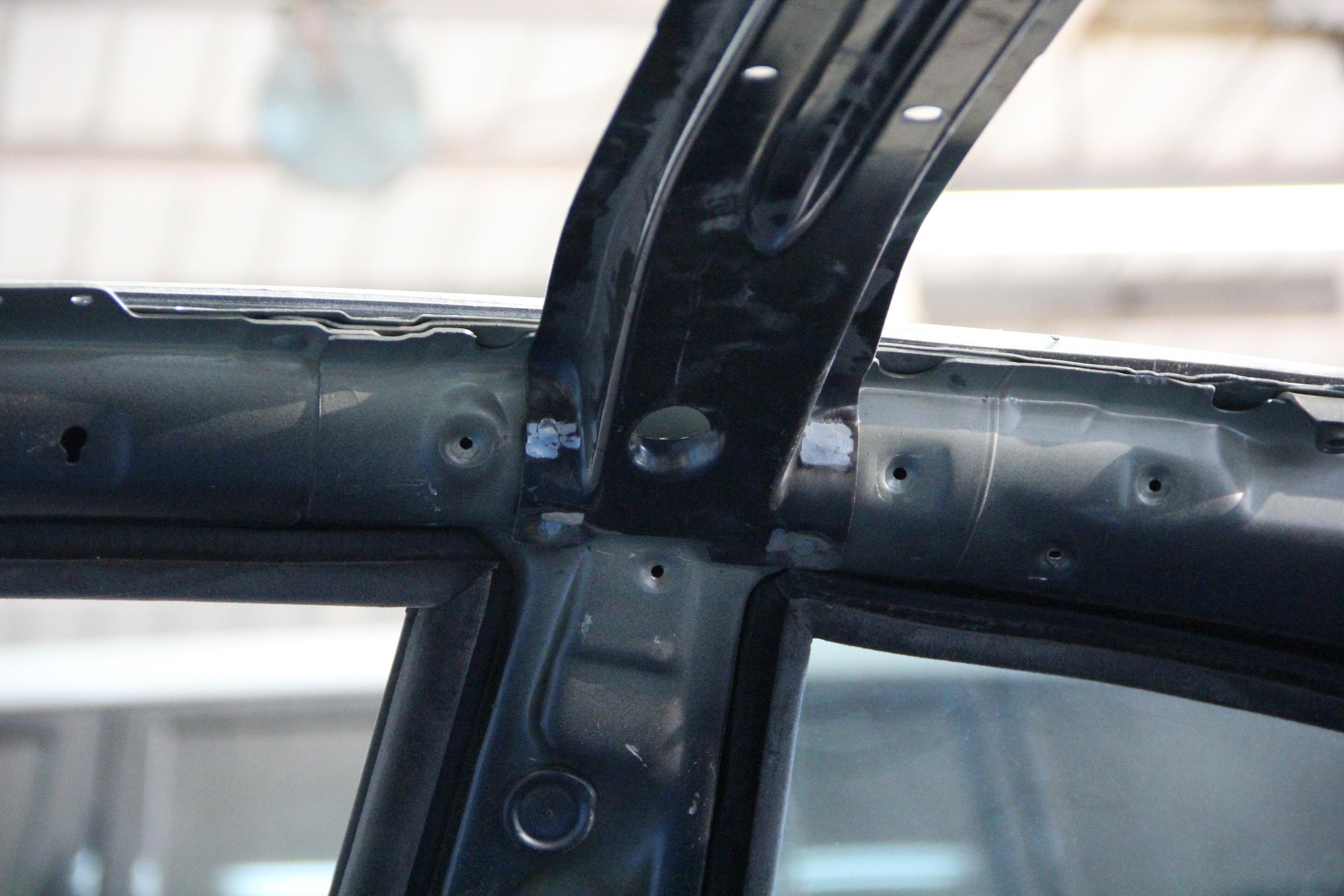

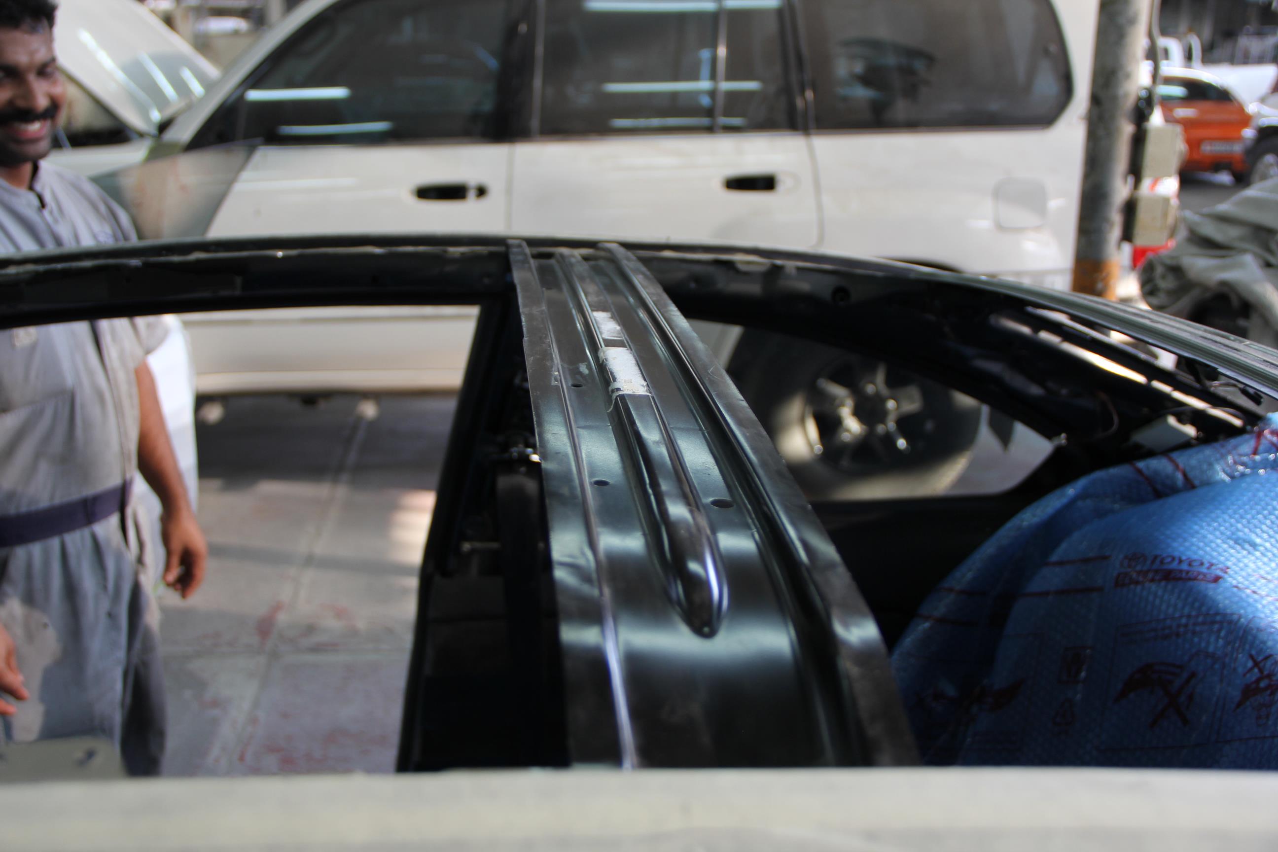

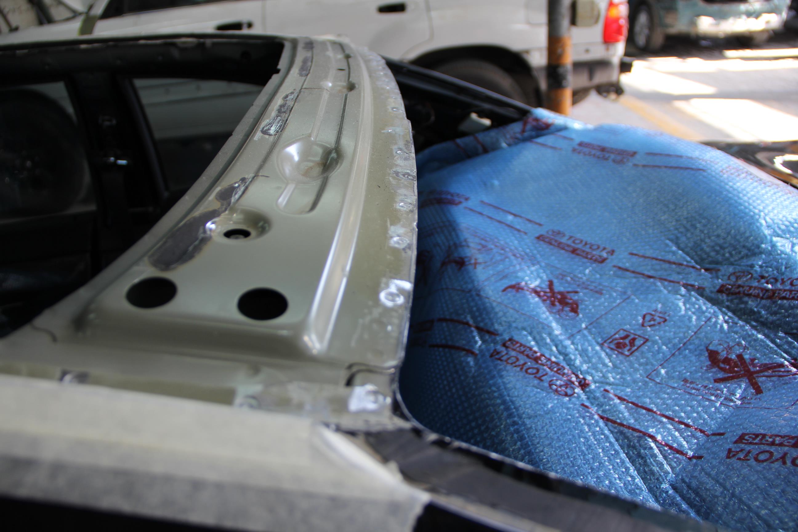

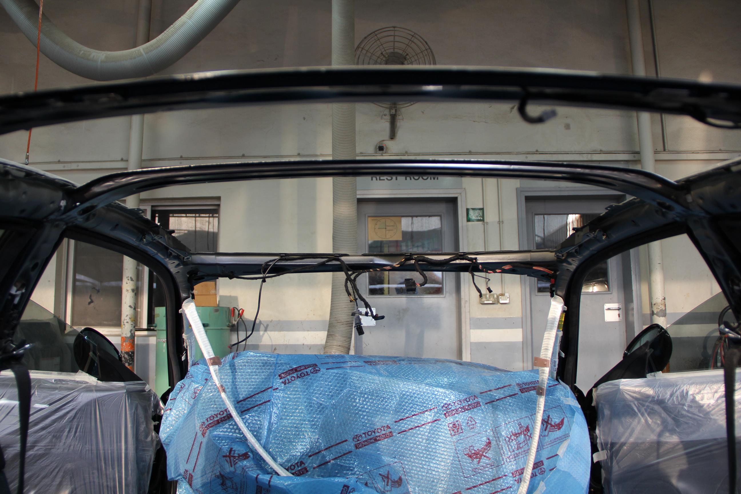

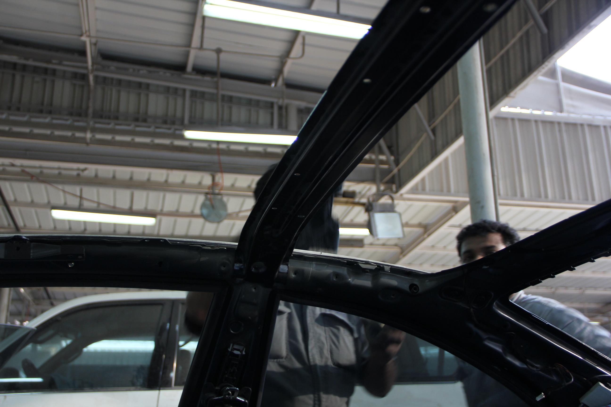

Center Support Bow for cars without sunroof installed and welded on....
Interior all wrapped to protect from any damage......

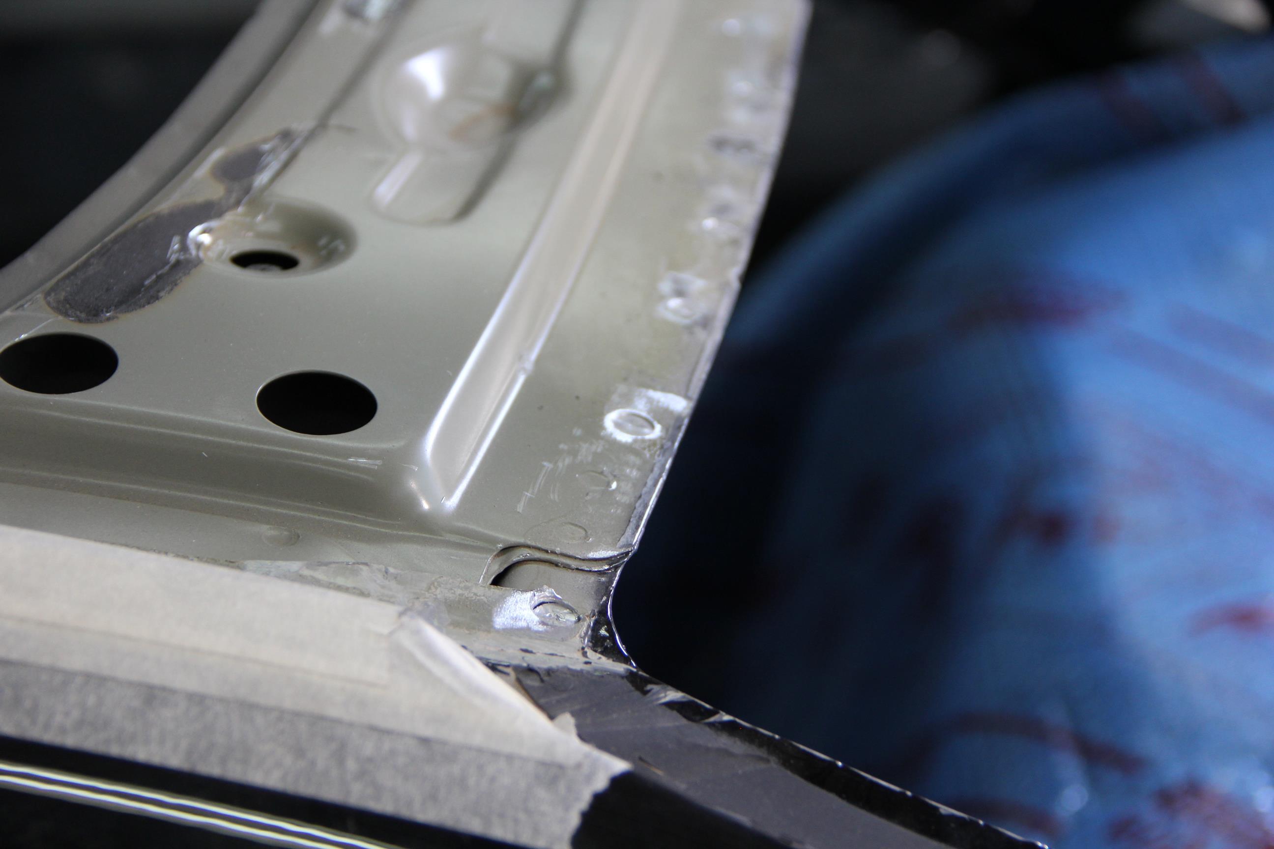

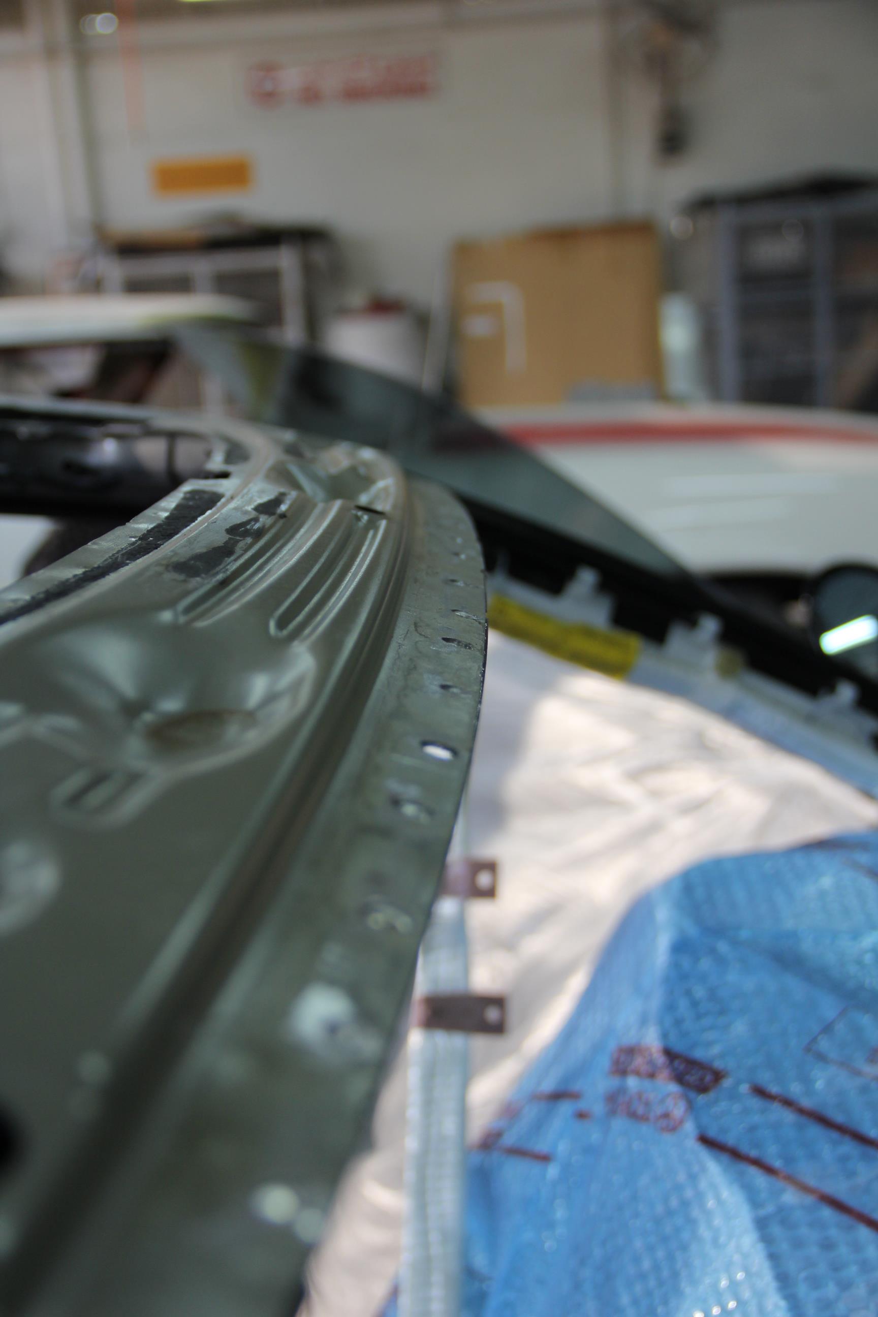

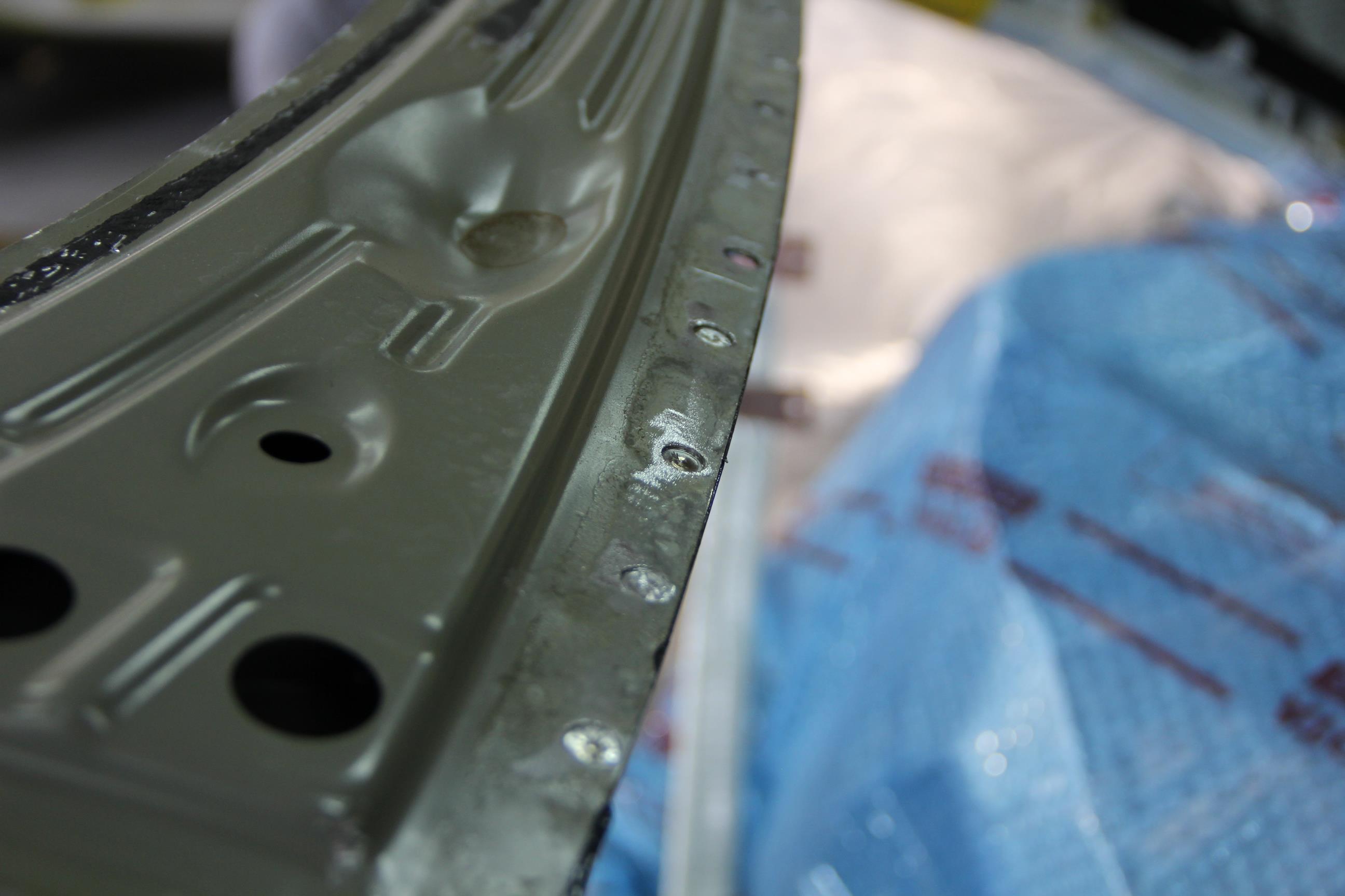

Some close up of the drilled out tac welds.....

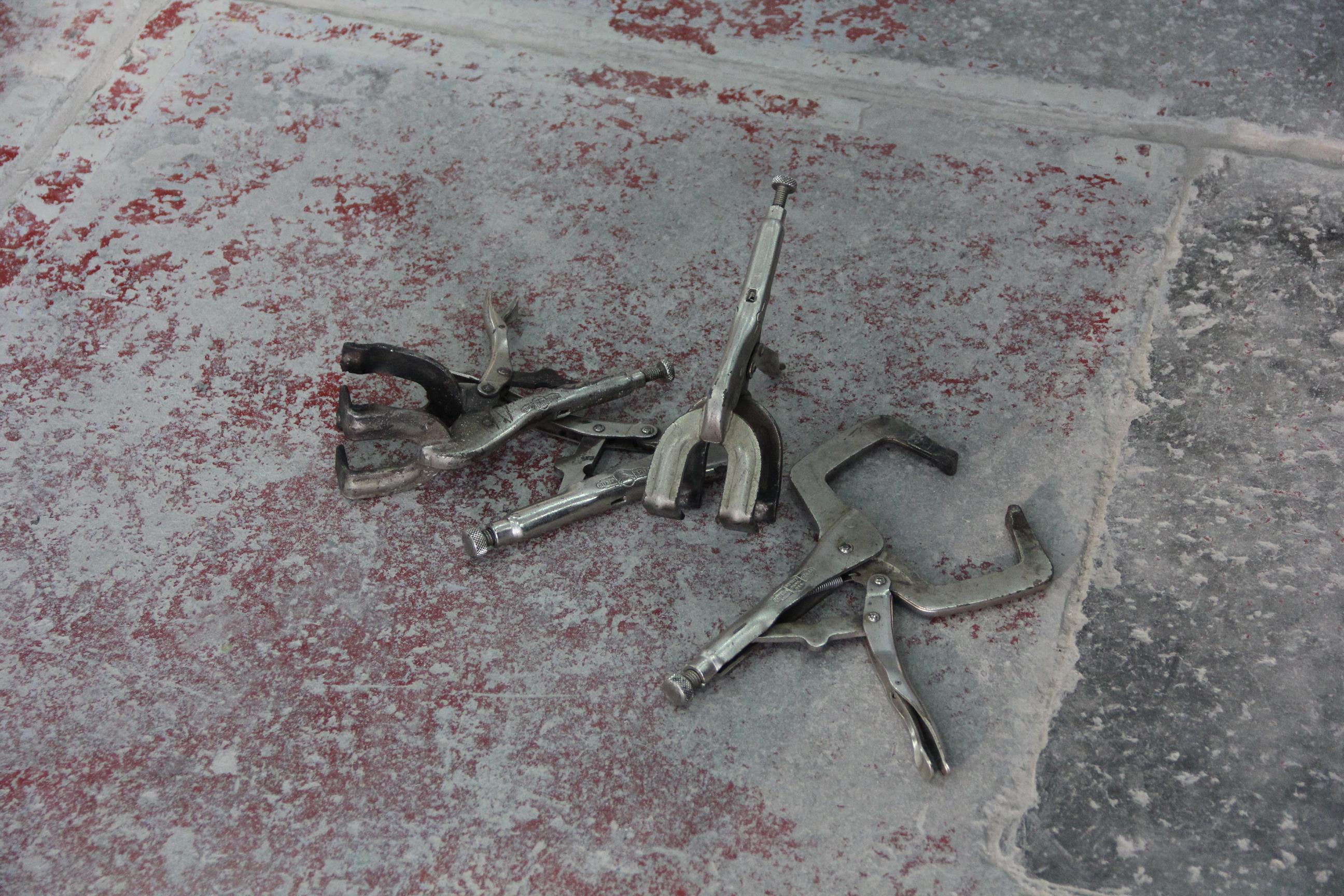

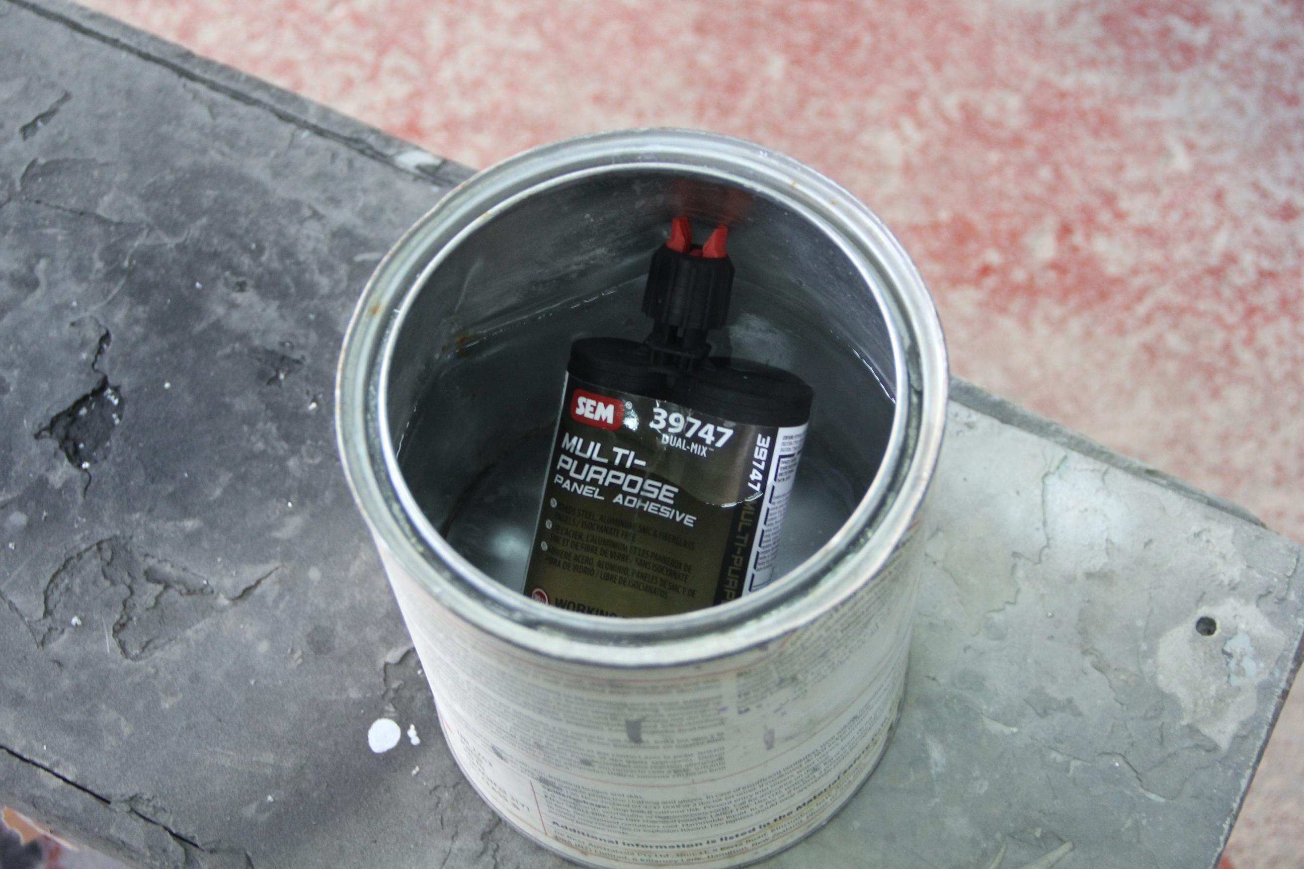

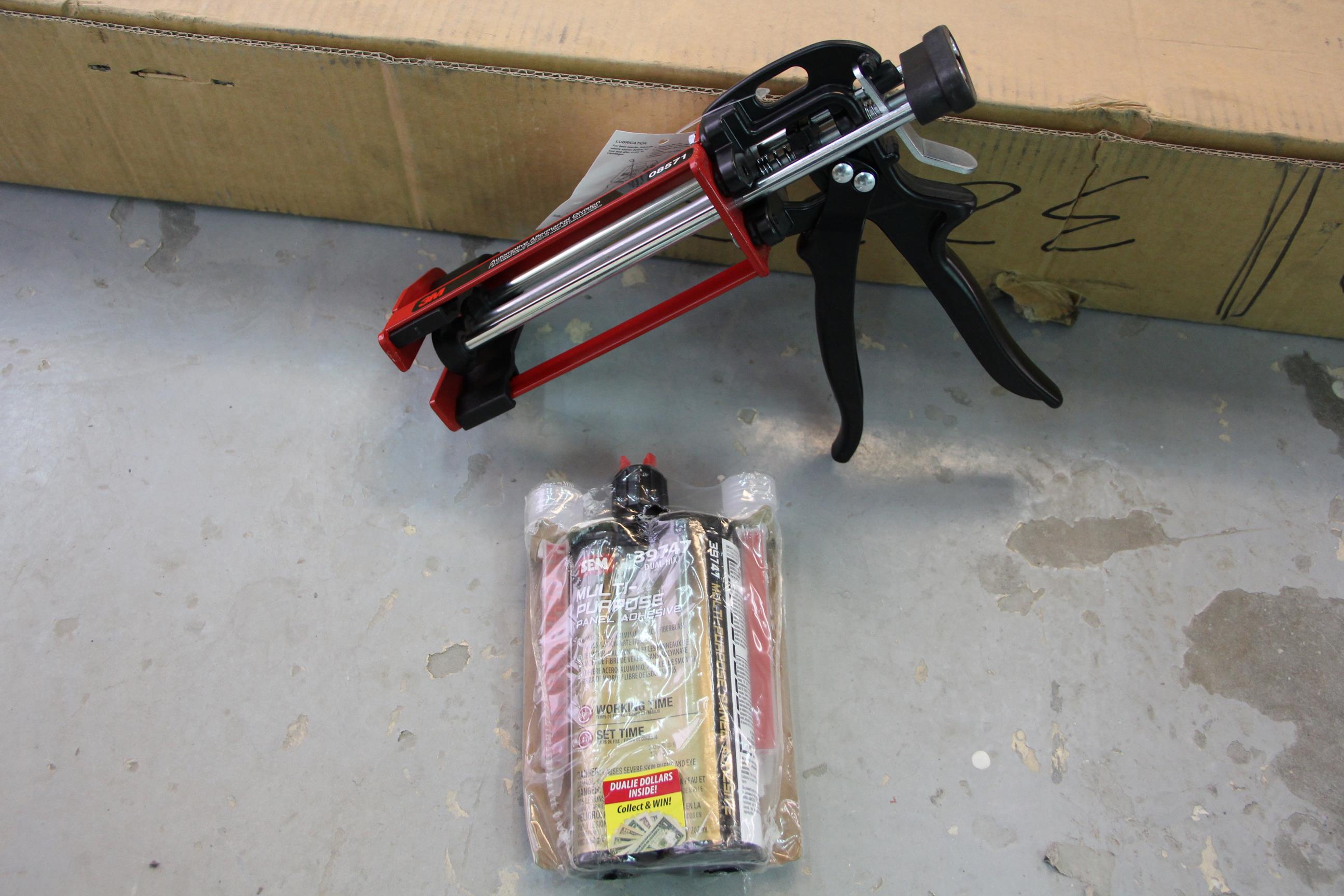

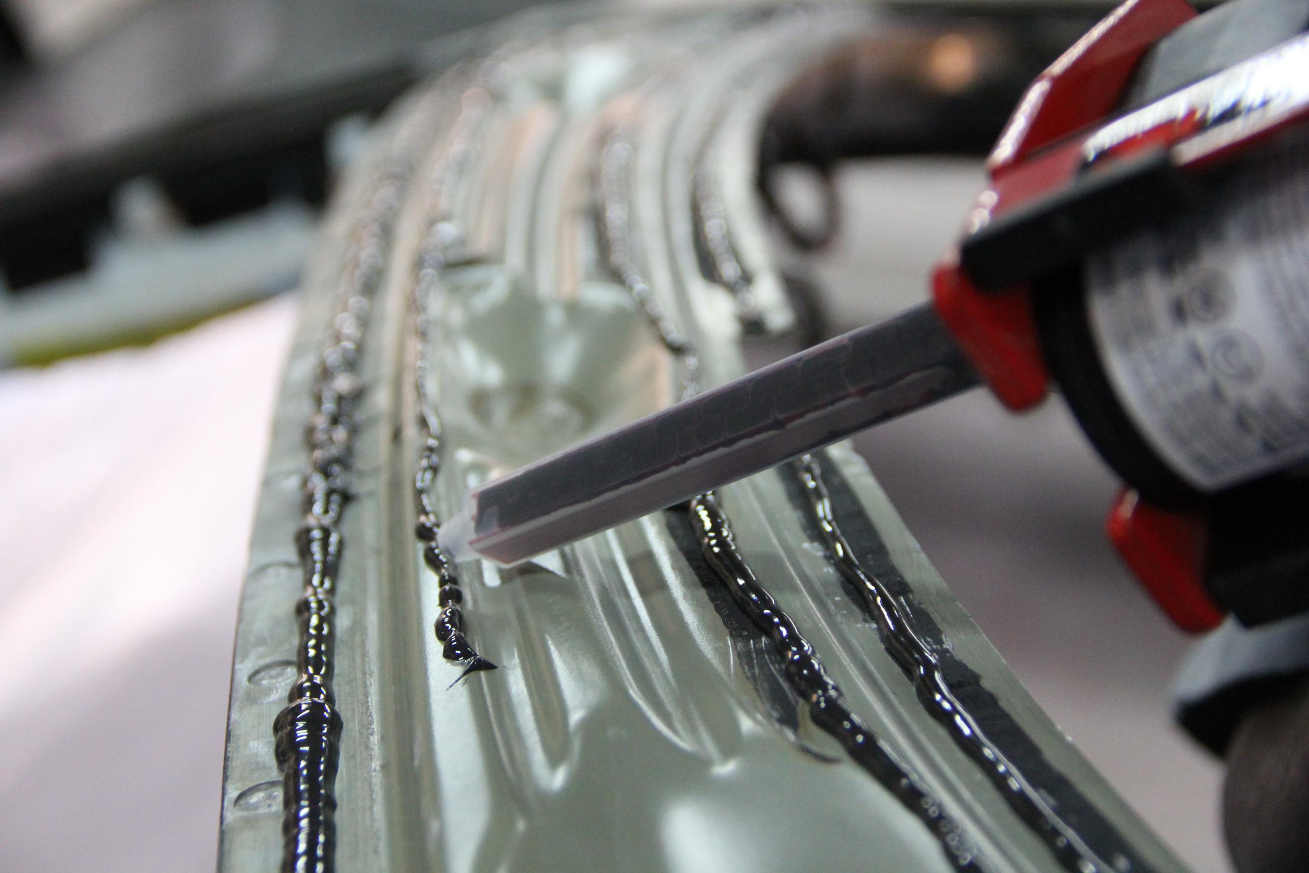

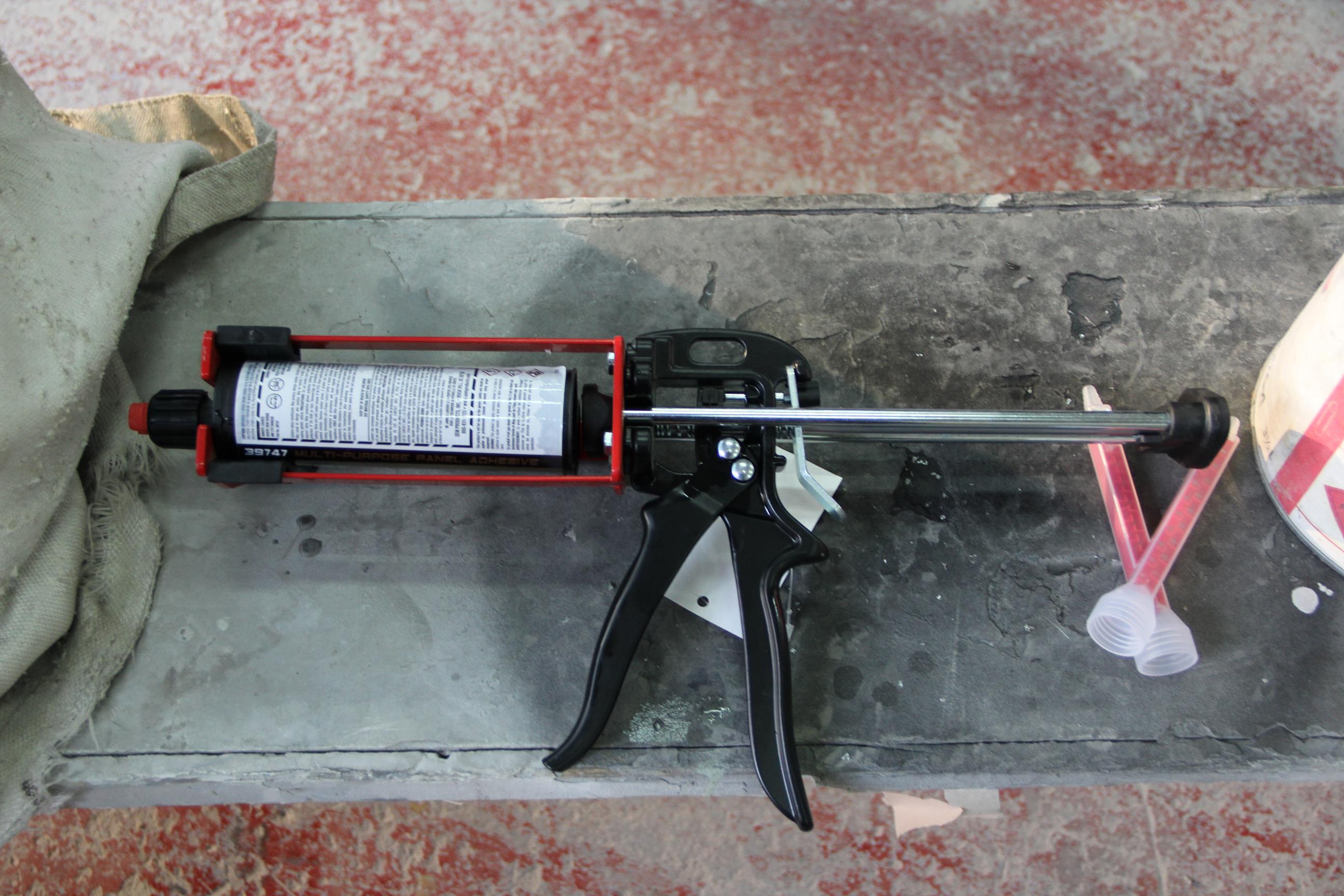

Clamps, Adhesive, locked and loaded in the gun.....ready to move forward with the install of the roof.....

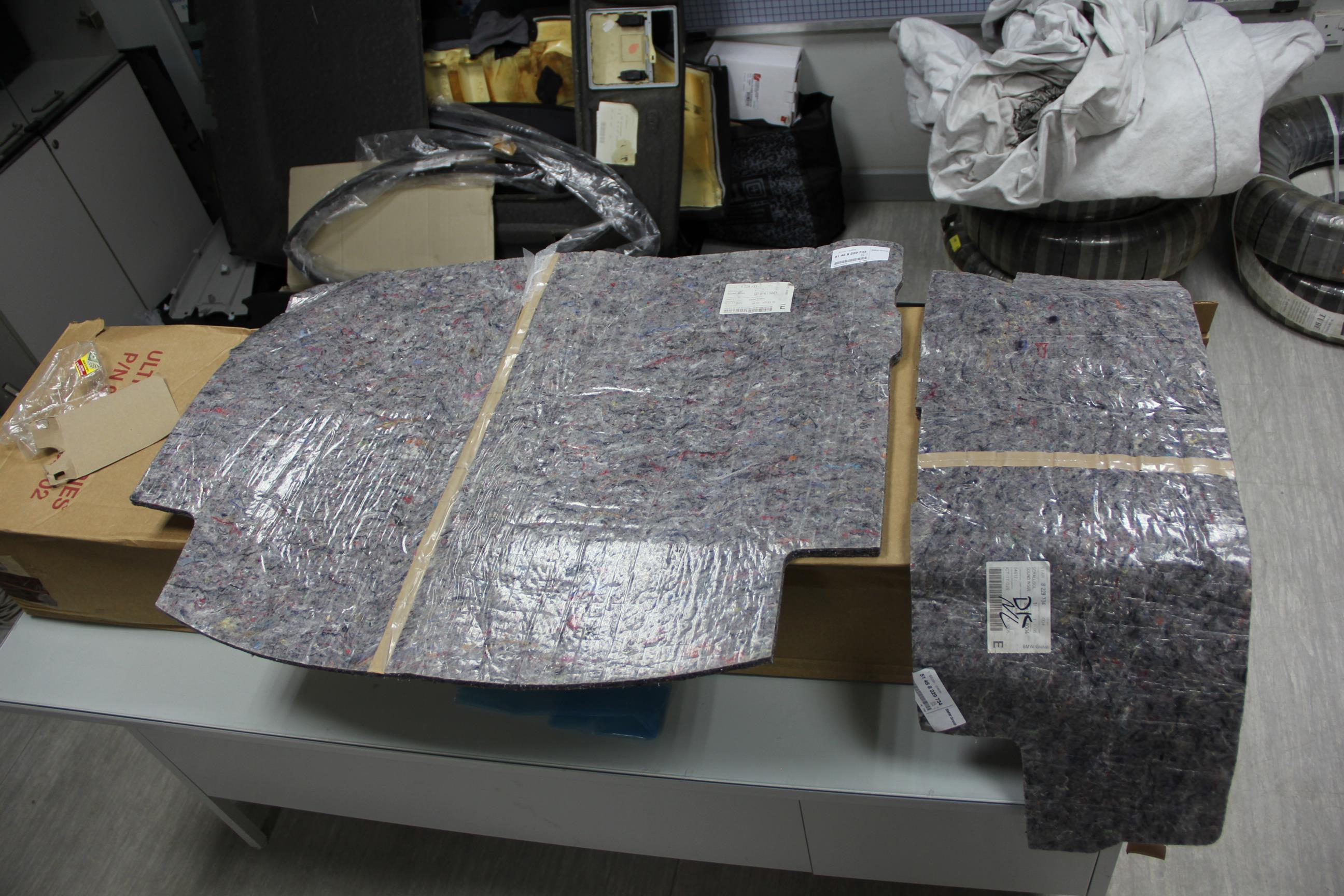

Sound deadening for the roof....

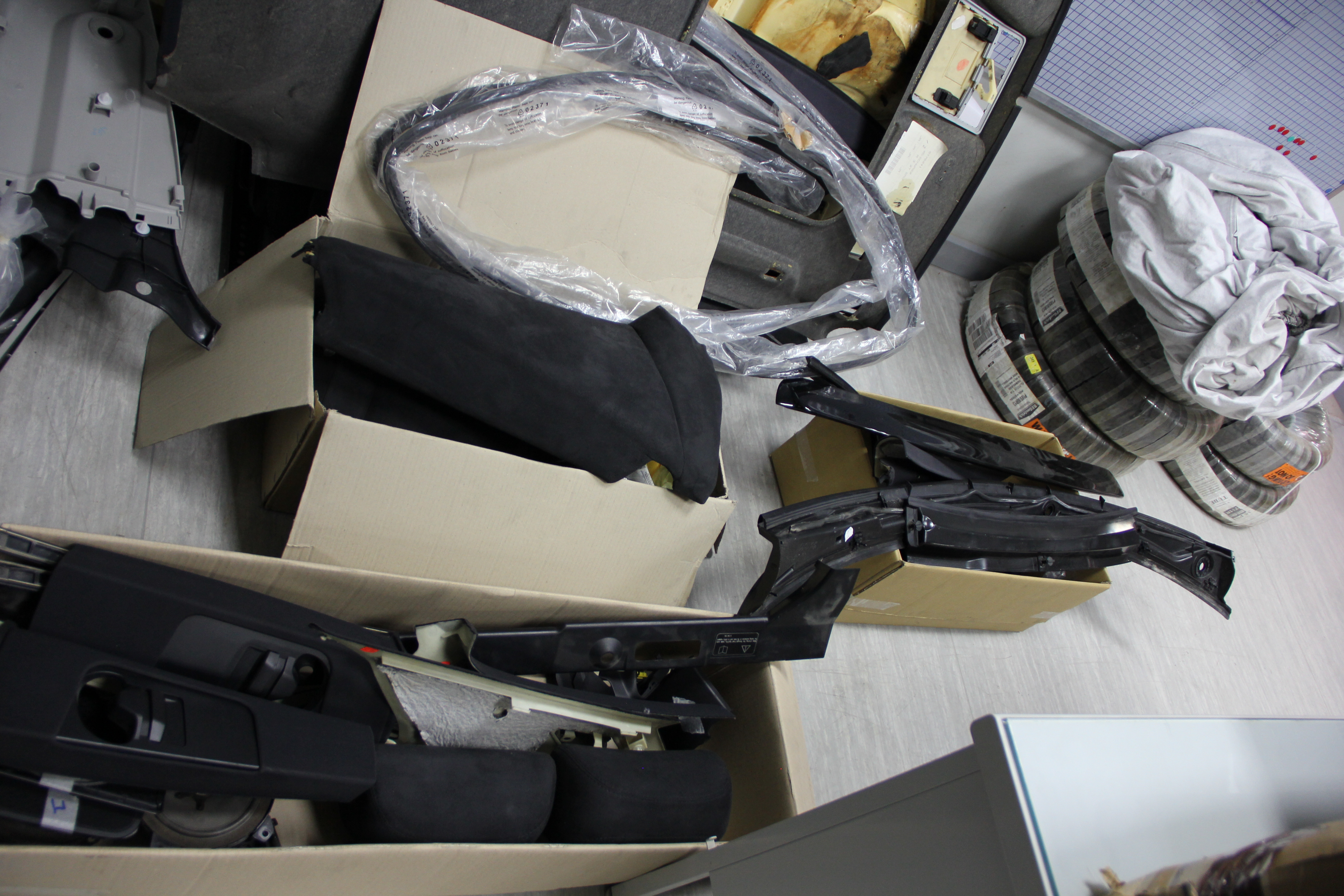

My Complete OEM CSL Interior.....

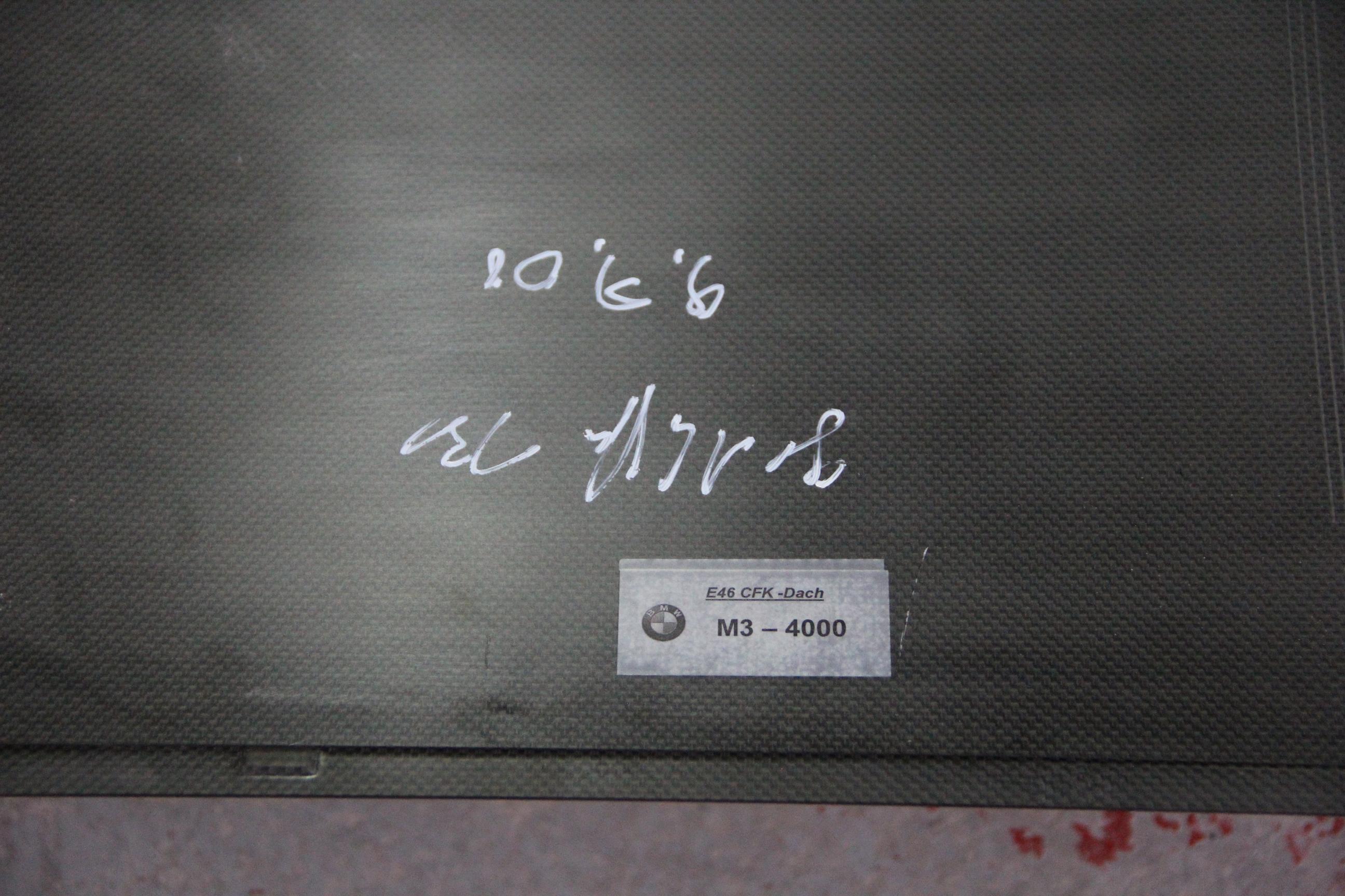

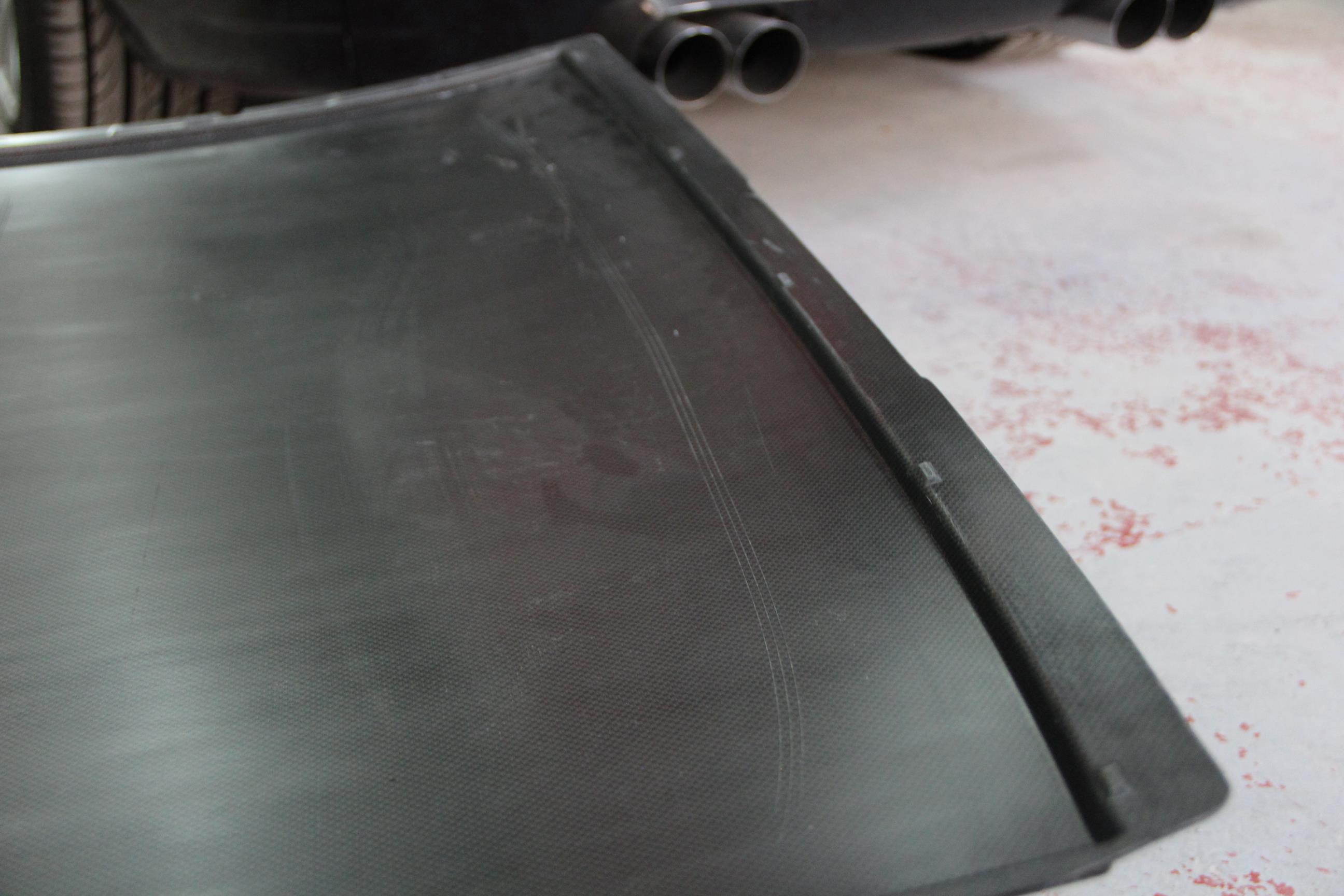

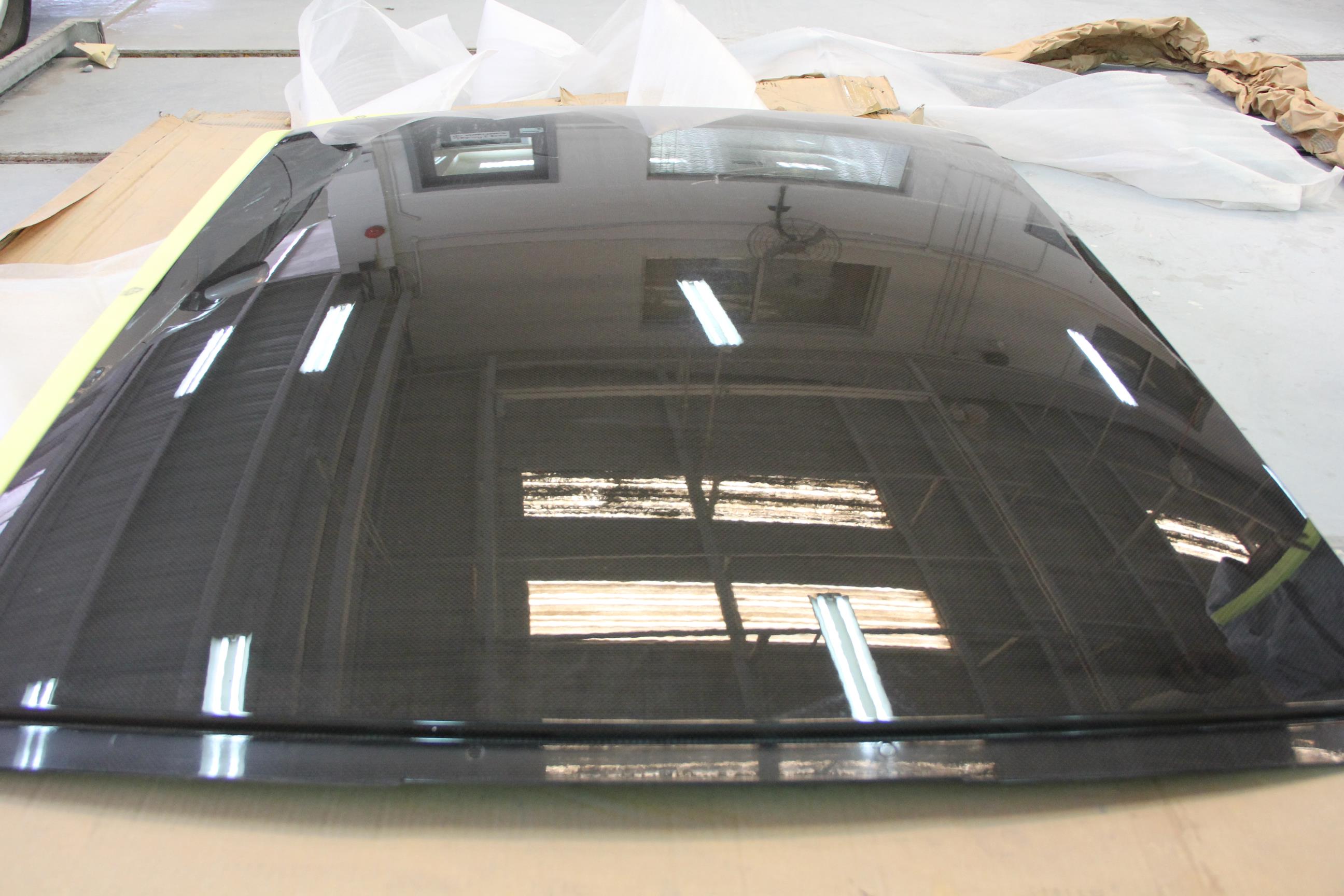

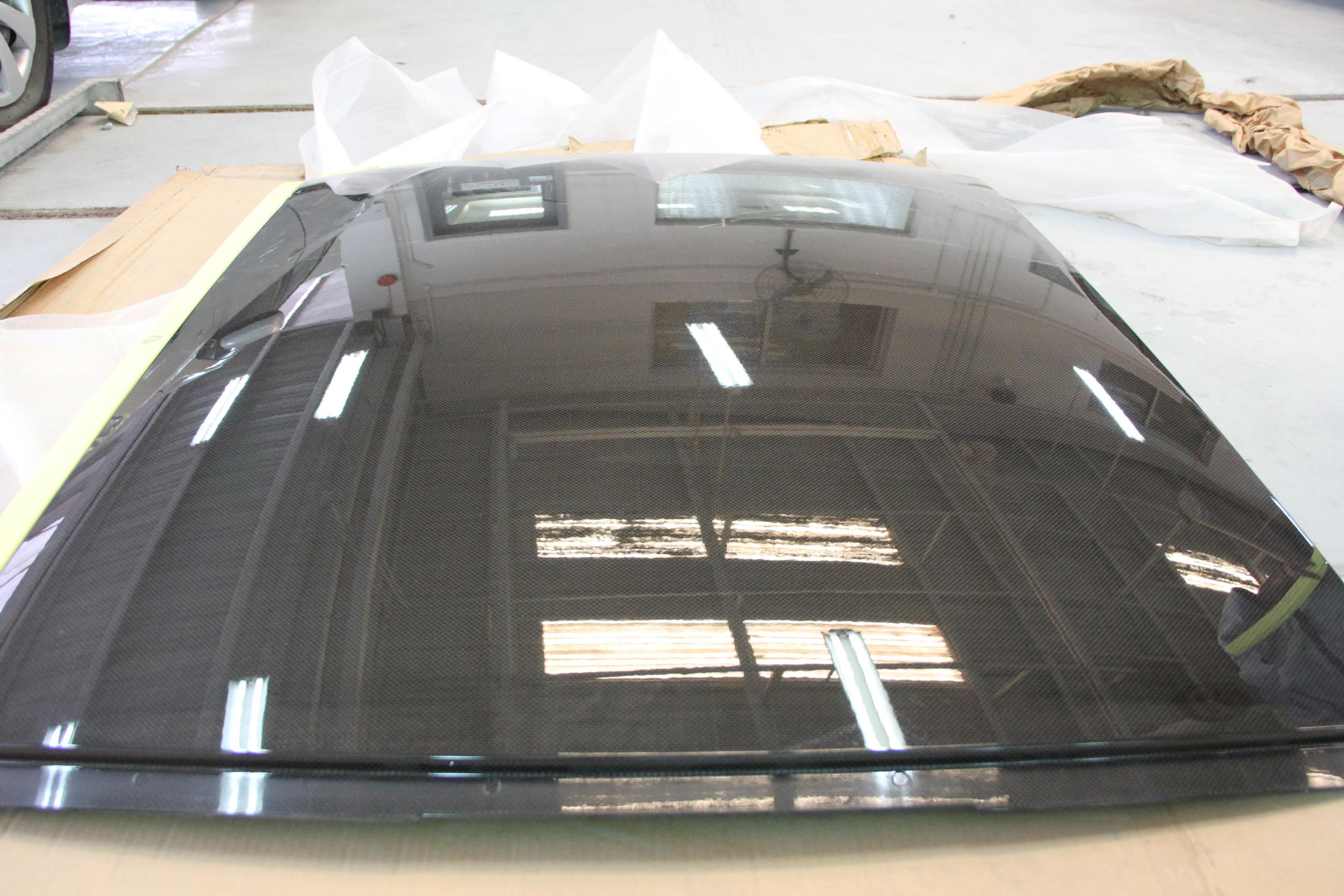

The Beautiful OEM CSL Roof lying there waiting to be glued on to the car.....

Cleaned the roof from the inside with alcohol to prep the surface for bonding. It is beautiful how BMW have markings underneath to help align the roof with the car and center support beam....

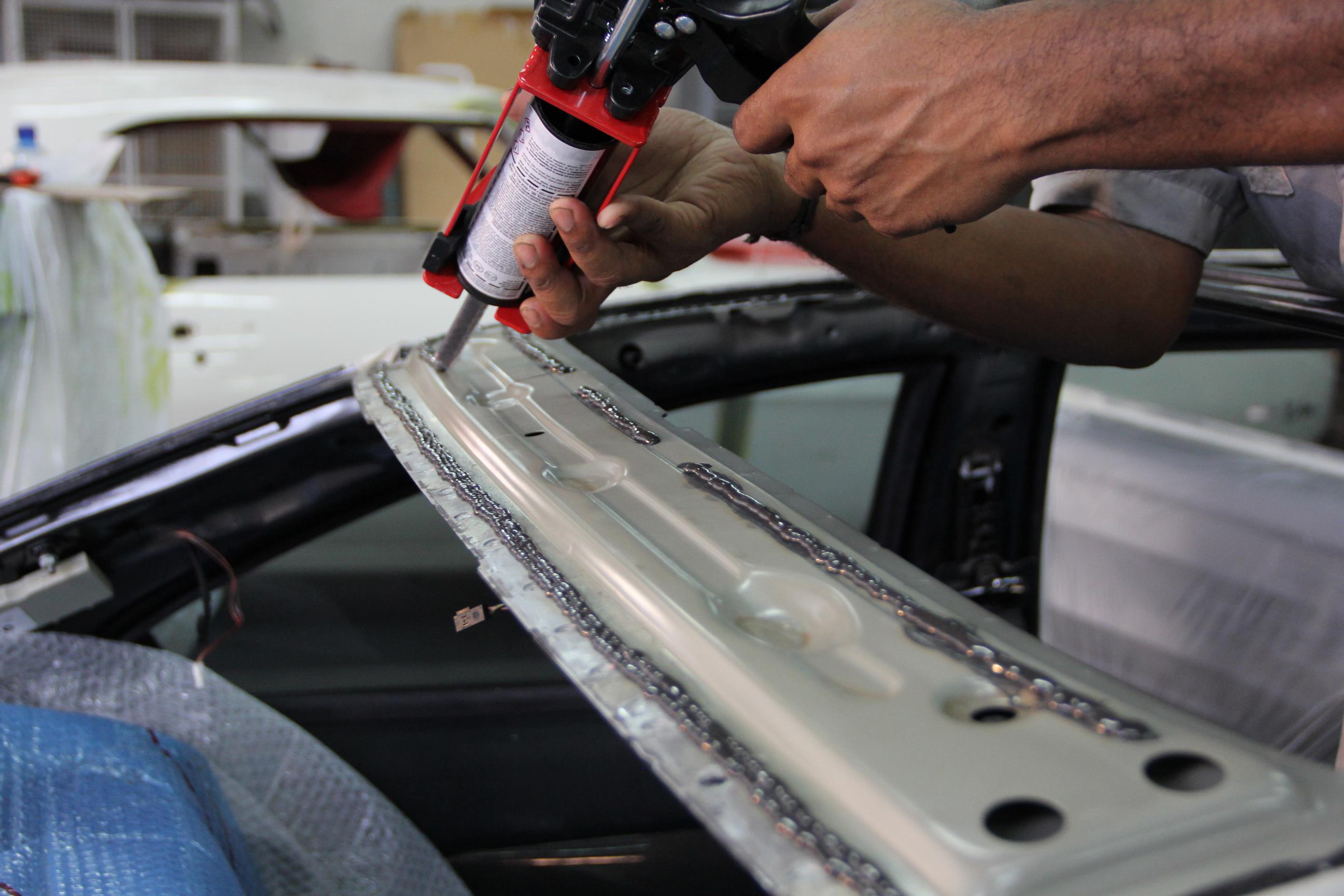

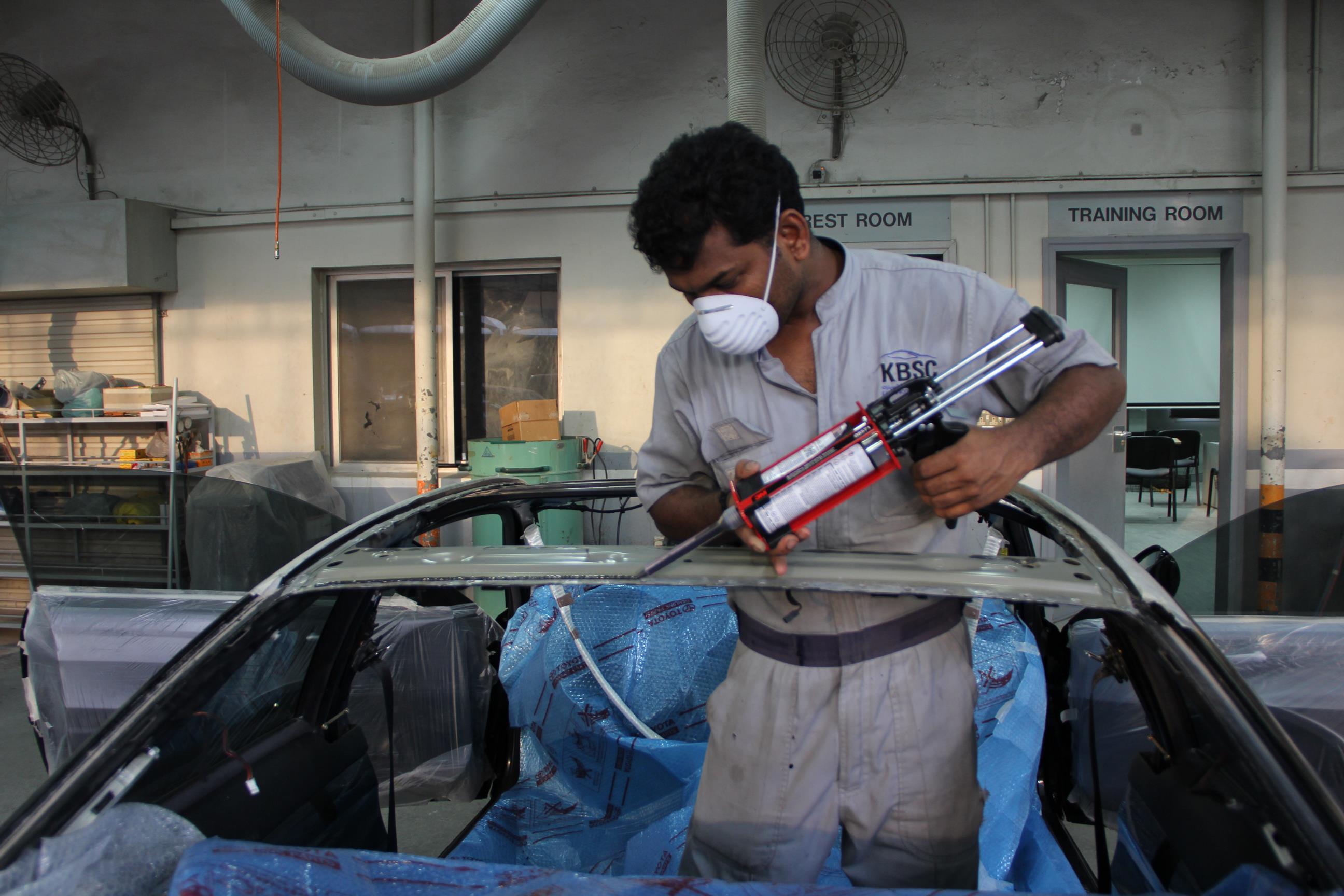

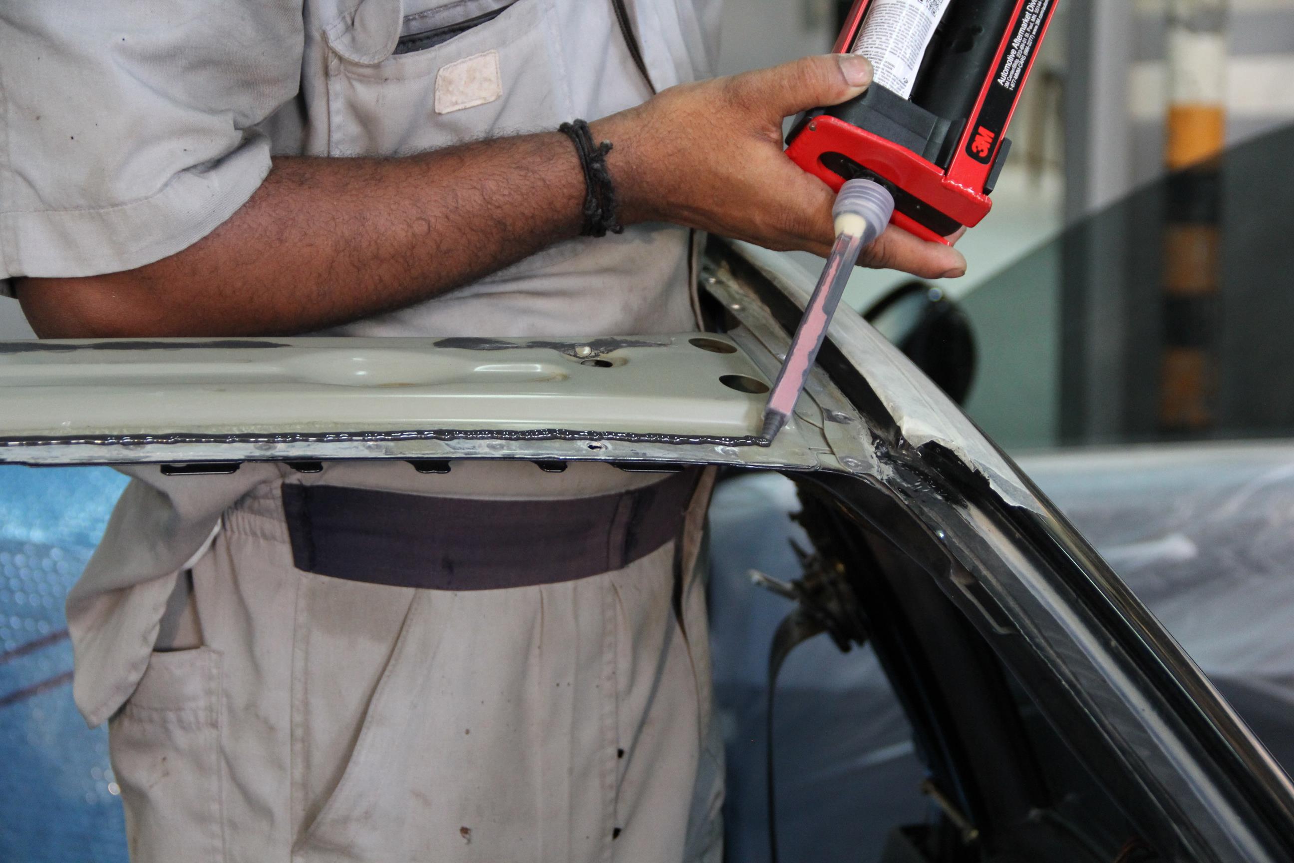

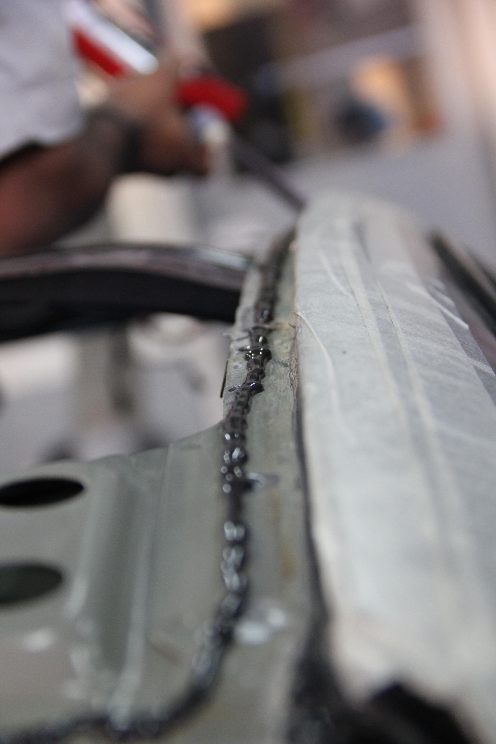

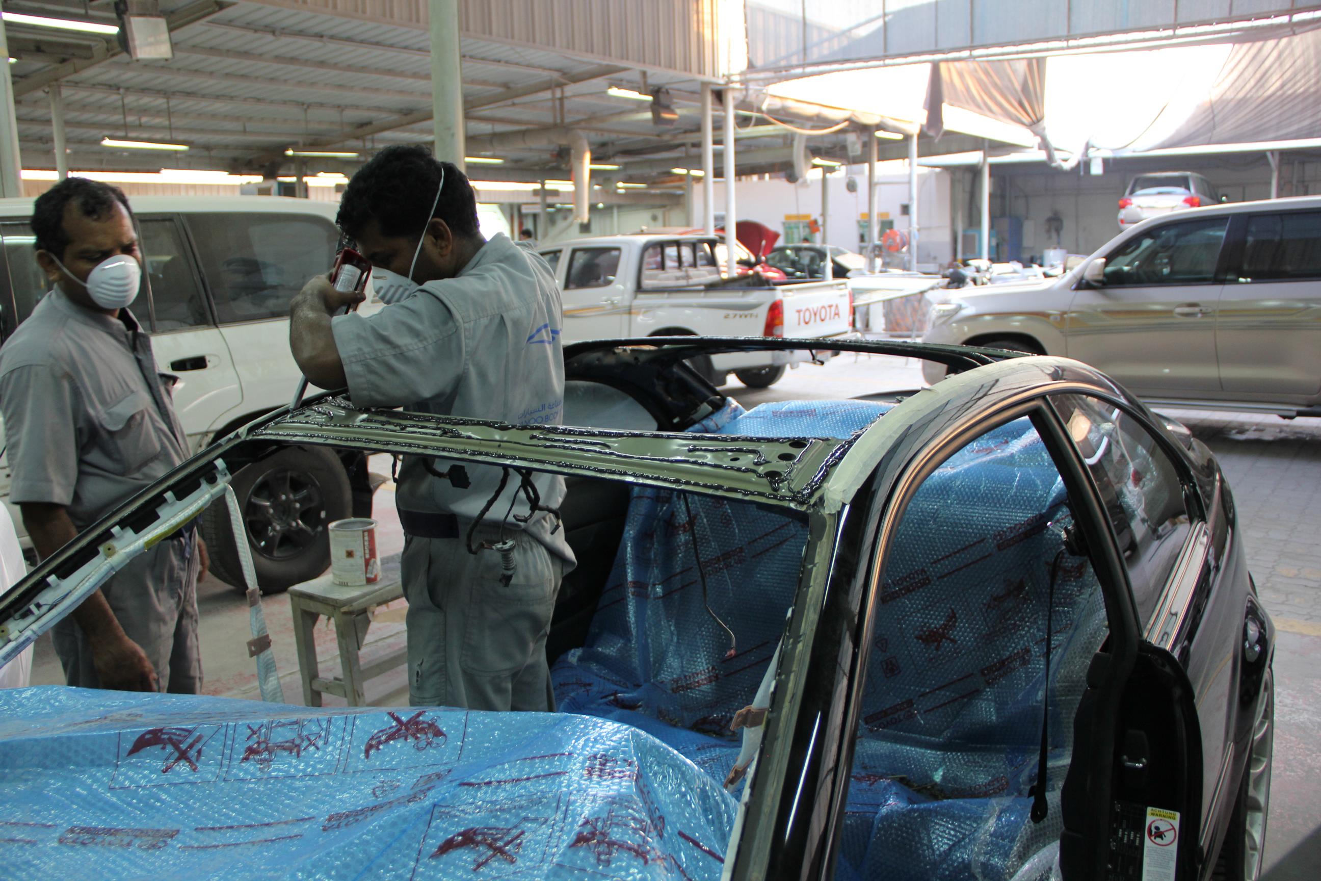

Applying the SEM adhesive....

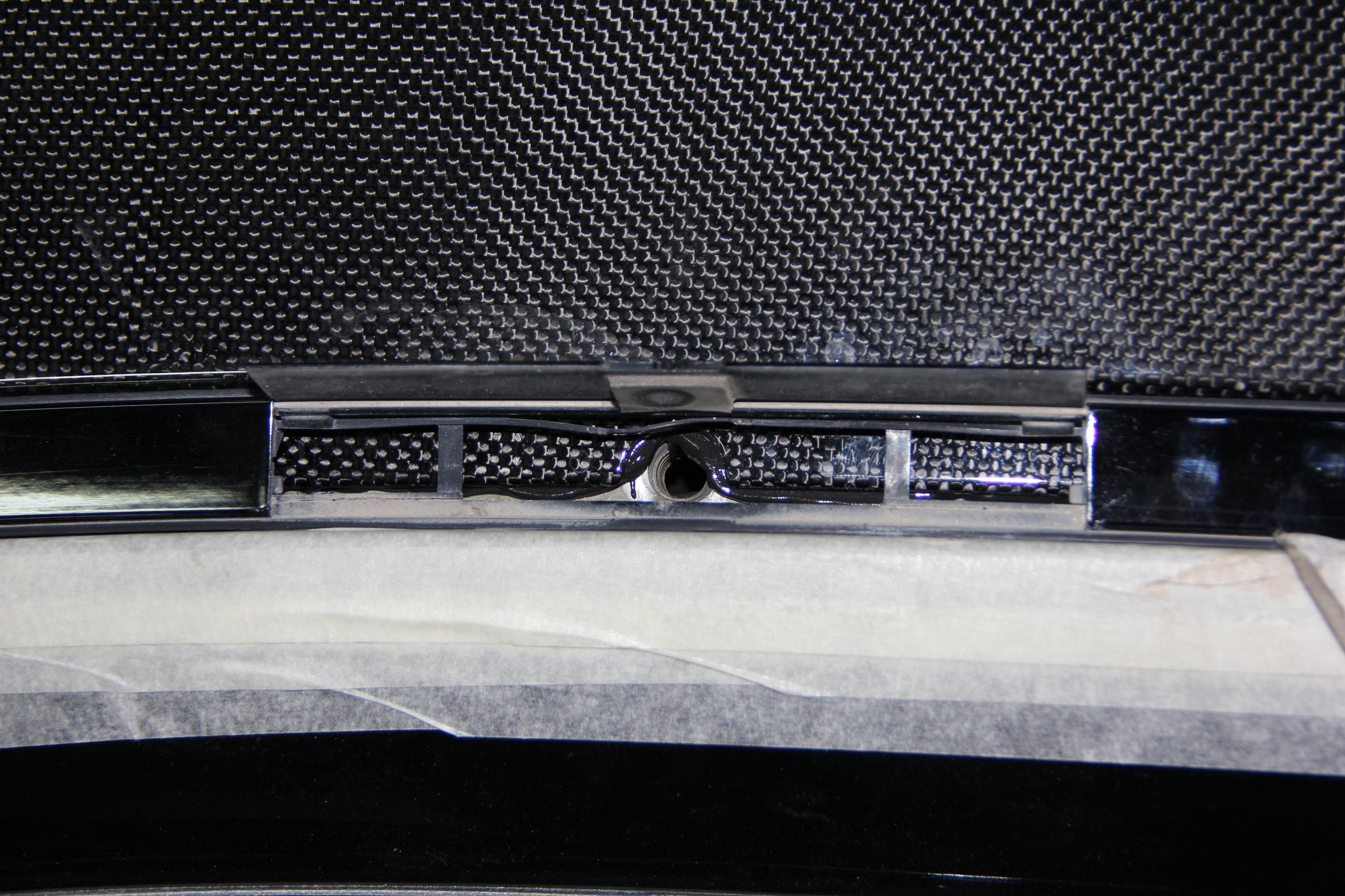

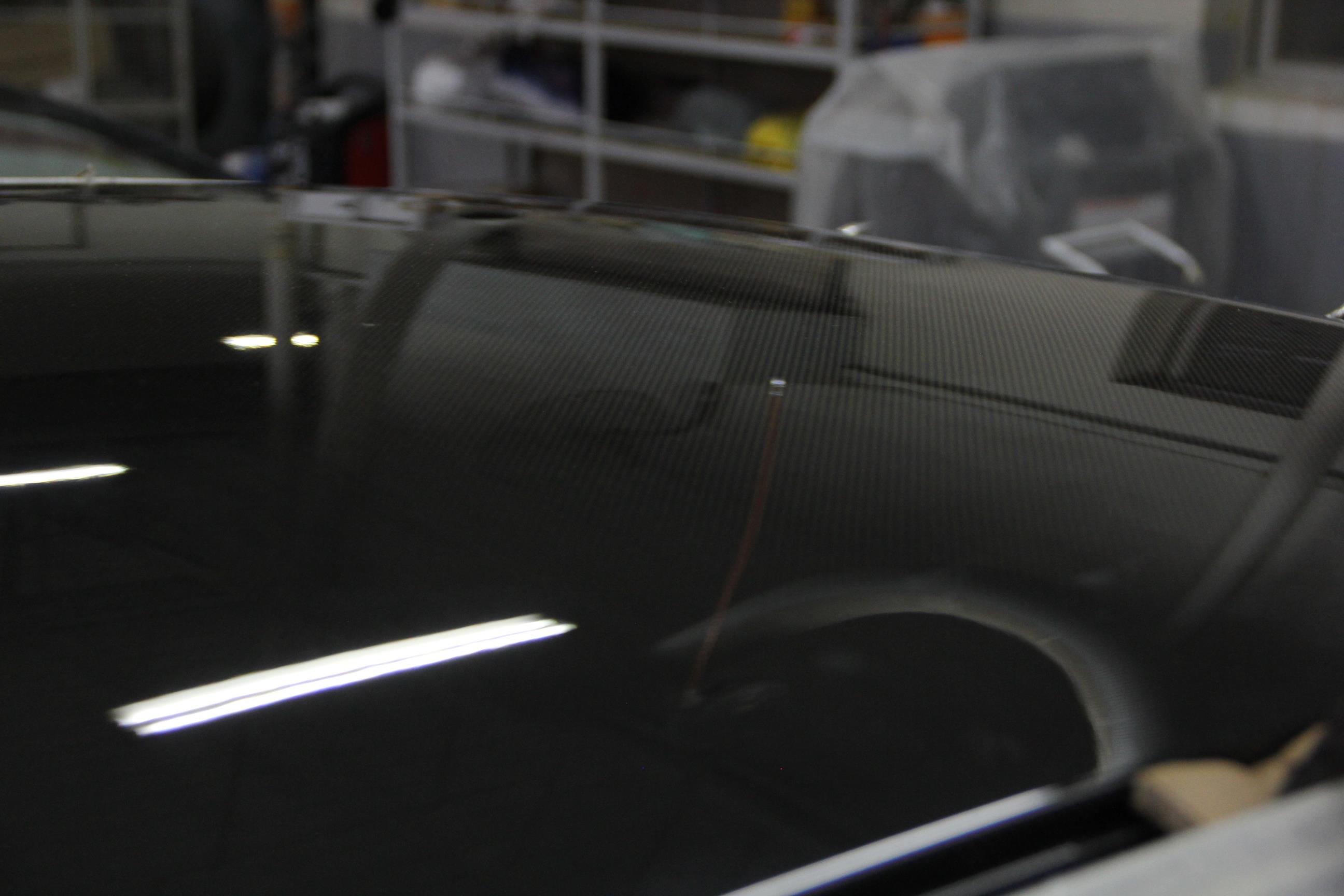

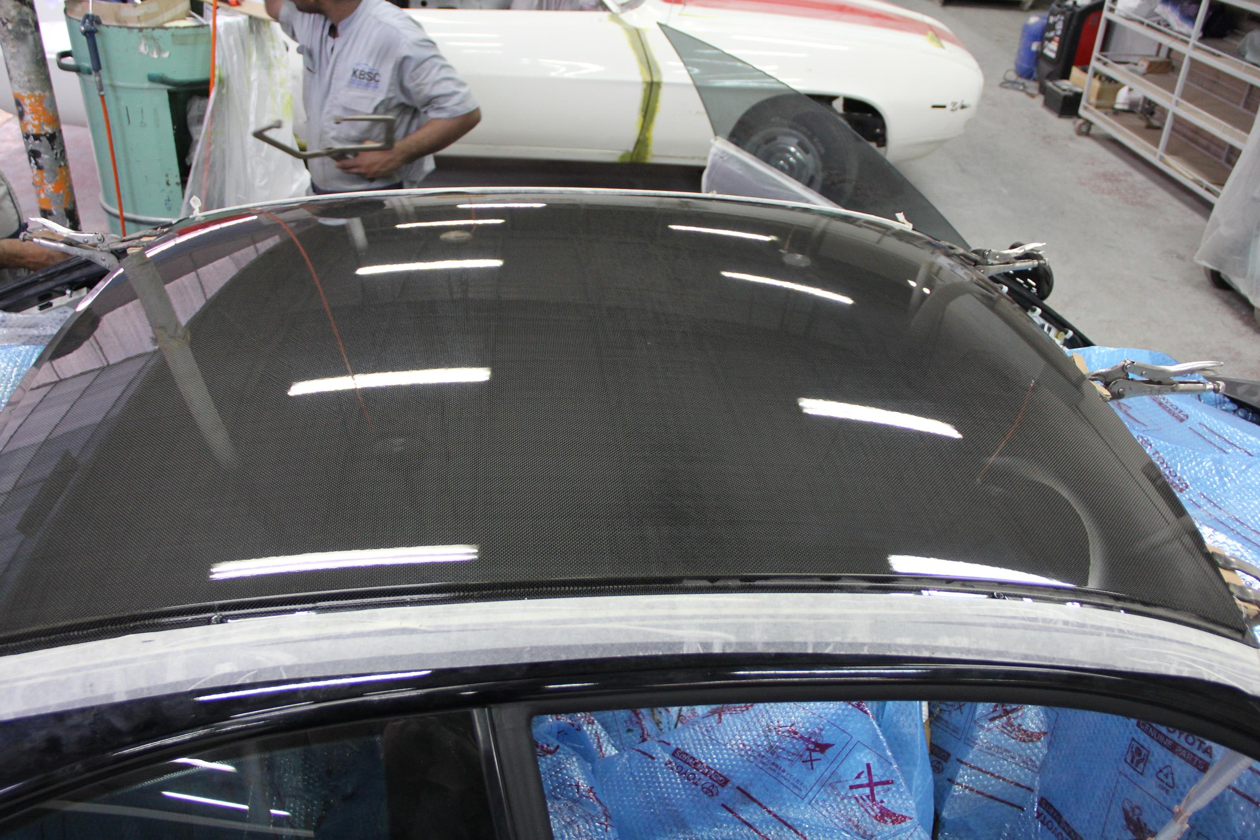

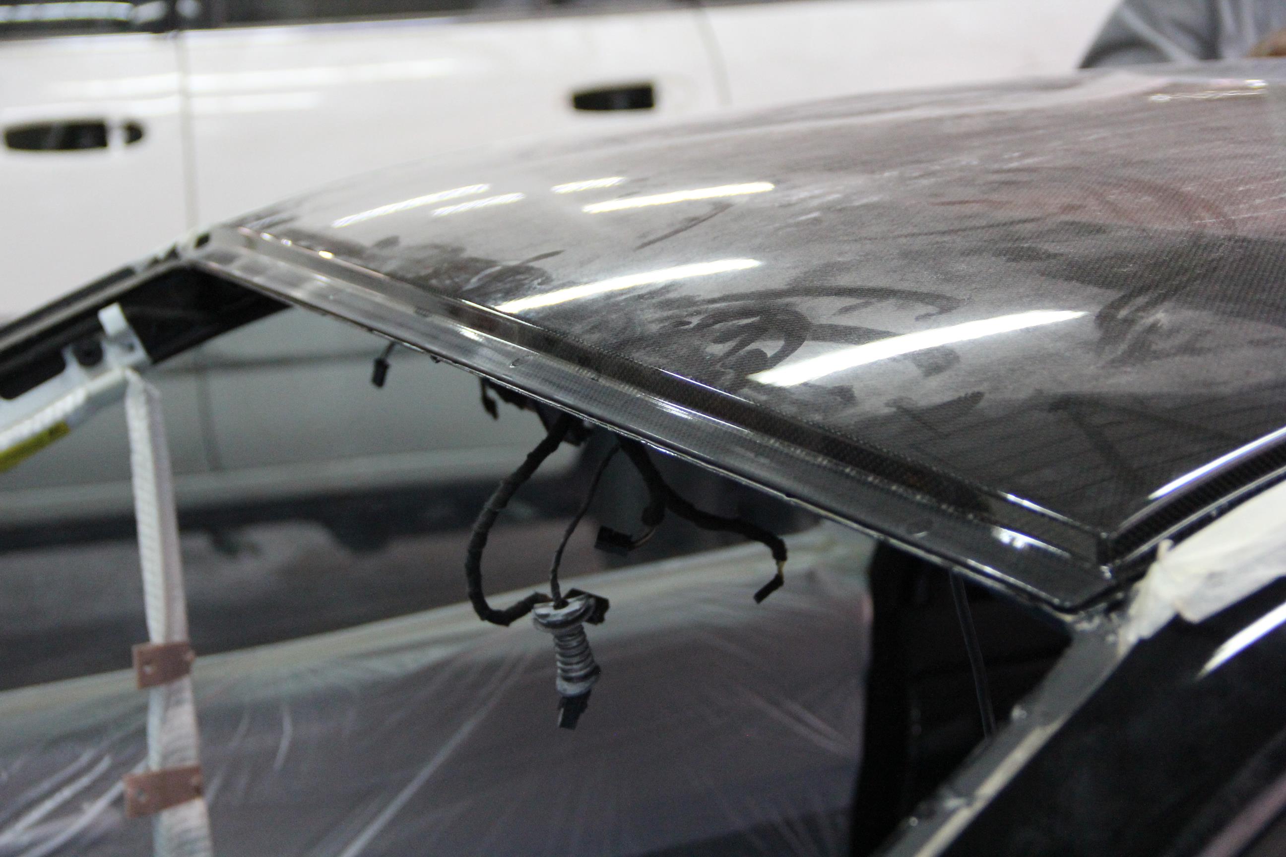

Then the roof becomes one with the car.....
Interior goes in tomorrow after the cars had about 24 hours of no moving etc. Wheels wont be painted this time but will get them done in a few weeks.
