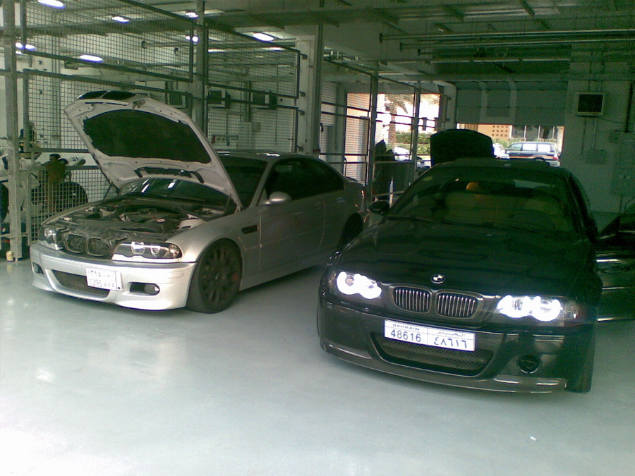

Hey Guys i had a day off on tuesday cos of Veterans Day so decided to head on over to Ultimate BMW Garage and get some parts fitted that i had lying around. I got there and they were already waiting for me with a vacant lift. The parts being installed today:
Rogue Engineering SPORT Adjustable Rear Control Arms (ARCA)
GSP Pedal Set (SMG) Gen 3
Changing Diff oil
Removing AP Exhaust
Installing OEM Exhaust
The RE ARCAs went on easily enough without needing to losen the diff. Just remove the rear anti roll bar and remove the drive shafts from the diff and they go on easy enough.
The Exhaust came off in a few minutes and the OEM went on easy enough. The reason i switched back to the OEM muffler was cos the AP was a bit too loud for me. Dont get me the wrong the AP is an amazing exhaust and so light i didnt have any probs lifting it. The OEM exhaust on the other hand is so damn heavy it took 2 of us to lift it and fit it! Anyway i got the tips for the OEM muffler from James at Eurosportdesign and they should be on soon it looks nice and fat at the back
GSP Pedal Gen 3 hasnt gone on yet, it will be going tomorrow and everyone was drooling all over it..... so will update the thread with the installed pics tomorrow.
The diff oil was still pretty good after 14000 km but changed it any way as we had already opened the drain plug! I know now the oil can last easily up to 25000km. Also while we doing this my mechanic asked me to get diff bushes.
Also checked on the drive shaft coupling and looks a bit cracked so will be ordering one soon from TISCHER along with the Diff bushes.
Ok here are the pics guys.......

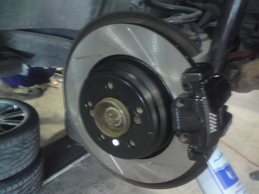

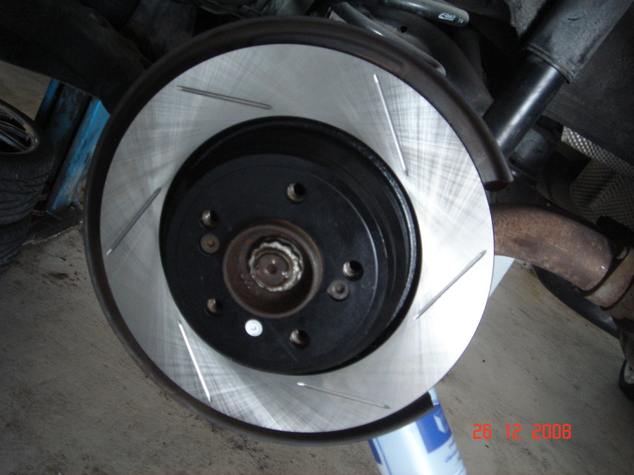

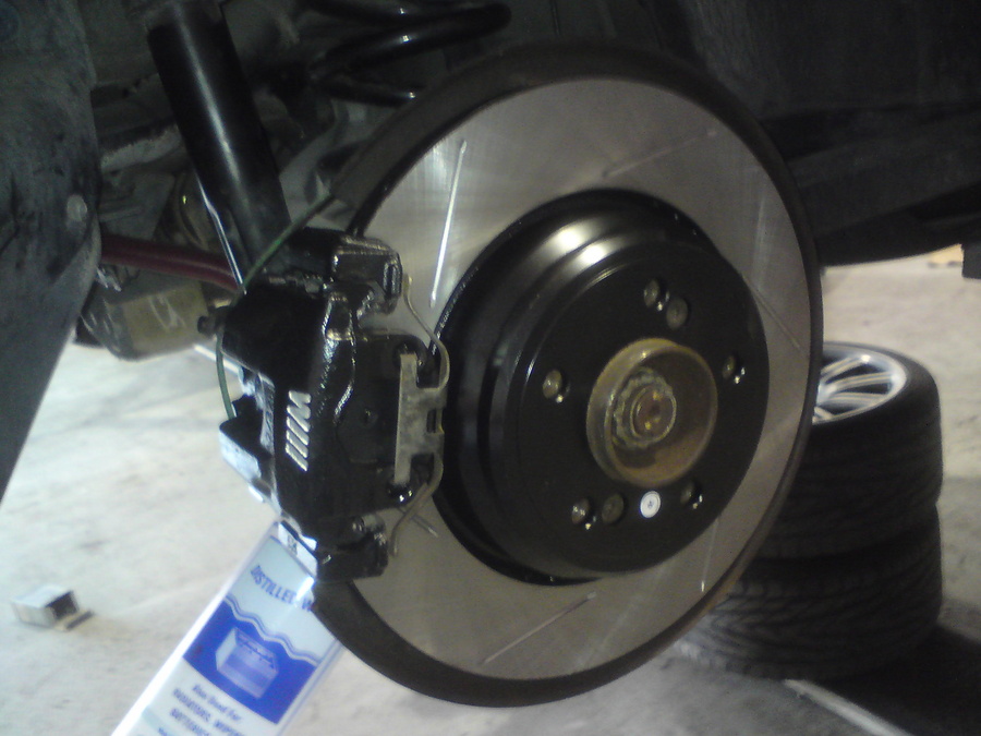

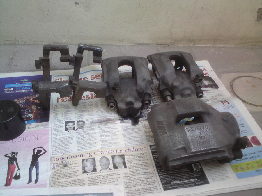

Hey all, Havent updated for a while so thought i would. Well after installing the steering wheel i knew i would have to change all rotors and pads pretty soon as we inspected them while we were standing there having the steering installed.
I really wanted to go for 6 pot BBKs up front but cos of other plans decided to go for the STOPTECH STAGE 2 Brake upgrade. This includes 4 slotted rotors, Pads of your choice (I went for full race Ferodo DS2500), braided brake hoses, 3 bottle of MOTUL RBF Brake fluid. It is a Bargain!

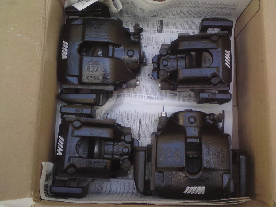

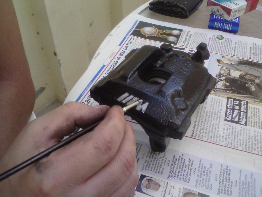

In the same time i painted my OEM Brake calipers as well. The OEM M3 E46 calipers are iron cast so they start to look kinda rusty after a while. Me and My cuz from Romania first of all started by remocing the calipers off the car completely and then rubbing them down. After cleaning them and rubbing them down we applied 2 coats of Black Brake Caliper Paint and used OEM BMW TIag paint for the M logos cast into the calipers. The results are a cleaner look and so fresh! So much better than the OEM IRON CAST Look!

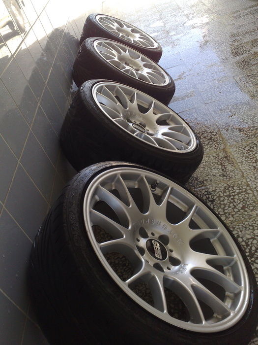

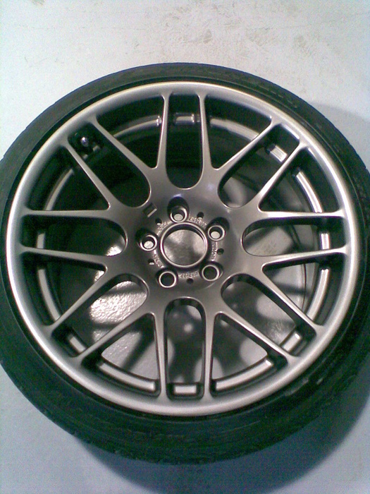

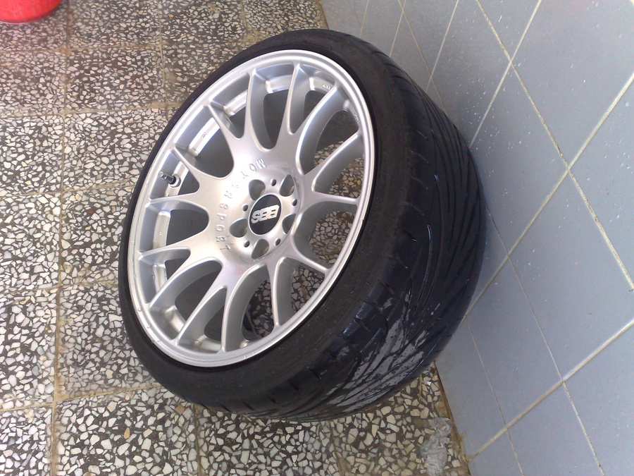

I also bought a set of used BBS CHs in 19 staggered from a close friend in Qatar. I also got a set of ZCP/CSL Wheels custom painted in a lambo gun metal grey by my friend JASON in Kuwait. Cant wait for both sets of wheels to get here......
Next up (finances permitting) will be a surprise OEM mod i have been waiting for a long time and Kw V2s
Enjoy the pics fellas...........
