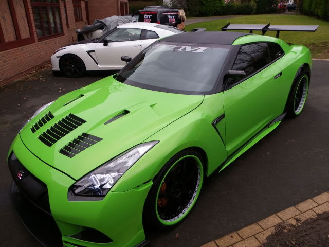

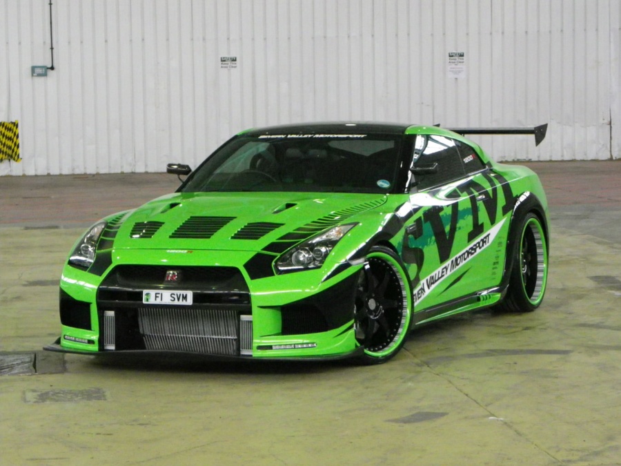

Severn Valley Motorsport Nissan GT-R "The Hulk"
I want to share this +1,200 hp monster with you guys. Capable of blasting along a quarter mile in just 8.97 seconds with a ridiculous top speed of 216.9 mph. Probably the fastest GTR.
Specs:
Engine
  • SVM HULK Spec Forged Blueprinted Unit 4.2L
  • 92.4 Billet Greddy Crankshaft assembly & boost logic Crank damper/ rotating mass dynamically balanced
  • 98mm Darton modular Integrated deck system (wet liners)
  • SVM specification longer Carrillo connecting rods
  • SVM Custom CP Comp Pistons & Higher Quality wrist pins & ARP bolts
  • ARP L19 Head Extra high Strength Bolts
  • Ferrera Valve Package with larger inlet and exhaust valves and titanium retainers
  • Tomie 280 Profile cams with 11.3 lift
  • CNC 5 angled valve pockets and CNC Balanced Porting
  • Ported and Matched Inlet Manifolds
  • GTC Billet winged engine sump
  • HKS 45ml colder spark plugs
  • Okada plasma Direct coil packs
Induction
  • Large Greddy Throttle housings (awaiting first delivery from Greddy)
  • Greddy modified steel manifolds/modified with v bands couplings & SVM support system
  • GTX GT35 Garrett Turbo Chargers with ball bearing core assemblies & V Band Fitment
  • Tial 44mm external waste gates V Band Fitment
  • Custom 80mm down pipes Zercoated
  • 80mm hard pipe kit with SVM Green pipe couplers and murray hose clamps
  • 80mm MAF pies with HPX MAF sensors
  • HKS Blow off Valves
  • GTC 102mm Titanium Exhaust system with 102mm GTC Y pipe fully resonated
  • KN High flow air filter system with ram pipes & 90mm intakes
Cooling
  • Martons lightweight Aerospace bar and plate intercooler (only one of two ever made for an R35 GTR)
  • Radtec high capacity engine and gearbox radiators housed into bumper
  • Radtec alloy power steering reservoir
  • Radtec water high pressure header tank and combi cam breathers with braided lines
  • Radtec Race Spec radiator
  • Radtec central block breather catch tank
  • GTC water hoses and ECU Rad program
  • 65 deg thermostat and housing
Fueling
  • 1600 ID Injectors High flow injectors
  • Billet 12mm fuel rails with twin Dash 8 fuel lines
  • Triple 1200bhp SVM Designed fuel pump system with swirl pot
  • Fuel lab fuel regulator with braided lines
Engine Detailing
  • Mines carbon engine cover
  • Carbon battery and brake servo cover
  • Titek carbon cooling panel
  • Hulk imperial pearlescent color coded 1200bhp engine with specialist detailing
  • Color Coding of various parts
Transmission
  • Albins 1st to 6th Gear set kit Uprated & High Strength
  • GTC 14 plate clutch system
  • Upgraded 4wd Gearlock system
  • Uprated Diff’s
  • SVM gearbox cooler kit with additional fan and thermal control/motul pump and braided lines
  • GTC Billet gearbox high capacity oil pan
  • SVM synthetic 13lts duel clutch oil
  • Shell helix racing oils
Chassis
  • KW coil overs Variant 3
  • KW club sport suspension with alloy top mountings
  • Eibach billet spacer pack with titanium wheel nuts
  • Eibach front and rear "hollow" light weight anti roll bars
  • GTC rose jointed top arms
  • 400mm Top Secret Big Brake conversion front and rear (This is only used for Road and track use not Drag)
Electronics
  • 45psi digital boost gauge
  • HKS AFR and knock meters with twin additional oxygen sensors
  • COBB ap with GTC steering wheel maps race and road fuels
  • COBB ap nis 06 upgrade with launch control
  • Willhall Racing shift light
  • All mapping by Ben linnley GTC (2 fuel maps: Road 99 ron Race fuel 120 ron)
Exterior
  • Complete inside out re-spray in metallic imperial green pearlescent, eleven coat system & sponsors decals
  • Top racing carbon racing front bumper (part painted)
  • GTC Carbon bonnet (part painted) gold heat protection
  • Top Secret carbon gas bonnet lifts
  • Top Secret Front Towing eye for Track use.
  • Aeromotion’s S2 Active split wing
  • WALD Rear carbon diffusers
  • WALD side skirts (painted black and green))
  • WALD rear arch extensions (painted black)
  • GTC carbon boot lid
  • GTC Carbon Race mirrors mounted on pillars
  • Carbon exhaust surrounds
  • Carbon/Black wrapped roof
  • MCR front and rear side markers
  • L.E.D front and rear GTR badges
  • L.E.D angle eye day light running lights
  • LSD doors
  • Privacy Glass
Wheels & Tires
3 sets of wheels and tires - show/road/track:
Show:
22" i forged carbon coated show wheels/ green pin stripe / bar code graphics
22" Pirelli Tyre package. R 295/25/22 F 265/30/22
Road/Track:
20" Volks Racing light weight wheels Toyo R888 315/30/20 tires
Track:
18" Rota drag wheels with hossier non expanding drag tires
Interior
  • Cobra front carbon ultra light race seats / technology foam /alcantara fabrics & Custom Logo’s
  • 6 point Roll Cage Custom built to SVM Spec with removable bars
  • TAKATA 4 point race harnesses
  • Full carbon interior package ( 12 piece kit) inc Carbon rear speaker shelf
