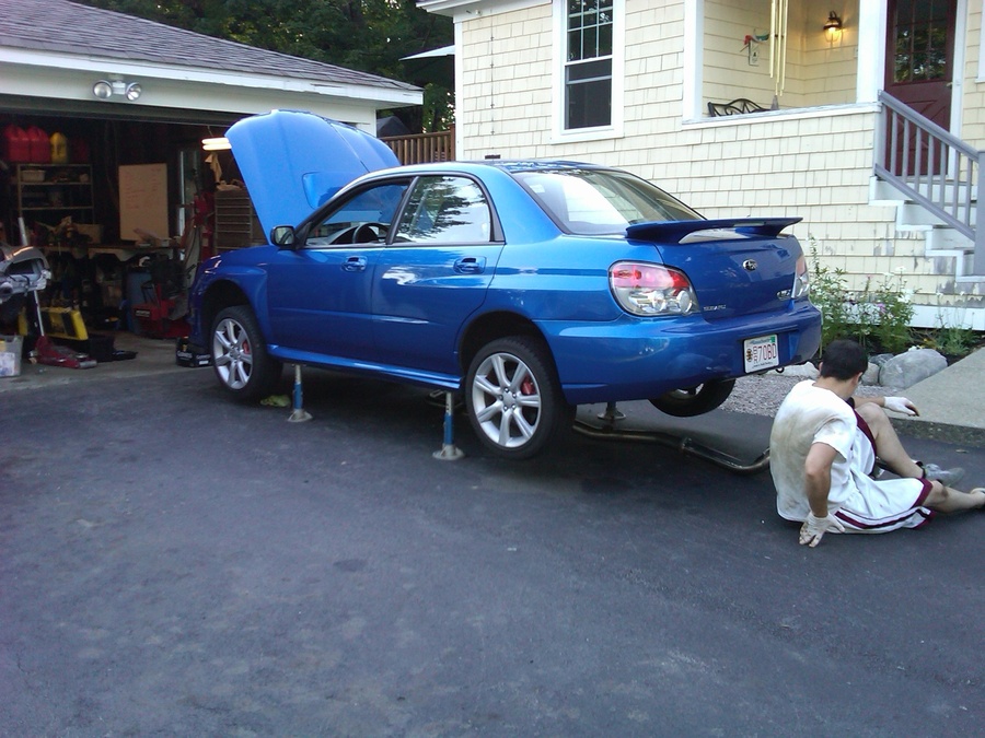

So after pressure testing it and taking it out for a beat run my buddy and I found the problem. Gasket went on the up-pipe, which explains why I'm losing boost. So Friday after work I'm getting a 30 rack and my friend, his brother, and I will fix it. Hopefully next week the springs will be installed.

Car is fixed. Runs like a bat out of hell. Downpipe is knocking against the tranny crossmember, I'll put it up on the lift tomorrow and fix it. Springs will be put on hopefully next week.

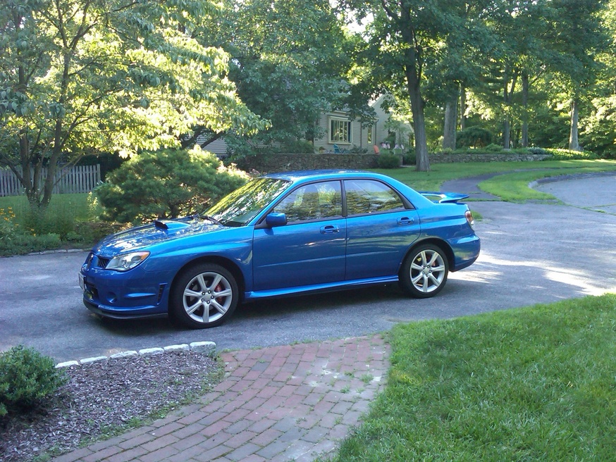

After a wash
