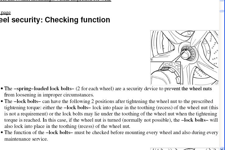

found the answer, figured id post it up if it helps anyone else...
The −spring−loaded lock bolts− (2 for each wheel) are a security device to prevent the wheel nuts
from loosening in improper circumstances.
The −lock bolts− can have the following 2 positions after tightening the wheel nut to the prescribed
tightening torque: either the −lock bolts− lock into place in the toothing (recess) of the wheel nut (this
is not a requirement) or the lock bolts may lie under the toothing of the wheel nut when the tightening
torque is reached. In this case, if the wheel nut is turned (normally not possible), the −lock bolts− will
also lock into place in the toothing (recess) of the wheel nut.
The function of the −lock bolts− must be checked before mounting every wheel and also during every
maintenance service.
