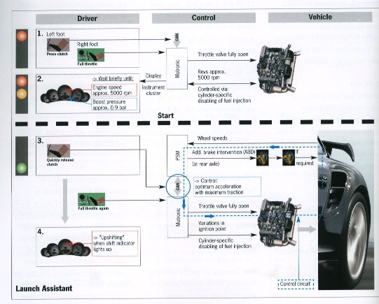

GT2 Launch Control Explanation pics
Old Feb 15, 2008 | 08:58 AM
SpeedMaster's Avatar
Posts: 5
SpeedMaster is an unknown quantity at this point
Post GT2 Launch Control Explanation pics
Little complicated to say the least!

Is there a link I can blow up? Hard to read.

Hurting my eyes trying to read it lol!!

Hello everyone,
First post here. Anyway, this is taken from the Porsche GT2 Dealer Demo video. At around 6:38 on the vid, the narrator states that:
- "This is the first time that Launch Assistant is used on a road going Porsche"
- "A system designed to maximize acceleration from a standing start."
- "To activate the function, simply depress the clutch and accelerator pedals when the vehicle is at rest."
- "When the boost pressure rises to approximately 0.9 bar, release the clutch as quickly as possible... and forget everything you thought you knew about propulsion "
- "Traction is maintained under acceleration with the aid of a all new anti-slip regulation function."
- "Wheelspin is controlled via the engine management system, thereby avoiding unnecessary clutch wear."
