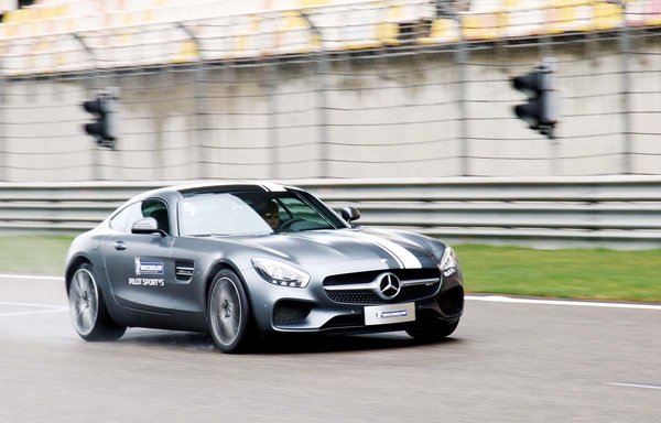

Michelin Pilot Sport 4 S vs. Michelin Pilot Super Sport
... Pilot Sport 4 S high performance sports tire
Workshop 2: Test car: AMG GT S (4.0 L V8 510 hp)
Front 255/35ZR19 Rear 295/35ZR20 - Michelin Pilot Sport 4 S
Dry: 100 --> 0 km/h ... 1,08 m better than PSS
Wet: 80 --> 0 km/h .... 1,05 m better than PSS
Lap Time - 2600 m track - 0,16 sec better than PSS
Results: German TÜV SÜD and DEKRA Test Center.
