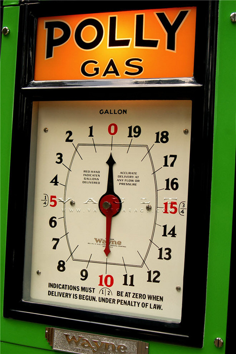

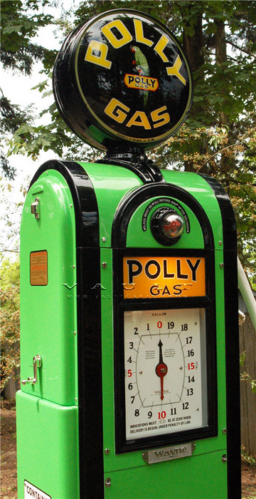

VAULT just completed a meticulous concourse-quality restoration of a circa 1937 Wayne Model 866 gas pump back to its original factory appearance and condition.
Every detail of this pump was accurately, and faithfully, reproduced to the highest level of quality to preserve its historical distinguishing characteristics, content, and vintage “factory correct” appearance. This is one of the finest gas pumps in existence restored in one of the most desirable, and striking, gasoline brands (Polly Gas). Information about the Wayne Company and this particular model is at the very bottom of this description.

Factory Correct Parts - All parts have been expertly restored with identical reproduction or NOS replacement parts to make your gas pump appear new from its shipping crate. All missing or damaged parts were replaced with identical replacement parts.
Sanding & Filling – All exterior parts of the gas pump were restored to achieve surfaces as close to original contours as possible without any pitting or surface imperfections. Catalyzed plastic filler was used to smooth out minor (one-eighth or less) imperfections and sanded so that all panels have a straight, mirror surface.
Priming - A two-coat primer was used beginning with a catalyzed polyester self-etching primer. After this first coat, all minute imperfections were block sanded as successively finer grits of abrasive are used ending in 320 before the final priming and then color painting was applied.
Base Coat/Clear Coat Paint - Vault specifies a premium best base/clear coat system to achieve a concourse-quality paint job. All colors are matched against factory mint original gas pumps, company literature and manuals. Many pumps that are restored do not pay attention to factory colors. This pump was historically accurate to original colors and paint schemes.
Finishing - To achieve a concourse paint appearance to showroom quality standards all exterior parts and panels were wet sanded and hand buffed to eliminate “orange peel" and dust particles in the paint surface. This renders the painted surface of your pump flatter than the applied paint can be achieved naturally and enhances the final beauty of the pump.
Re-Assembly – All parts that were removed were individually restored and reattached. Each part, even each fastener, were re-conditioned from functional to museum quality. All trim was polished and plated in triple nickel plating. Original fasteners were either re-plated or replaced.
Historically Accurate Details/Factory Correct Parts - Here are some examples of how Vault pays attention to quality details:
• Fasteners - Factory correct fasteners made from brass and nickel are 10X-15X the cost of zinc-plated screws
but this small detail makes an aesthetic difference in the presentation of this pump.
• Advertising Globe – Most restorers will skimp on their restorations by using a plastic globe holder, when
originally pumps were outfitted with metal globe bodies which is what Vault uses.
• Metal Parts –Where the stainless was missing or damaged beyond repair, Vault replaced these parts with real
nickel-plated metal and reattached them using threaded shafts and fasteners. No “plastic nickel plate” or
“stick-on metal or aluminum” parts were used in the restoration of this pump.
• Show Chrome on All External Metal Parts - Chrome plating is hardly a matter of dipping a piece of metal into a tank, but rather a long involved process that often starts with tedious polishing and buffing, then cleaning and acid dipping, zincating (if the part is aluminum), and copper plating. For top reflectivity, Vault uses "Show Chrome", which further includes buffing of the copper for perfect smoothness, cleaning and acid dipping again, and plating more copper, then two or three different types of nickel plating, all before the chrome plating is done. Rinsing is required between every step. The end result is concourse quality plating.

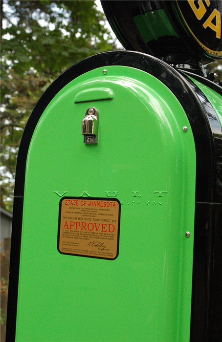

• Signage - No vinyl lettering or logo’s were used in the restoration process because it is not historically correct to the gas pump. The exterior shell of your pump was restored back to its original state with water glass decals only. All signage is screened in factory correct sizes and colors using factory correct procedures. Only factory correct brass ID badging and warning signs are used and these are even engraved with the original serial
number of this particular pump so that its history can be retained. Even a ‘Department of Weights and Measures’ decal was replicated to authenticate the pump as certified accurate.
• White Cloth Hose – Although white cloth hoses are more expensive than rubber hoses, Vault uses only original hose items, with chromed ends.

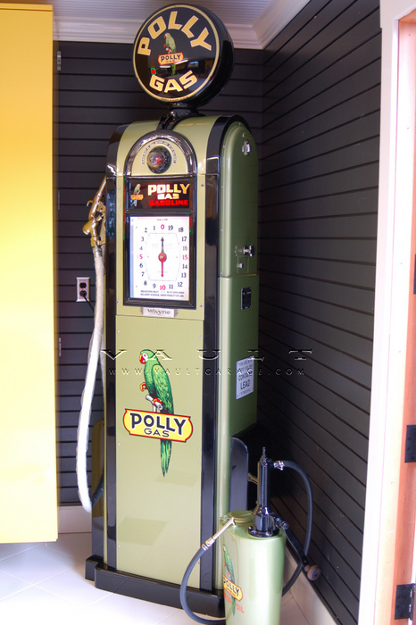

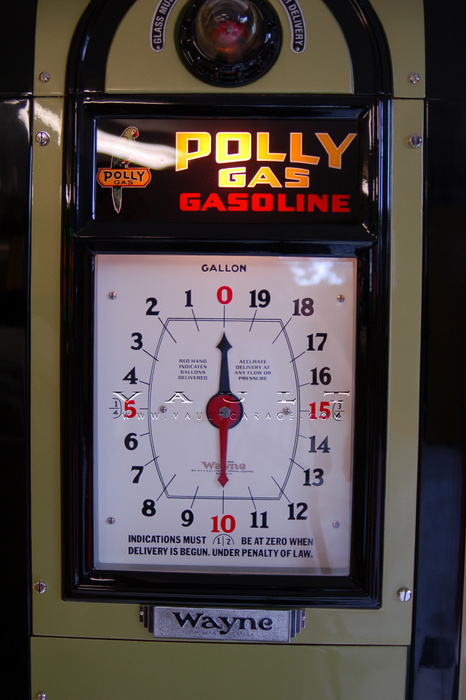

However, we have just completed the restoration of a second Wayne 866 gas pump, this time in a slightly different color configuration ... and I think the second one turned out even better!
