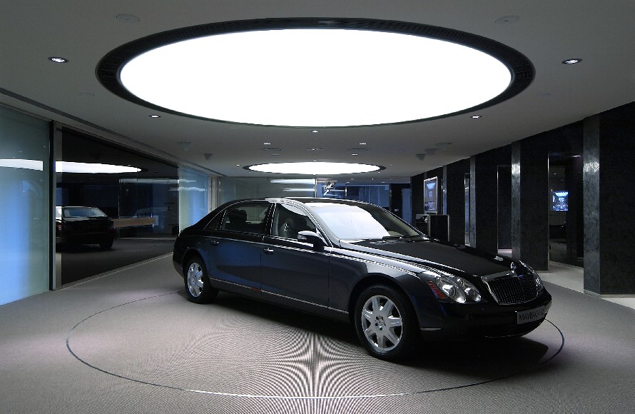

I'm interested to see how this turns out!!
Lighting like this would be awesome, even if the exterior is traditional.
