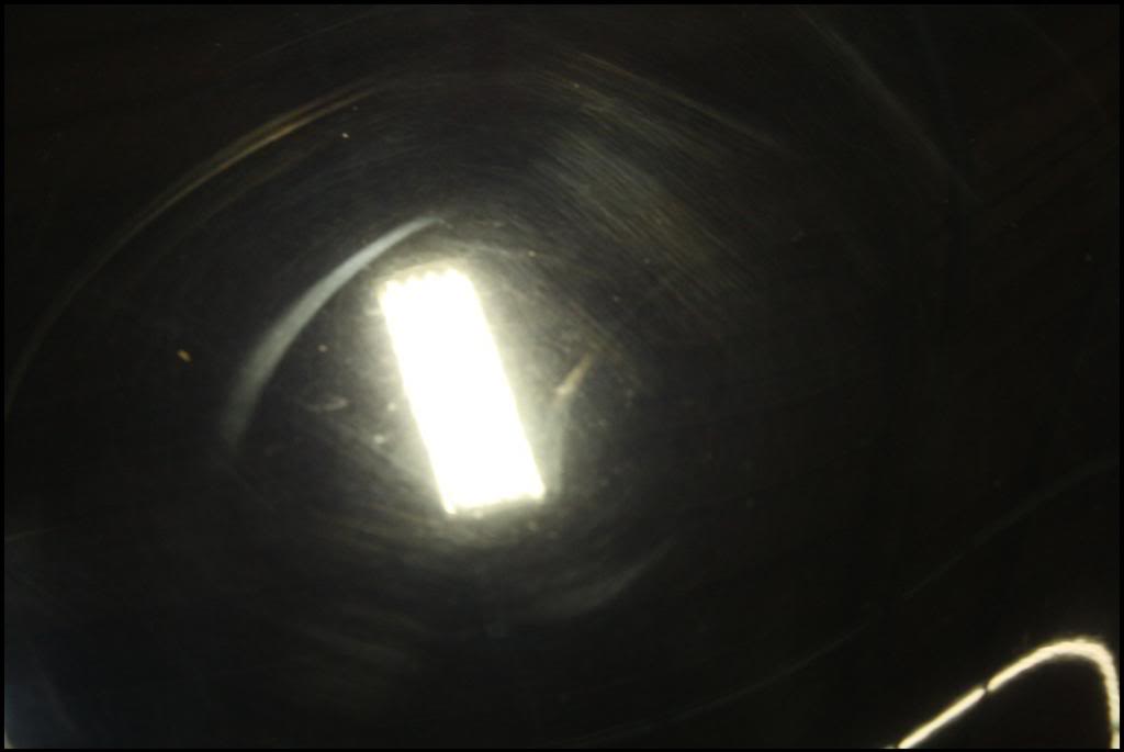

Paint correction process:
Decontaminate paint and windows with clay
Wipe paint with alcohol to remove clay lube residue
Tape off trim
Test section to figure out a process
Compound paint (once around)
Polish paint (once around)
Remove tape from trim
Clean trim
Clean paint
Wax paint/condition trim

Split shot before and afters from the two steps of correction:

Owner was very please with the final result of more corrected paint (90% scratches and swirl marks removed), and the immensely amplified gloss factor on this car! The color gleams with depth and wetness once it was completed! Its now ready to look better racing around the track!
