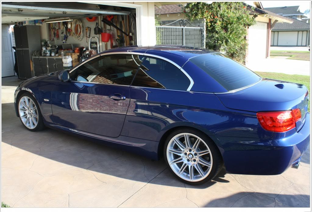

This client of mine called me up and was concerned about the long term protection of his car, no so much having the whole thing restored to a perfect condition. We went over some options and decided on a one step process. Upon arrival, it was clear that a one step would not work out and I ended up doing a very in depth two step on the car to remove about 90-95% defects from the paint. This really amped the gloss ten fold, and made the paint more clear to the eye! When you remove the swirls and scratches from the paint, you allow more depth, gloss, clarity to show! At the end of all the polishing, I ended up using carpro erasure to remove the polishing oils and leave the surface bare and ready for longer lasting protection…opticoat! This is an actual coating rather than just a sealant wax which will provide longer lasting, more durable, more scratch resistant protection to the paint…exactly what the client was looking for in the end!

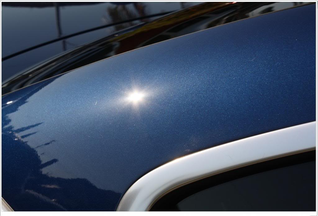

Starting off condition:

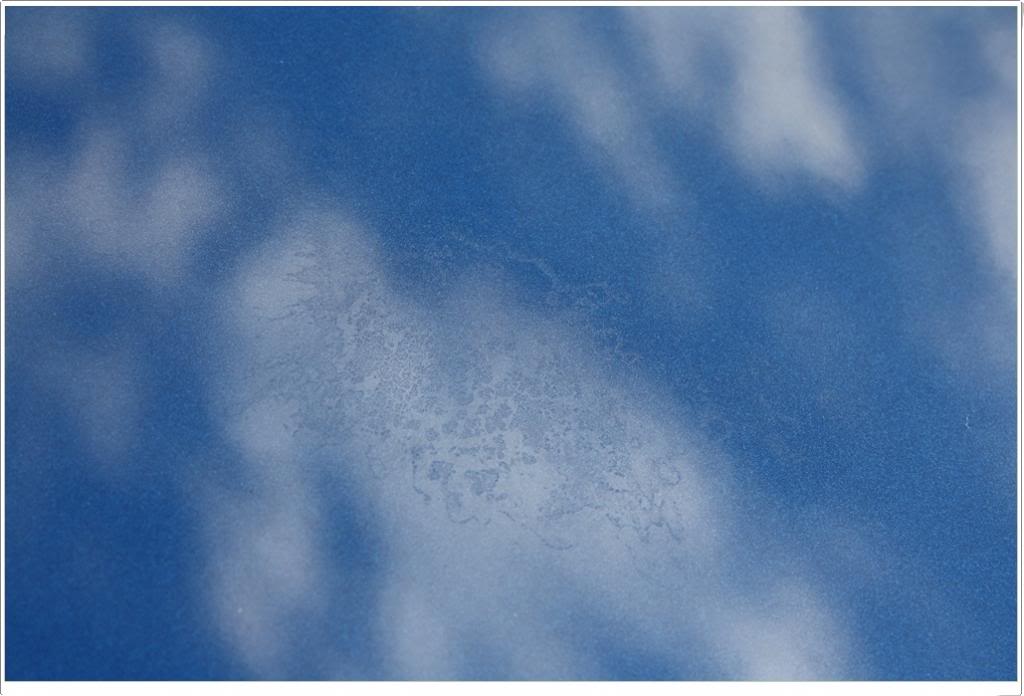

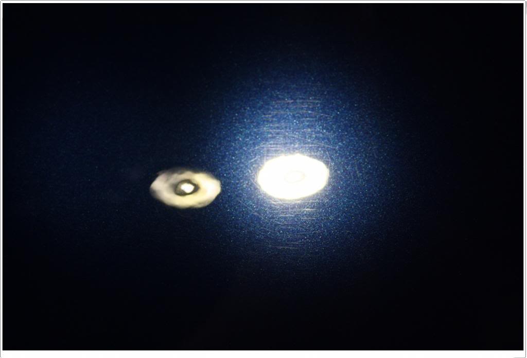

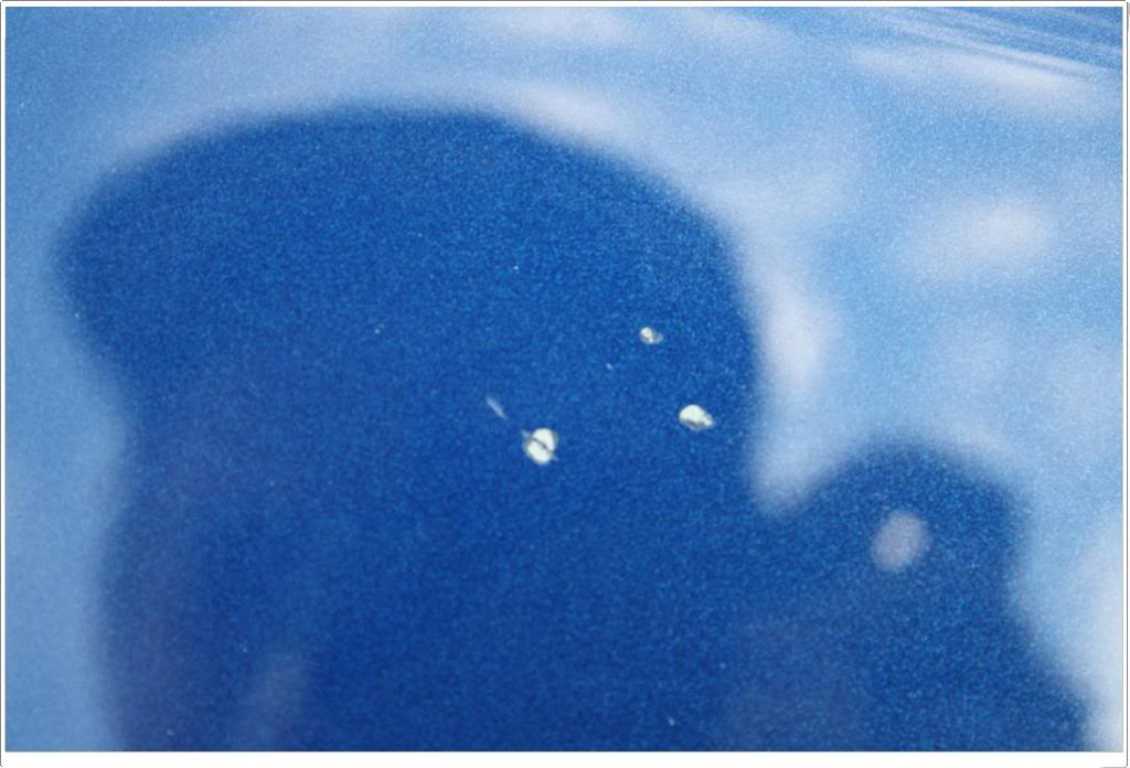

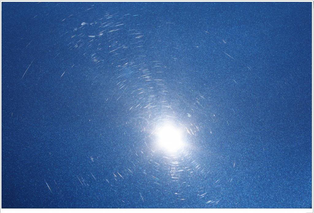

This specific spot, as well as two others, had bird dropping etchings that needed a more aggressive approach to remove

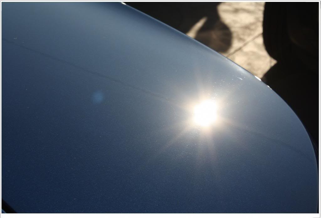

Ended up touching up a few spots around the car

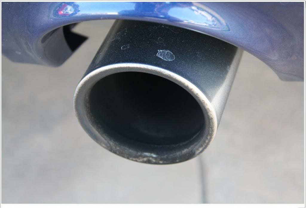

Exhaust tips were cleaned up with chemical guys metal shine

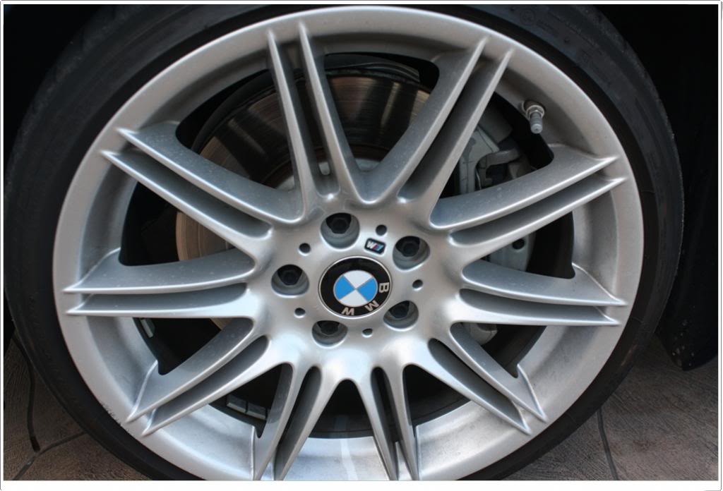

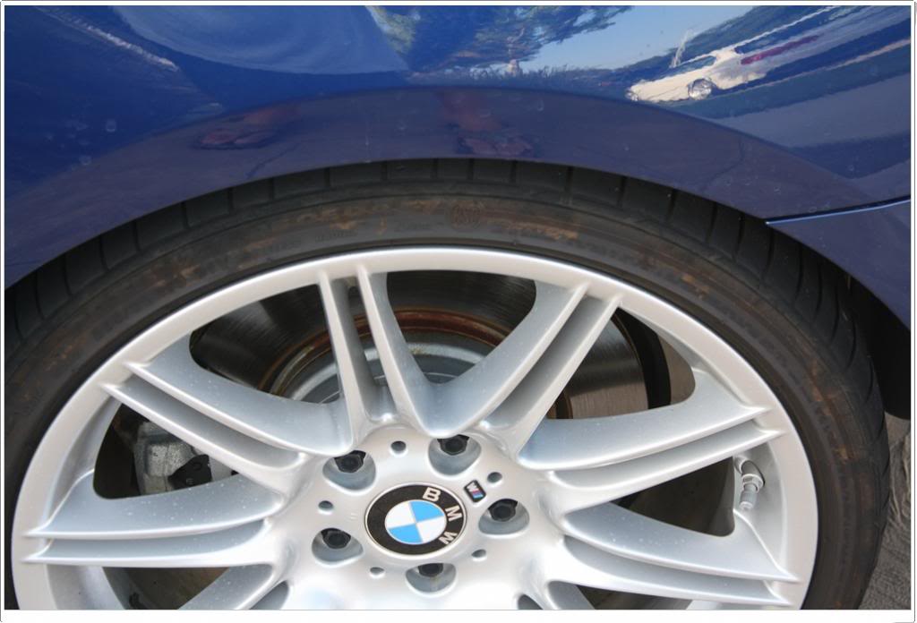

Tires degreased with meguairs degreaser and brush, then pressure washed off

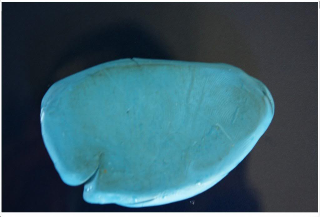

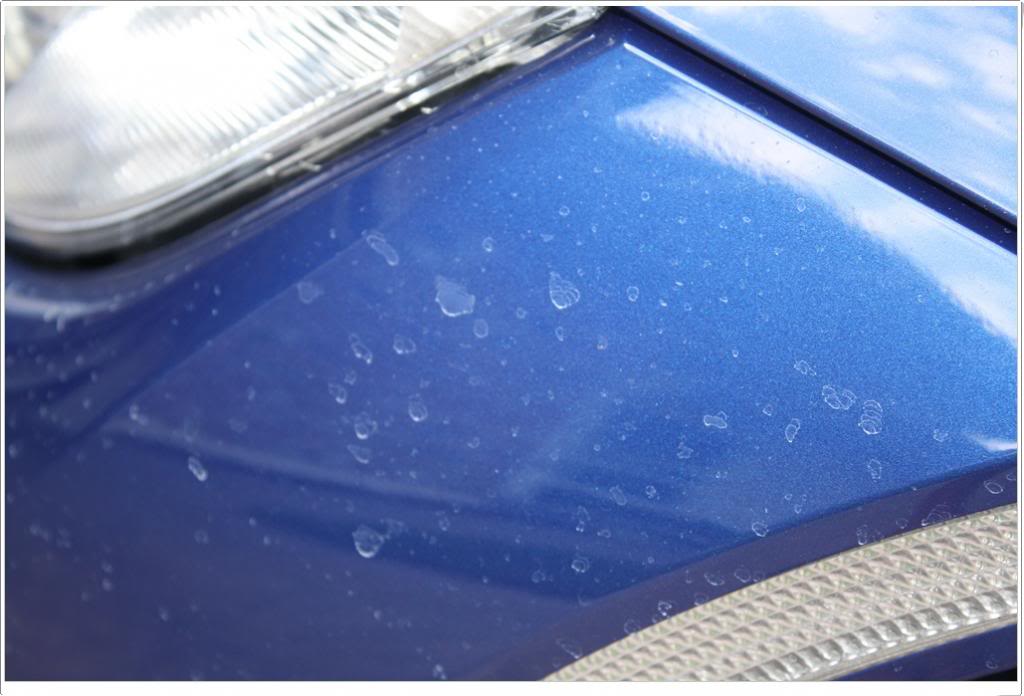

Detailed image clay bar removed quite a bit of contaminants…used ONR for clay lube

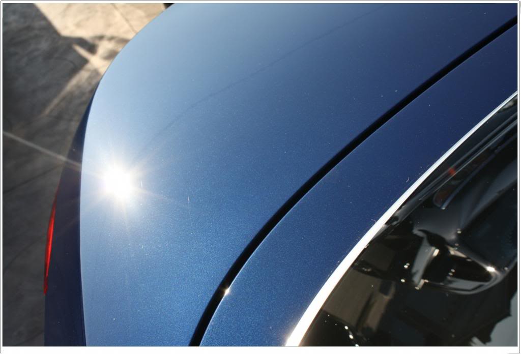

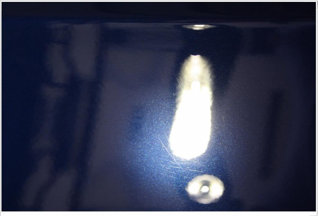

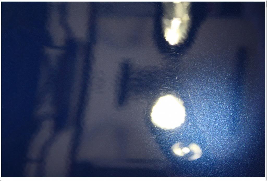

Pre-polishing condition around the car

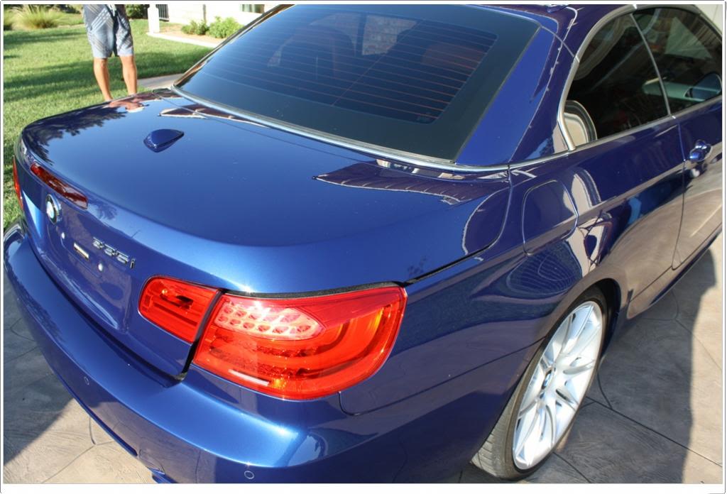

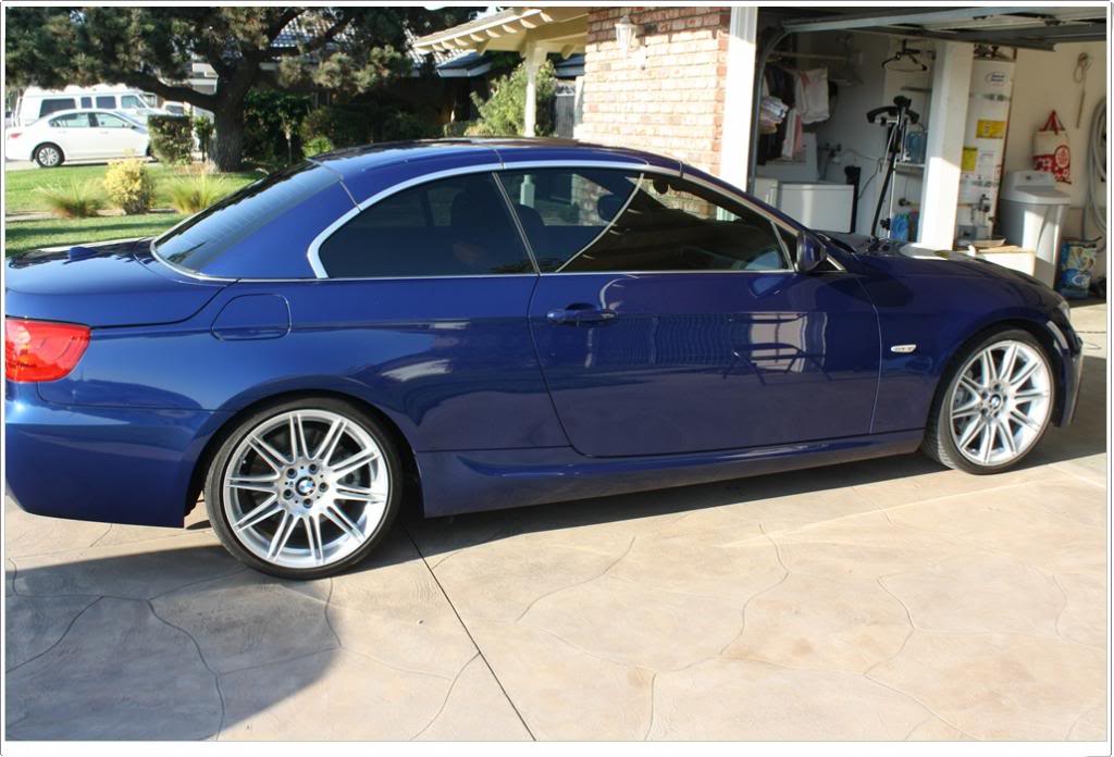

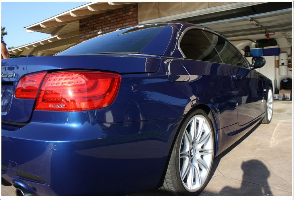

And the after shots BEFORE the opticoat application. I knew I wasn’t going to be able to finish in time to get good after shots, so I decided to pull it out after I was done polishing.
