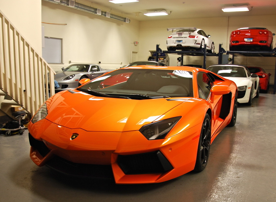

Great job!
His garage is unbelievable, this picture = brainfreeze
Name:  Lamborghini Aventador 28.jpg

Alef_henriique's Avatar
Joined: Aug 2011
Posts: 1,980
I think this garage belongs to a member of here.
Old Jan 11, 2012 | 04:50 PM
POWERHOUSE's Avatar
Posts: 2,527
^Ya think?
Old Jan 11, 2012 | 04:51 PM
Winchm60's Avatar
Posts: 2,311
Great stuff; LOVE the garage pic as well!!!

As if the title didn't make it obvious enough

No shit sherlock!
