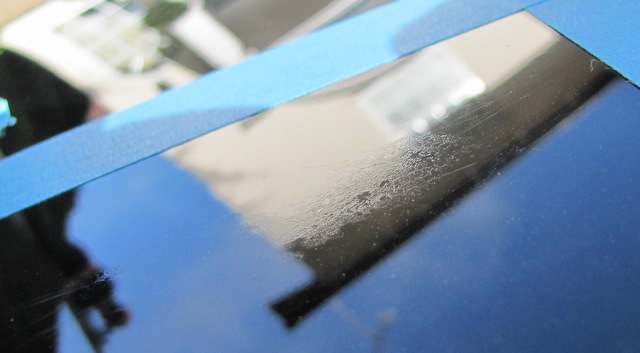

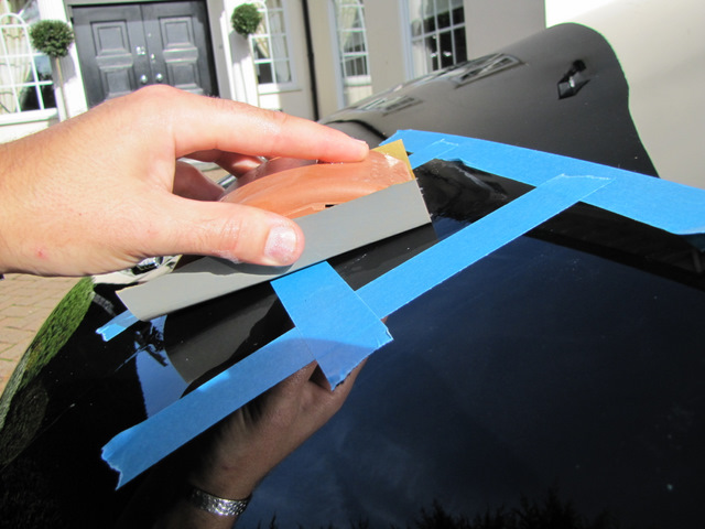

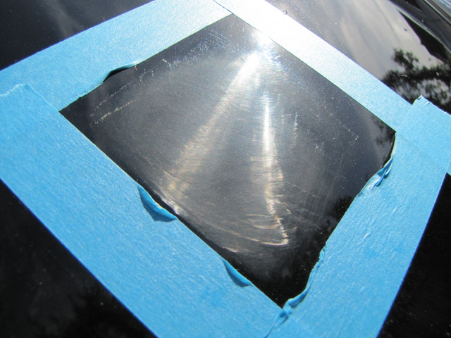

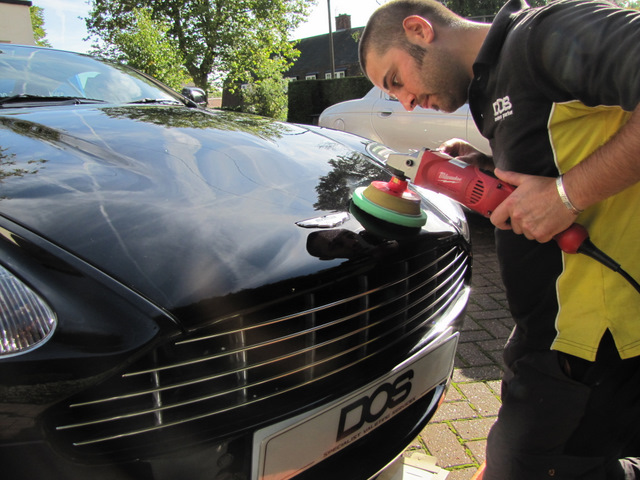

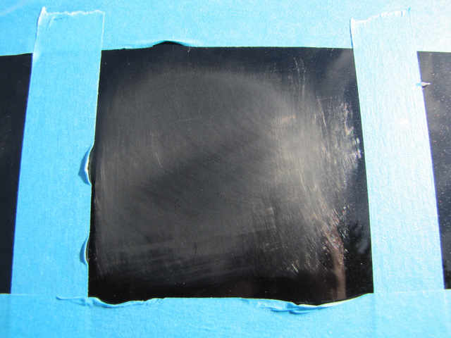

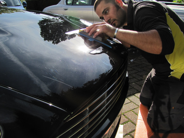

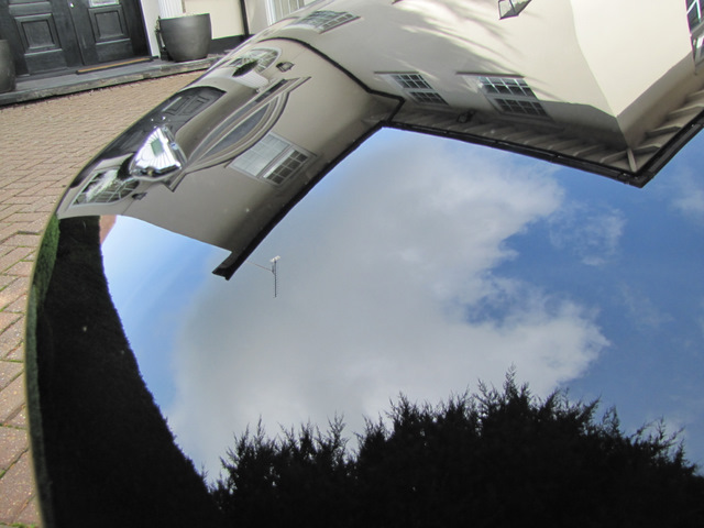

I was contacted to remove a bird lime stain on a bonnet of a black DB9 it had started to eat into the lacquer. The local dealer had a go at removing it with t-cut but it looked worse, i had to tape a section off and colour sand it with 3000 grit and componded it and polished it back to a flawless finish. The whole car was given a machine polish with 3m blue top.
