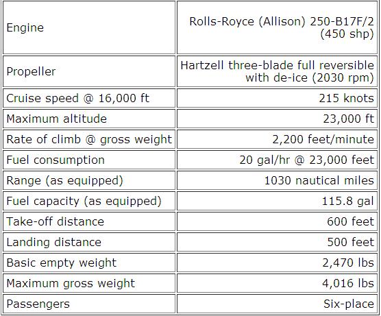

Modifying a standard Cessna Pressurized 210 airframe with the installation of a Rolls-Royce (Allison) 250-B17F/2 gas turbine engine, is only the first step in what results in a totally remanufactured aircraft, known as The Silver Eagle.

PERFORMANCE BOOST
With 45 percent more horsepower on take-off and climb, you will:
Cut 1/2 from the take-off distance
Shave the landing roll to a mere 500 feet
Climb to cruise altitude in only 8-10 minutes
Move speed from 169 Kts to above 216 Kts
Slice block times by an average of 20-30%
PAYLOAD INCREASE
By replacing the 510-pound Continental engine with the 205-lb. turbine, payload is immediately increased by 140 pounds, even AFTER taking into consideration the higher jet fuel weight, and other new systems.

Range takes a giant stride-from 760 NM to 1030 NM. A 27-gallon fuel tank is added as standard in the baggage area, extending useable fuel to 115 U.S. gals. This distance is accomplished at standard cruise, but powering back a few knots can move the range to well above 1200 NM ~ almost a 50% increase over the standard piston. Jet-A almost always costs less per mile than AvGas. Overseas, the cost savings can cut as much as 50% from fuel bills.
