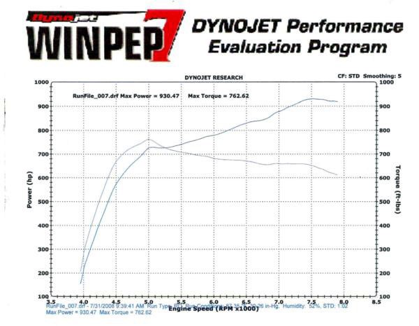

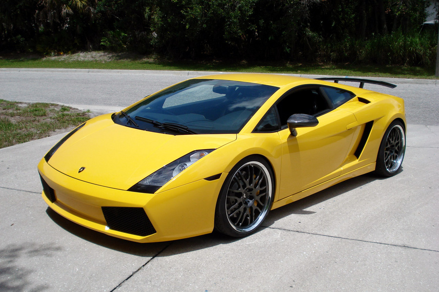

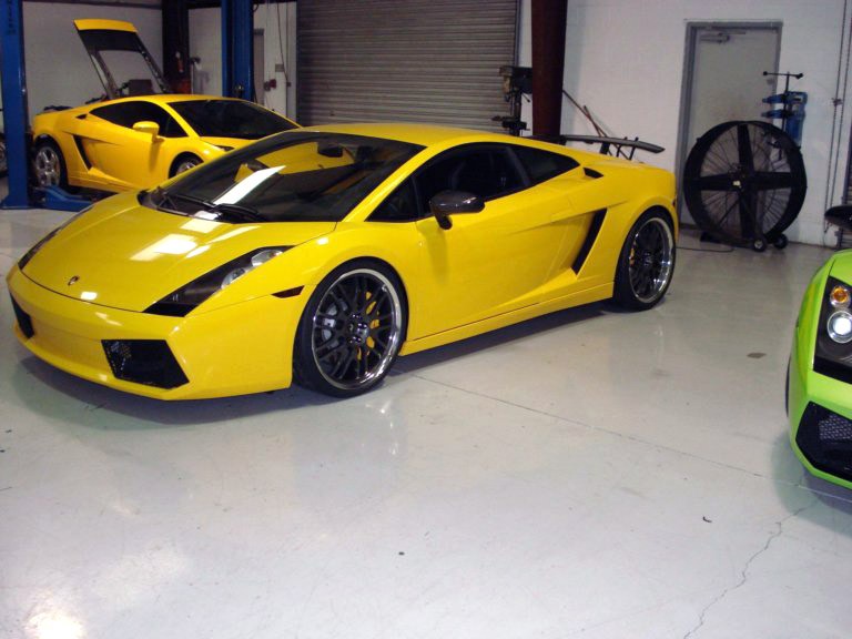

Jason Heffner is in the business of building fast cars. We're talking about quadruple digit horsepower, spinning the tires at 100 mph and pulling-away-from-a-Bugatti-Veyron fast cars. You might remember watching a Heffner-powered twin-turbo Ford GT that could hit 222 mph in the standing mile. His latest project is this twin-turbo Lamborghini that's putting down 930 horsepower and 762 lb-ft torque at the wheels. This particular owner also wanted to cut some weight, and added a carbon fiber deck lid and rear diffuser, race seats, and lightweight wheels. Autoblog

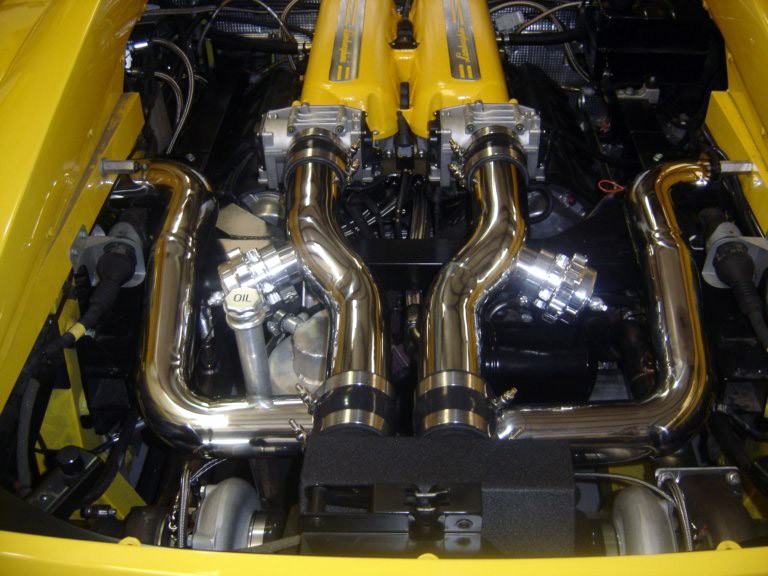

Heffner's Performance Twin-Turbo Lamborghini Gallardo features:
Engine removal and disassembly
Steel cylinder liners
Custom 9 to 1 compression ratio forged pistons
Polishing of crankshaft journals
Connecting rod bearings
Main bearings
Balancing of rotating assembly
Blueprinting and assembly of engine
Heavy duty clutch & pressure plate
Twin water cooled, dual ball bearing tubos
Two TIAL 38mm wastegates
Two TIAL 50mm blow off valves
Custom made stainless steel turbo mid pipes
Custom made stainless steel turbo downpipes & exhaust system
Stainless steel turbo oil feed lines
Stainless steel turbo oil drain lines
Colder heat range spark plugs
High flow turbo air inlet plumbing
High flow turbo air discharge plumbing
Spearco water to air intercooler
Intercooler water pump
Intercooler water reservoir
All necessary lines & fittings
High flow in tank fuel pumps
Upgraded fuel injectors
All necessary gaskets & fluids
Optimized fuel and spark calibration
Professional installation & tuning

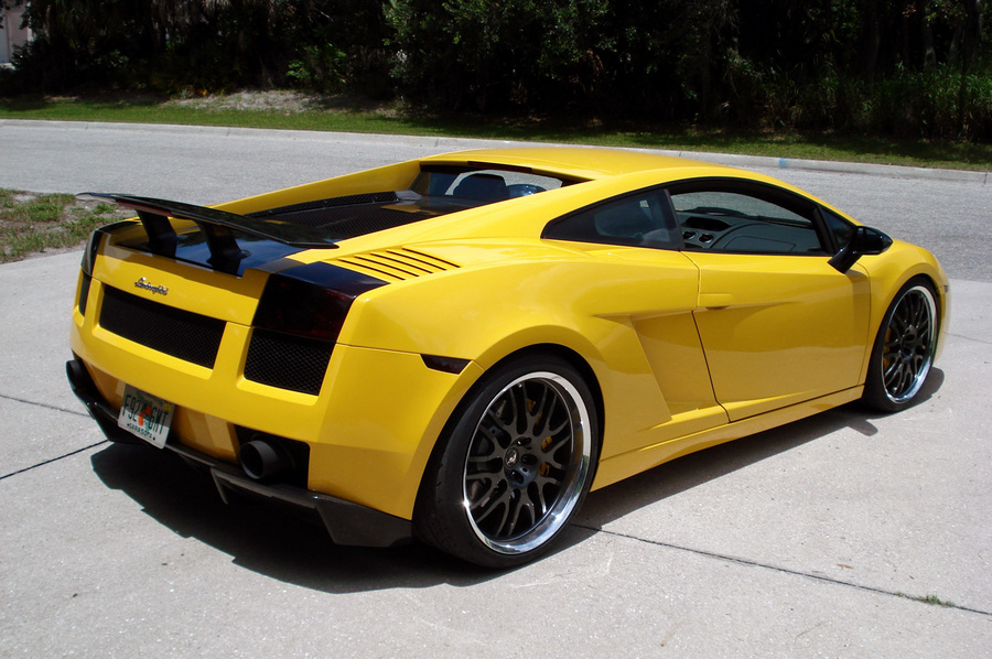

1 Carbon Fiber Rear Decklid
1 Superleggera Style Carbon Fiber Rear Diffuser
1 Superleggera Style Rear Spoiler

Is that just a gallardo or an SL? Either way thats one hot car! Would love to see some vids.

Just a normal Gallardo
