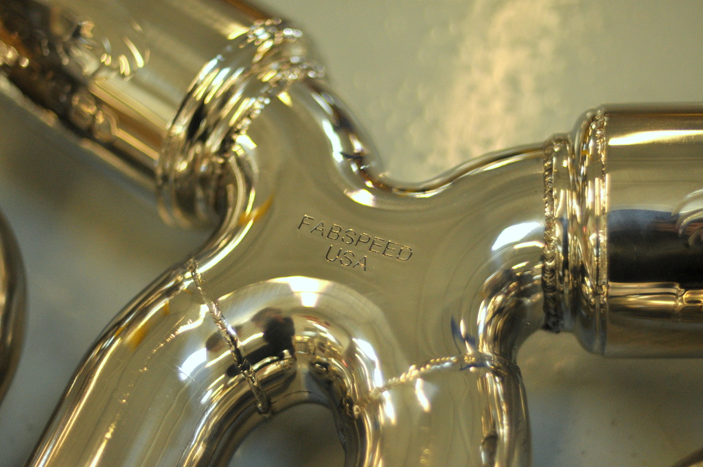

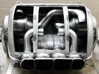

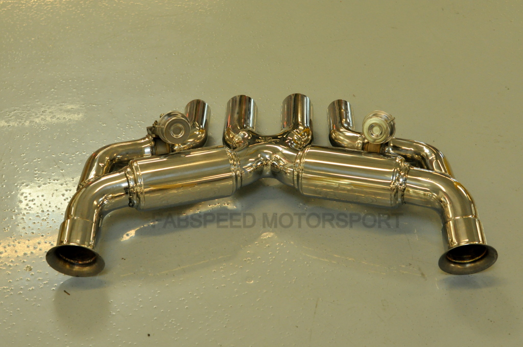

over the past month or so we have been developing and fabricating an exhaust for the LP700/Aventador. A good customer of ours sent us a stock exhaust to work off of and we are finally done! The setup saves 30lb off the rear of the car, has built in valves (that are controlled with a remote like our other valved exhausts), the full system is made of 14-16 gauge, C.N.C. mandrel bent T304 stainless steel tubing and is TIG welded by hand here at our shop in PA.
we don't have a video of the setup yet as we are still looking for a car to bring in to do the install on. As you can see from the cutaway of the stock exhaust, this setup will flow quite a bit better on top of saving a substantial amount of weight off the back of the car.
If an LP700 owner is interested in an exhaust system/dyno runs, let me know! the deal i would be offering you is almost too good NOT to take me up on.
cutaway of factory muffler compared to straight through design of Fabspeed x-pipe:

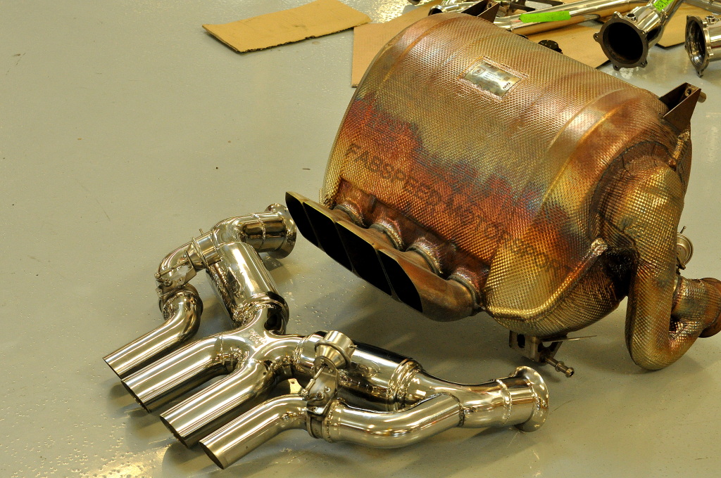

stock exhaust / Fabspeed exhaust comparison:

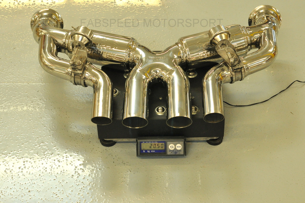

Fabspeed exhaust = 20.5lbs

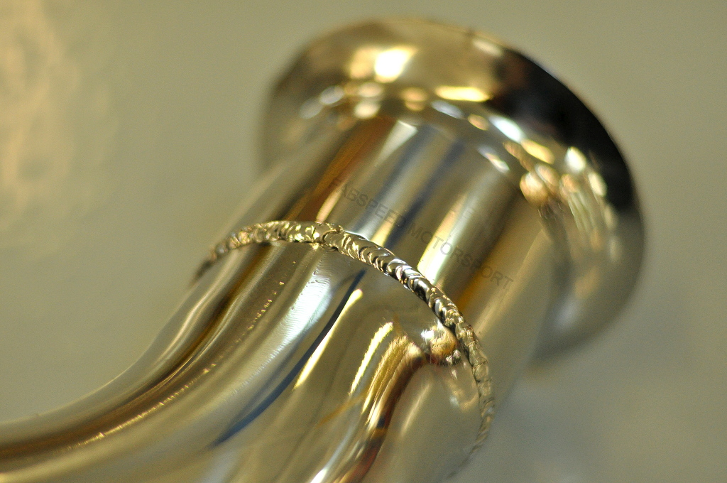

quality of the welds

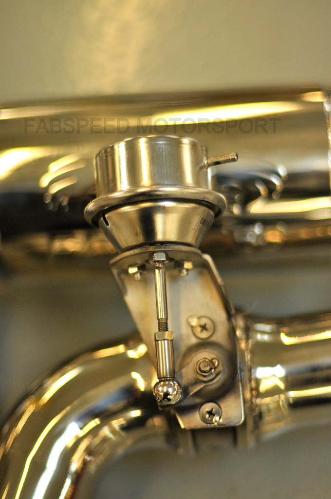

valves

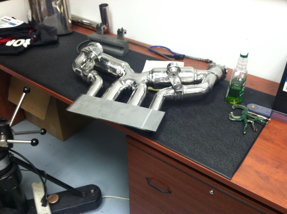

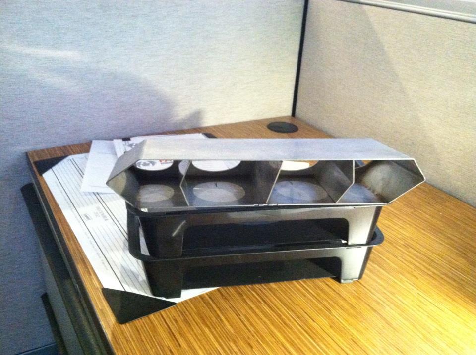

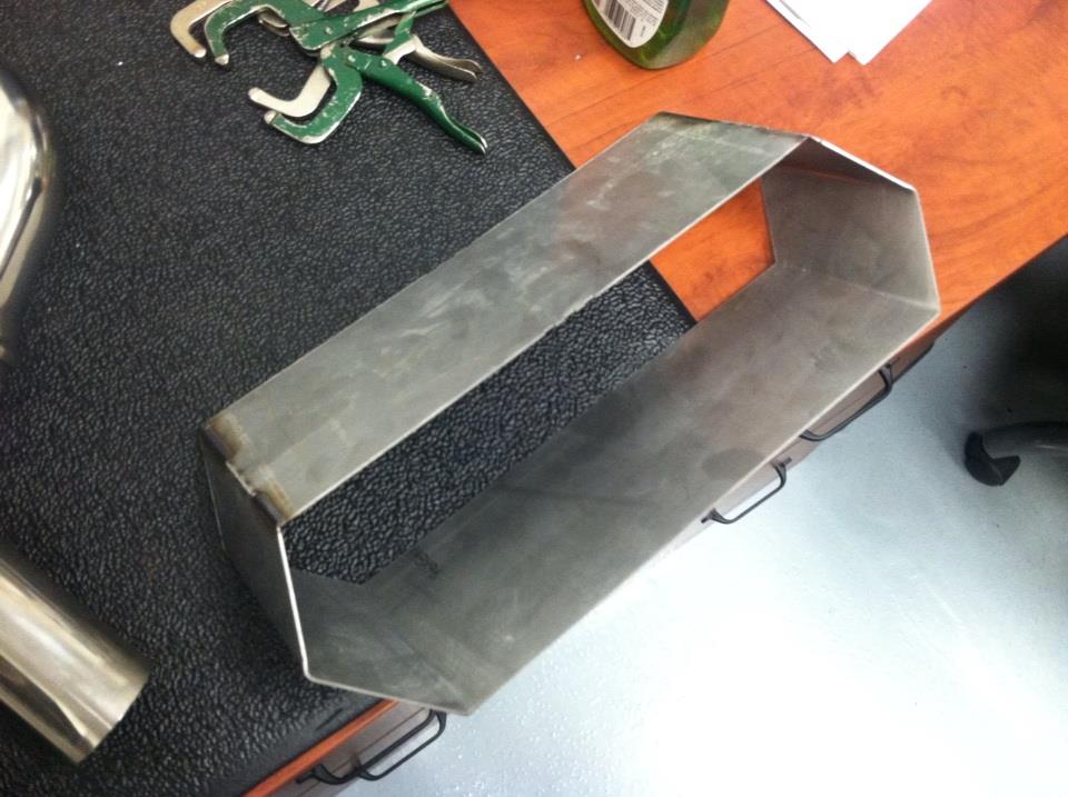

the final version of the tips will be like this:
