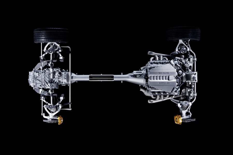

For the first time in the company's history stretching back over 40 years, the Mercedes-Benz performance brand is presenting a vehicle developed in-house, the Mercedes-Benz SLS AMG. The super sports car serves up an exciting proposition with its unique technology package: aluminium spaceframe body with gullwing doors, AMG 6.3-litre V8 front-mid engine developing 420 kW/571 hp peak output and dry sump lubrication, seven-speed dual-clutch transmission in a transaxle configuration and sports suspension with aluminium double wishbones. The ideal front/rear weight distribution of 48 to 52 percent and the vehicle's low centre of gravity are testimony to the uncompromising sports car concept.

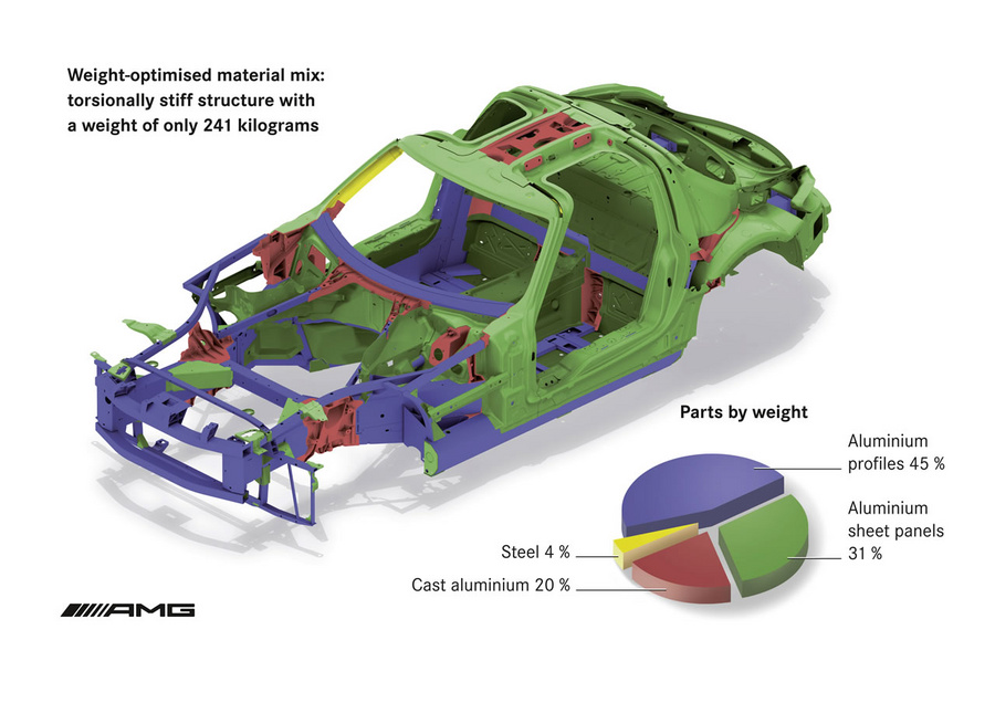

The radical design as a highly talented dynamic super sports car with its low-slung front-mid engine set well back also feeds through into the proportions as well as the optimised lightweight body concept: for the first time, Mercedes-Benz and AMG are presenting a car with an aluminium chassis and body. Compared with the traditional steel design, this results in a significant weight saving, clearly illustrated in the planned DIN kerb weight of 1620 kilograms excluding driver.

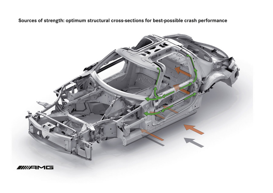

The newly developed bodyshell comprises an aluminium spaceframe. This exclusive design combines intelligent lightweight design with outstanding strength – thus delivering superlative driving dynamics. Naturally, the aluminium spaceframe meets all the requirements in terms of passive safety and the hallmark Mercedes-Benz body quality that applies to any car sporting the Mercedes-Benz star. Despite the low sitting position in typical sports car fashion, the wide-opening gullwing doors make it easy to get in and out of the vehicle.

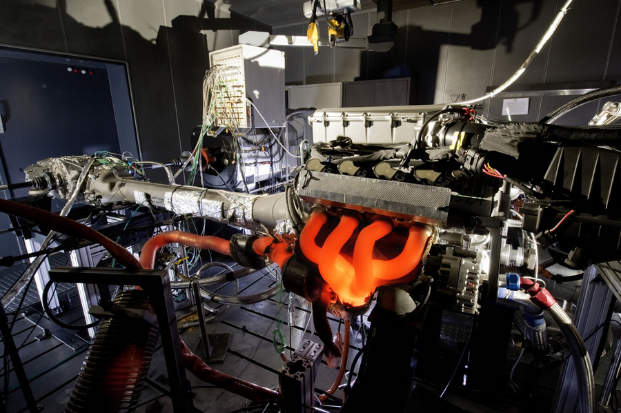

The fine-tuned AMG 6.3-litre V8 engine achieves a peak output of 420 kW/571 hp at 6800 rpm, thus turning the SLS AMGinto one of the most powerful sports cars in its segment. A power-to-weight ratio of 2.84 kg/hp comes courtesy of the low vehicle weight. The eight-cylinder naturally-aspirated engine delivers maximum torque of 650 Nm at 4750 rpm. The 'Gullwing' accelerates from 0 to 100 km/h in 3.8 seconds, before going on to a top speed of 315 km/h (all figures are provisional). Bearing the internal designation M159, the V8 high-revving engine with its displacement of 6208 cubic centimetres has been thoroughly reengineered compared with the M156 entry-level engine and boasts all the hallmarks of powerful racing engines.

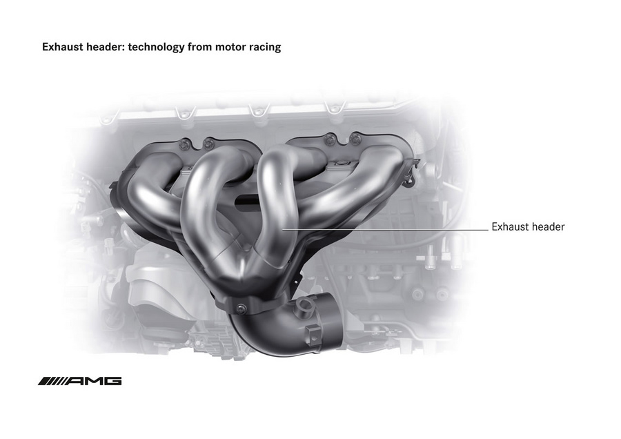

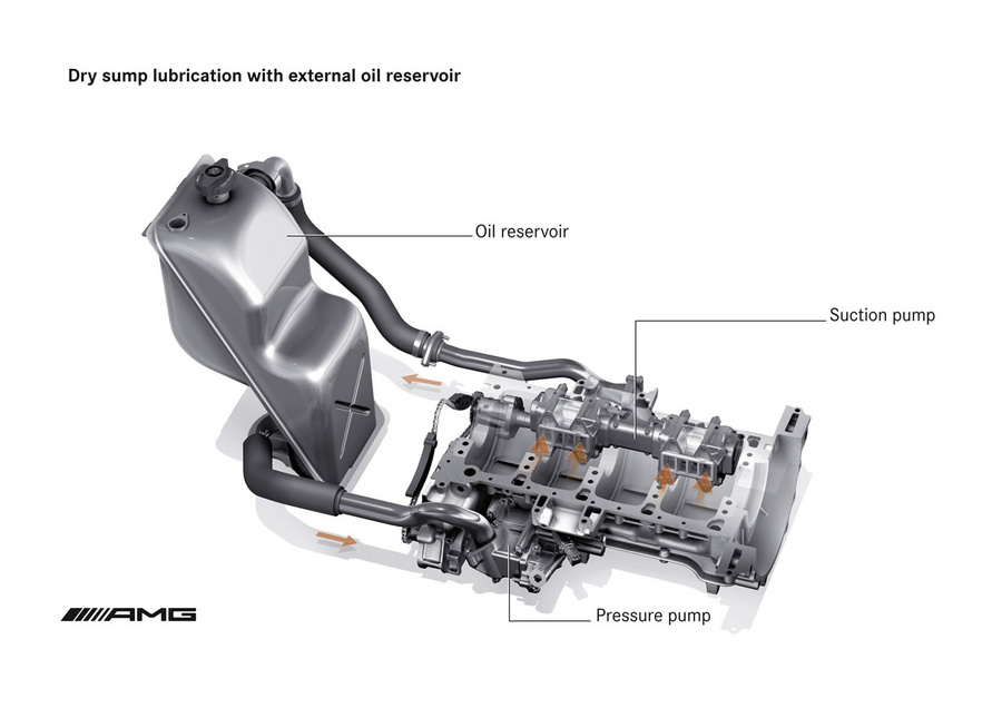

The principal measures in increasing output include the all-new intake system, the reworked valve train and camshafts, the use of flow-optimised tubular steel headers and the dethrottling of the exhaust system. This results in much better cylinder charging, which feeds through into an increase in output to 420 kW/ 571 hp with maximum torque of 650 Nm. The eight-cylinder engine responds swiftly to movements of the accelerator pedal, demonstrating much more pronounced high-revving flexibility across the entire rev range. The switch to dry sump lubrication also translates into a much lower position of the engine in the vehicle. And lowering the vehicle's centre of gravity has also paved the way for high lateral acceleration and exhilarating driving dynamics.

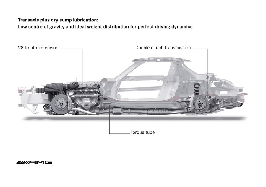

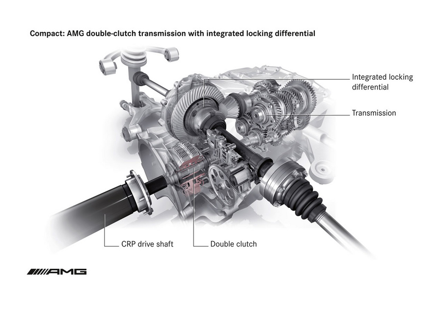

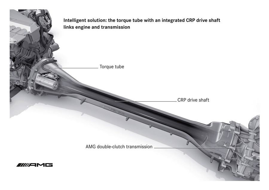

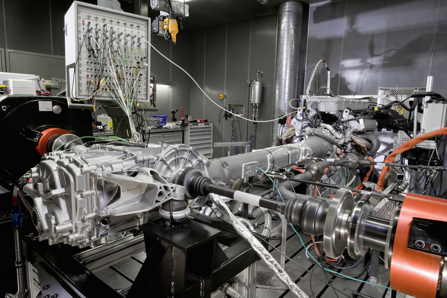

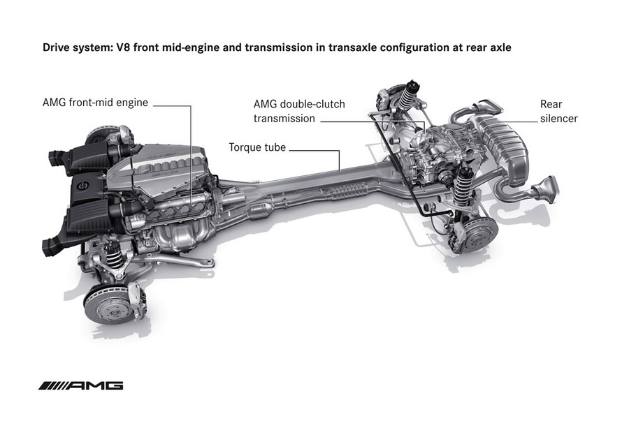

The AMG 6.3-litre V8 engine delivers its abundant power via an ultra-light carbon-fibre driveshaft at the rear axle – similar to the set-up used on the DTM C‑Class racing touring car. The transmission is mounted at the rear (transaxle principle) and is connected to the engine housing via a torque tube.
A carbon-fibre shaft rotates at engine speed in the torque tube. The advantages of this sophisticated solution are associated with the rigid link between the engine and transmission and, in turn, the optimum support for the forces and torque generated. A new AMG dual-clutch transmission with seven gears takes care of power transfer. The transmission boasts fast gear changes with no loss of tractive force. The driver has a choice of four different driving modes, ranging from comfortable to extremely sporty, as well as a RACESTART function. Optimum traction comes courtesy of the mechanical differential lock, which is integrated in the compact transmission casing.

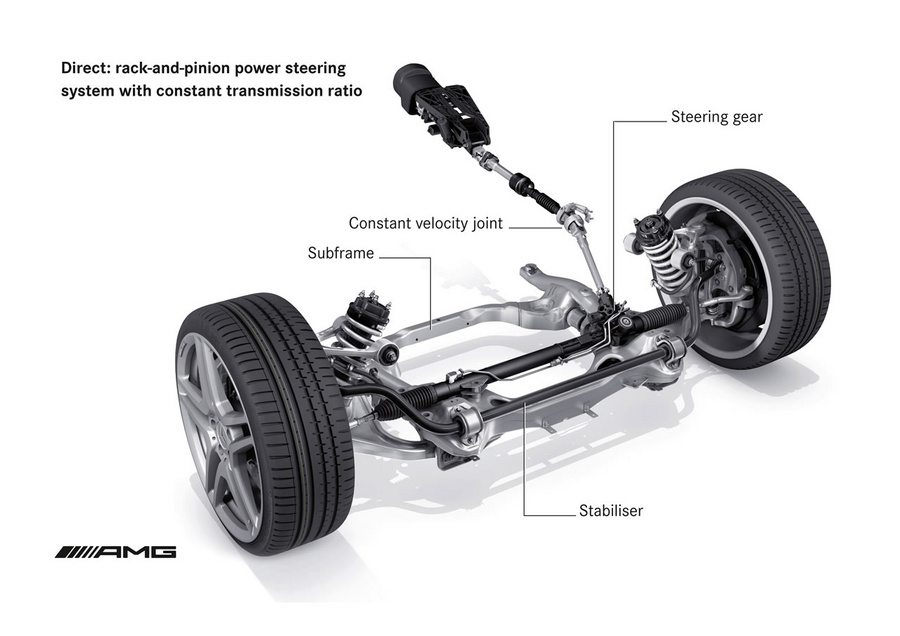

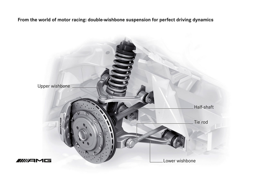

The chosen solution with a front-mid engine plus transaxle configuration ensures an ideal front/rear weight distribution of 48 to 52 percent. Mounting the engine behind the front axle has created the ideal conditions for consummate driving dynamics with precise steering, first-class agility, low inertia with spontaneous directional changes and outstanding traction. The suspension technology is also a match for these high standards: wheel location comes courtesy of double wishbones and hub carriers made of lightweight forged aluminium. The 'Gullwing' comes with 3-stage ESP® as standard, providing the driver with access to the three "ESP ON", "ESP SPORT" and "ESP OFF" modes at the push of a button.

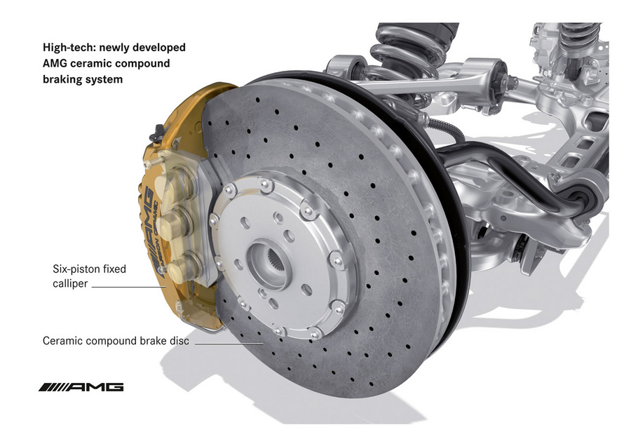

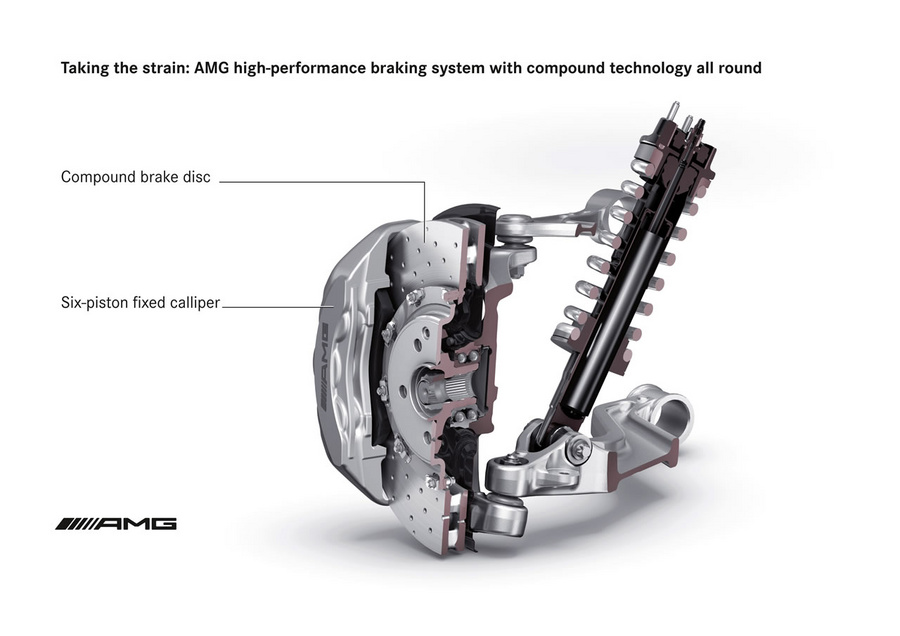

The AMG high-performance composite brakes all-round ensure extremely short stopping distances even under enormous loads. The newly developed, optional ceramic composite brakes with larger brake discs guarantee even better brake performance and lower unsprung masses. The ceramic brake discs will perform reliably at even higher operating temperatures thanks to their greater hardness, all combined with an impressive weight reduction of around 40 percent. Light-weight design was also a key consideration with the wheels: weight-optimised AMG light-alloy wheels – 9.5 x 19 inch (front) and 11.0 x 20 inch (rear) - based on the innovative flow-forming principle reduce the unsprung masses while increasing driving dynamics and suspension comfort. 265/35 R 19 (front) and 295/30 R 20 (rear) tyres developed exclusively for AMG ensure optimum grip.

Lots of really cool stuff here, but I wish MB used CF to make a monocoque chassis like they did with the SLR. This is still some pretty trick stuff here and I'm pleased to see they integrated a dry sump oiling system. It's incredible to see just how low they were able to get the center of gravity and with the nearly 100% of the engine behind the front axle, it should be incredibly well balanced.
