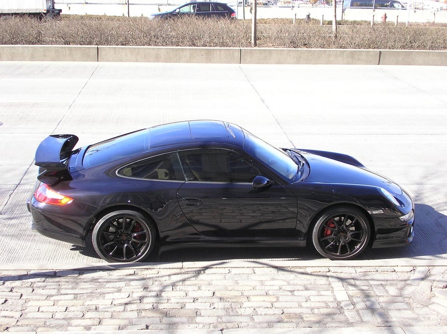

GT3 wheels fit great
Old Jul 13, 2008 | 08:51 PM
jenk12m's Avatar
Posts: 1,915
with the wheels and the aero package, it makes it difficult to tell it apart from a reg. gt3
