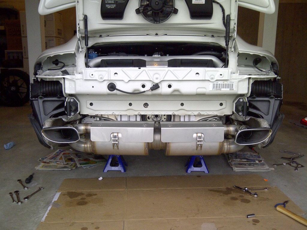

I installed the exhaust myself. Fitment is perfect! And I mean bang on. After all the issues I had with the custom 200 cell cats and to have these test pipes fit perfectly my eyes started to tear!
If I can make a suggestion. You will need a special tool to access the half sized bolt that hold up the large heat shields. There is no access as the turbo is in the way so you will need some kind of crooked specialised tool. You'll need to drop the heat shields in order to access the 02 sensor wires.

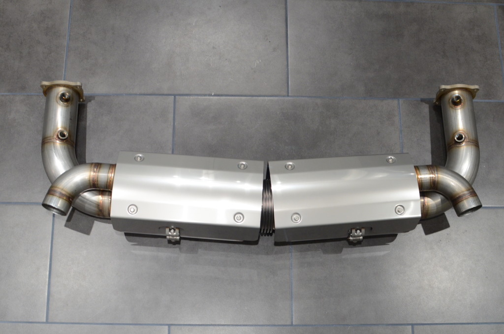

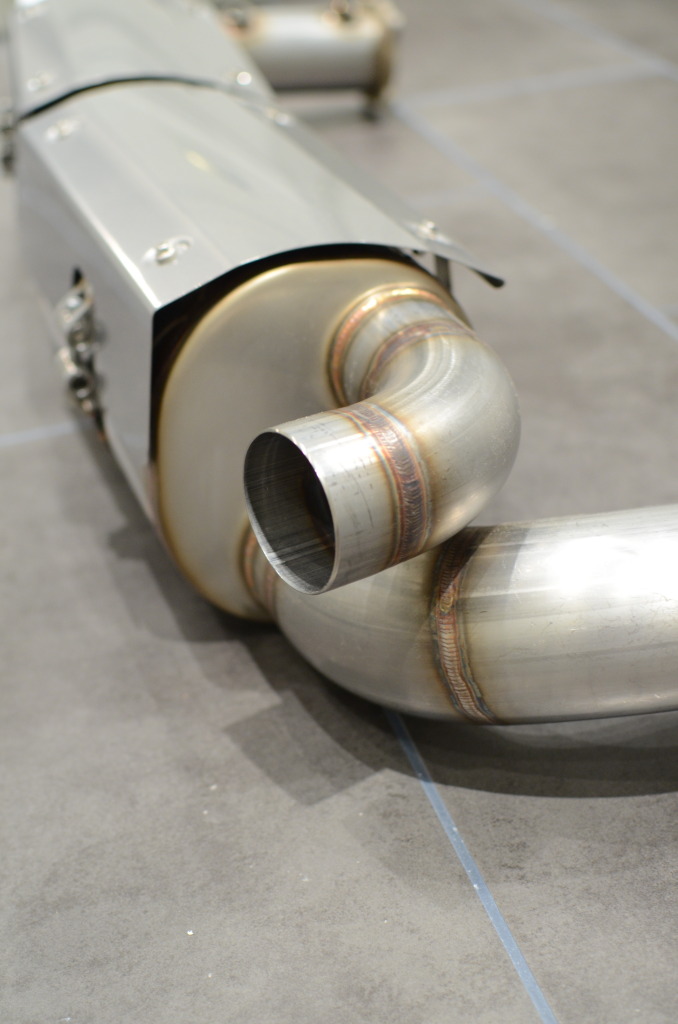

Check out those welds

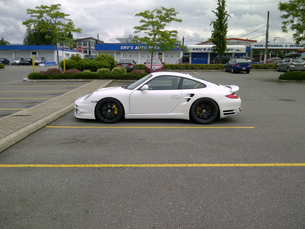

A blackberry pic I took before the track day
