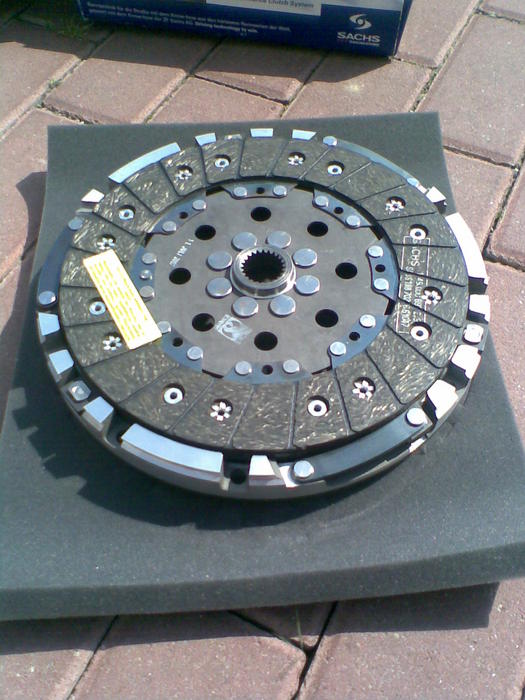

Guys,
at present I'm driving with Sachs Ruf in combination with standard fly wheel.
My disc is without springs, that means it is on/off and dramatic shaking during slow starting, hope you know what I mean?
anyone knows something about clutchmaster? it is made in USA

w/o springs is unsprung disc = slightly unfriendly in traffic, still good
w/ springs is a sprung disc = smoother all around

Unless you are racing, I highly recommend going with the springs.
