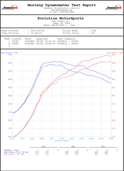

Originally Posted by Arone997tt
No dyno posts?
It's built in exactly the same fashion that we've been doing since late last year when EVOMS live-tuned the kit on another of our customer's cars so with all the hardware staying the same etc...
Originally Posted by bonehead
TestJet! We need some impressions!
Felt very good to me on 91
