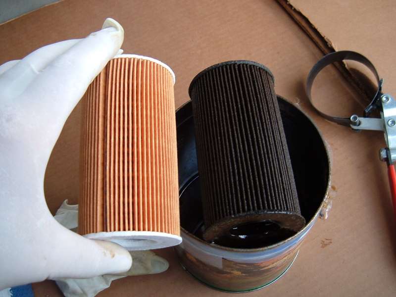

I did my own oil change @ 5000+- miles (bought the car with 4K miles) and my entire filter was black. Any idea why it appears that only half of the OP's pictured filter is used?? Also as someone asked above...I believe the 27mm wrench on the tank is iused to counter torque to the tank itself while loosening the drain plug.

what do you mean only 1/2 used, the whole filter is black??
