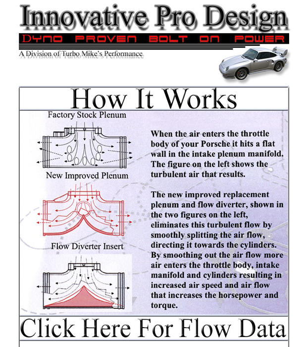

Here are a few pictures of the IPD plenum pre-install
Cast metal
Looking inside, painted and designed with efficient airflow in mind
Compare that with the OEM plastic plenum
Not designed for airflow efficiency
The view of the inside from the top

It took Cantrell Motorsport about 2.5 hours to install the plenum which should be pretty standard for tuner shops everywhere if they know what they're doing.
My initial impressions although done before the ECU has had a chance to relearn the new parameters of the airflow efficiency brought on by the new plenum from IPD/RSS is very good. From a standstill, there's a noticable reduction in turbo lag when moving from a standstill. The engine seems to be slightly more eager to get up to speed. Bottom line is, I'm very happy with this modification and will definitely recommend anyone considering this mod to go ahead and get it. I have no plans to do a dyno at this time since I didn't have a chance to do a pre-dyno test. I should be able to compare stock vs modified soon if Larry gives me the opportunity to do so. I'll give a final report after the ECU has had a chance to adapt.
[update]: It's been almost a week since I first got the IPD installed so I've managed to put a few miles in my Turbo since then. I can tell you guys that after about 50 miles, the powerband has noticably changed for the better. Previously there was a slight dip on power delivery going from a stop but that "dip" has disappeared! Although there's still a lag from a complete stop, it's not as apparent as it once was before. The plenum has definitely worked in ensuring a smoother power delivery throughout the powerband. I would give this "mod" two very enthusiastic thumbs up!
