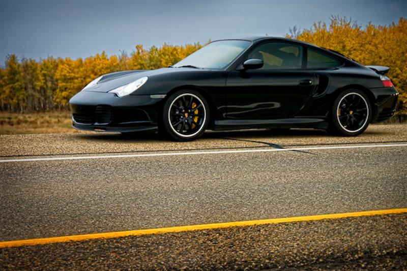

Damn that looks great!!! Nice write up on your thought process. I went through much the same when I got the 9's for my 996tt a while back. Can't wait to hear your thoughts, but if your car is transformed as much as mine was (and it truly was after I got it corner balanced - which you can ALSO do with adjustable coils but not just a spring kit), you'll be very well pleased.
I'll take mine out for spring very soon. Can't wait. It's really a wonderful car once the coilovers are on it.
This is mine after I had the coilovers and corner balance done.
