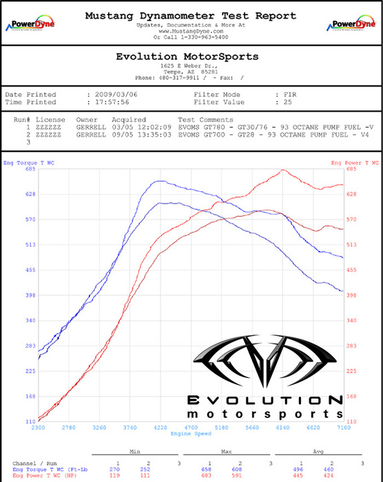

EVOMS GT780 Dyno of my new set-up
So here we have the dyno for my previous GT700 system to the new GT30's which I guess is called a GT780
I look forward to getting my car home so I can feel the difference from the GT700 kit which used GT2860's
Additions to my car this time to the existing GT700 kit are: 1) 80lbs Siemens Injectors, In-line Bosch 044 Fuel Pump and Water Cooling kit for the new turbo's.

Strong numbers Ben, congrats.

Great numbers. How did you come up with 780? What was your drivetrain loss and which number did you use to get there?

If you look at the dyno sheet hamilton, EVOMS called it that so that is what I used, simple as that. It makes no matter to me, what's important is how she drives on the street.
The numbers game is a bit of a joke really. Any tuner can play with the dyno numbers to make a car look good on a paper for bragging rights but that's were it stops. Just my opinion

We should really call this kit the GTBEN. One of the great pluses about writing our own software in house is that we can cater to exact customer specifications. Ben gave us his needs, his driving style, his exact fuel and we built this kit to suit him. With the GT30s that are currently on the car, if he decides down the road that he wants more, we can give him more. This setup is something that will last for years and years to come and last through all the abuse that Ben can give it, it is not a kit that will require a rebuild every 6 months.
