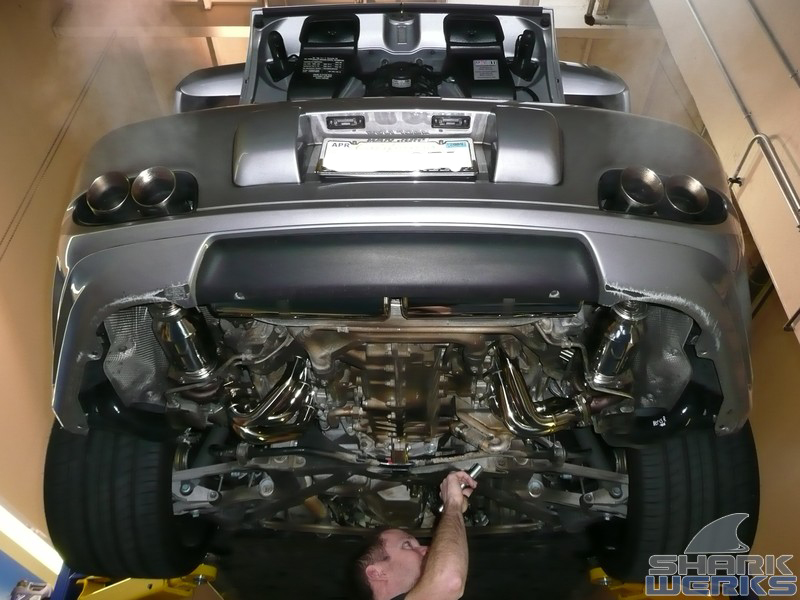

Had a few nifty cars this week to play with so I figured I'd share another EVOMS EVT700 equipped car that we built this week. With the EVOMSit Software tuned for 91 octane, EVO VTG Turbos, EVO Headers, EVO BRV's, Intercooler Kit & Hoses, Fabspeed Exhaust (and dual tips) and that tiptronic gearing (and mapping) she's a real hoot
Here she is as the finished article with black HRE P40 Monobloks, TechArt rear valence and Type 1 wing and the GT3 front vent installed.
First phase was to remove the exhaust, headers, turbos, intercoolers (oh and the bumper):
With the turbos off it's a good idea to swap in some new spark plugs as well since it'd be tricky to do later (the car had 8000miles on it). One other thing/tip that we've come up against is the cam timing sensors.... It's a good idea to change those out because we've seen so many 07-08 cars have a faulty cam timing sensor. They're only $65 each (X2) so it's worth changing out at the same time.
On with the intercoolers, turbos, BRVs, hoses and Fabspeed exhaust..
And James giving her a once over checking for leaks etc...

Thanks for details..this will help us to install Swizter kit here...
How to check for leaks ???
Are you going to test the on driftbox...would be intresting how EVO tips runs ...
Thanks Mike... I've got way more detailed ones in terms of install... You just have to run the car and inspect the lines etc... look for coolant and/or oil and you better not find any:P
Haven't done dbox stuff but I know EVO did some stuff at the track and it was in the high 10s....
