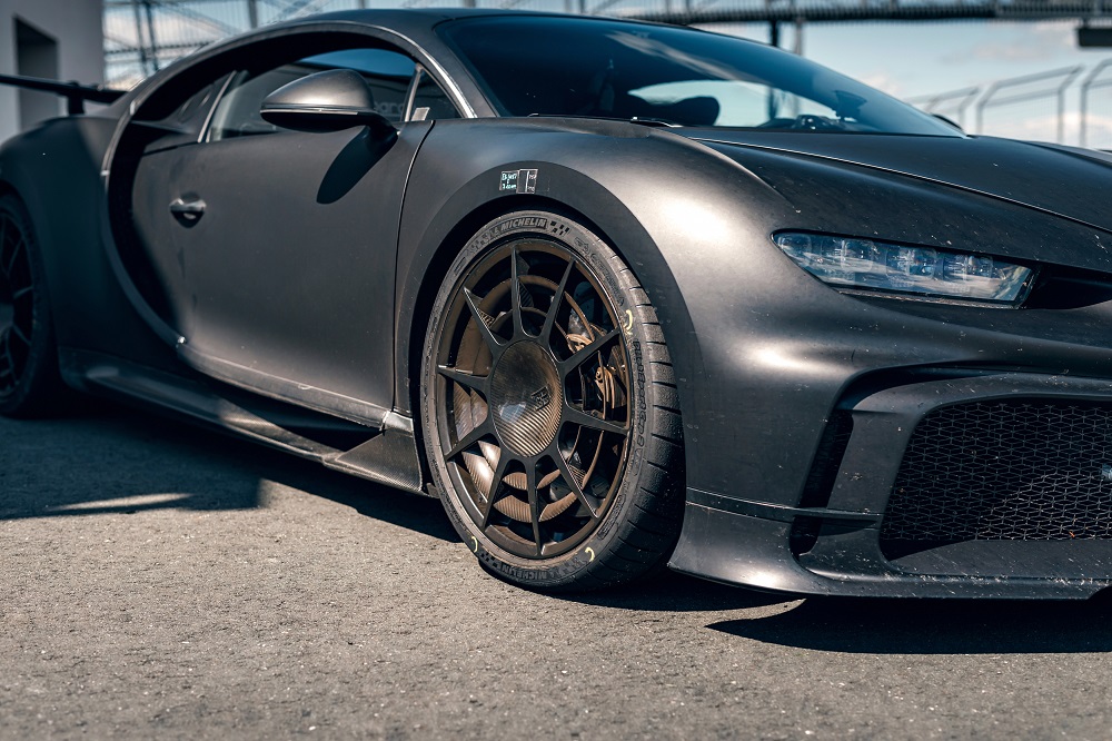

Running through a number of test loops, the engineers at Bugatti and Michelin eventually found the perfect rubber compound for the best possible grip. The entirely newly developed Bugatti-exclusive Michelin Sport Cup 2 R tires in size 285/30 R20 at the front and 355/25 R21 at the rear ensure exceptional grip even on tight corners taken at high speed.
BUGATTI CHIRON PUR SPORT
With a newly developed tire structure and a softer rubber compound optimized for the chassis, this combination offers ten percent more lateral acceleration, thereby further increasing the cornering speed and overall performance of the hyper sports car.
Aero Rims for Increased Downforce
For the Pur Sport, Bugatti has created a magnesium rim with optional Aero blades which is about four kilograms lighter. Arranged in a ring shape, the blades ensure optimum air extraction at the wheel arches while at the same time improving aerodynamics. When the vehicle is in motion, the rings fitted to the rim help to suck the air through the wheel, which leads to an increase in downforce. A special cover on the five wheel bolts minimizes the adverse air turbulence and visually finishes the wheel appearance. The total weight saving of 16 kilograms results in a reduction in the weight and lower unsprung masses. “This increases traction because the wheel can be kept on the ground more effectively. Every driver will feel a sense of lightness in corners,” explains Jachin Schwalbe. The vehicle weight is reduced by about 50 kilograms in total.

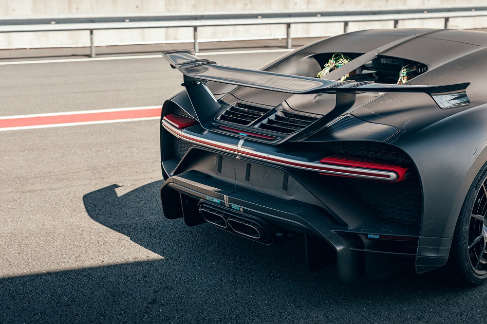

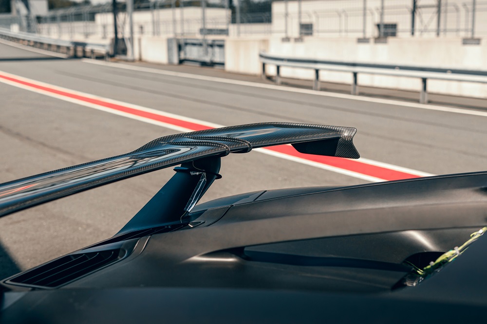

At the rear, a larger and longer diffuser and a fixed rear wing measuring 1.90 meters in width produce more downforce on the rear axle. This is perfectly balanced over the entire speed range by a large front splitter, wider front air intakes, wheel arch ventilation with optimized air outlets and reduced standing height. All in all, this contributes to increased agility. At the same time, omission of the hydraulic component of the otherwise automatically extending spoiler reduces the weight by more than ten kilograms.
