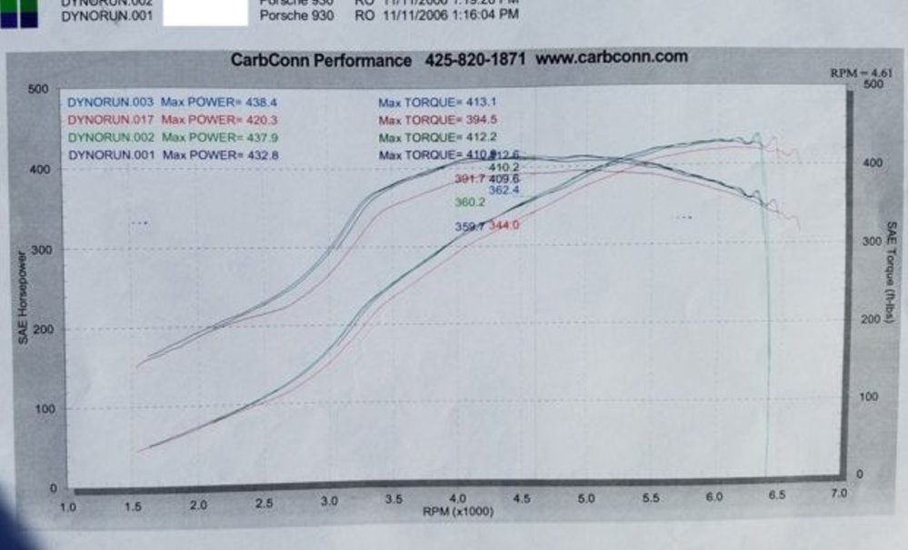

RoW Euro spec car imported into the US in 1985. All DOT paperwork included and clean title in hand. Car was converted into a street/track car in early 2000’s in North West by PCA racer (Randy Blaylock). No wrecks or track damage. Clean car fax. Includes all service records since 2002 (well over 100K in parts/work). 167,961 miles on chassis. 12,170 miles on engine since complete rebuild. 2,620 lbs wet, 438hp/413 lb-ft torque at rear wheels. 5:1 power to weight ratio. Only 3 track days on motor since rebuild. Maintained locally by Jerry at EPE (European Performance Engineering, Natick, MA). This car is a rocket on the track and street. EPE described it as a ‘loaded weapon, be very careful with it’.

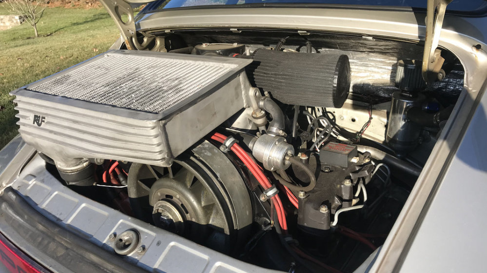

Engine: Complete rebuild using new 98mm Mahle P/Cs to 3.4L @ 7.5:1, big port SC heads fitted with stainless locking Ni-resist rings to prevent head shuffling under boost, 964 spec cams, Aase springs and titanium retainers, ARP. Twin plug MSD CD ignition w/Magnecor wires. Custom fuel head by Imagine Auto Porsche builders with RPM specific solenoid to hold off full boost enrichment and manage A/R ratio. B&B stainless headers, new K27HF S turbocharger, long neck Ruf intercooler, optimized airflow meter w/custom motorsports design intake plumbing. No air injection, cold start plumbing or pop-off manifold. New fuel pumps F/R. Fully shrouded and ventilated oil coolers in both fenders and front valance. Torque curve virtually flat across the RPM range at .8 bar on 93 octane. Leak down test results approx. 1,000 miles ago: Cly.1-5%, Cly.2-3%, Cly.3-4%, Cly.4-5%, Cly.5-4%, Cly.6-6%.
