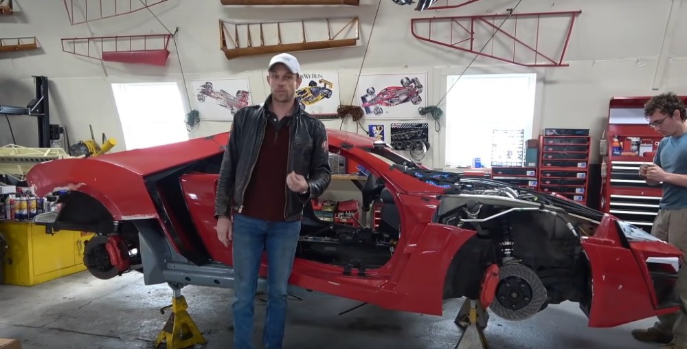

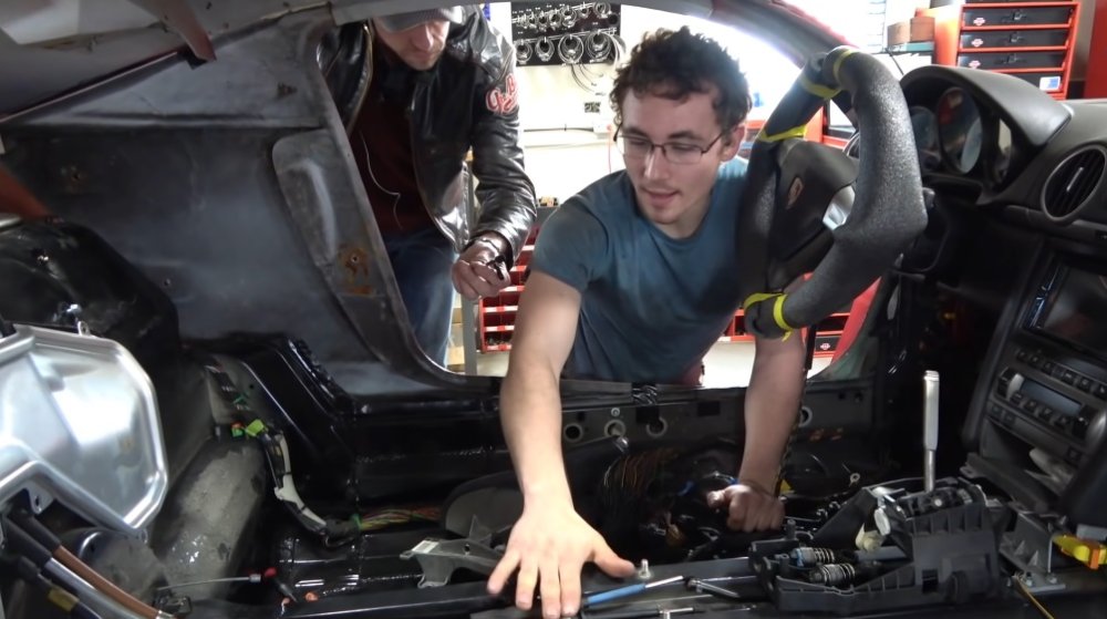

The team began by stripping down the body and lengthening the chassis by about eight inches, allowing the Porsche chassis to match the length of the Hypersport. The problem created by stretching the chassis is that most of the lines, cables, hoses and electrical connections are now too short. At the beginning of this video, Tyler is working on relocating the battery into the frunk, which is where it is located in the Lykan. That same student is working on the emergency brake and shift cables, fabricating extensions so that all of the stock Porsche systems work as normal in the Lykan.
Porsche Lykan Cables
Next, Putsch talks with Cameron, who is working on extensions for the fuel lines, but he also crafted longer pieces for the brake and clutch lines and after finishing these bits, he plans to move onto the coolant lines. Once Putsch and these two students are done with this portion of the project, they will be close to firing up their modified Boxster-turned-Lykan.

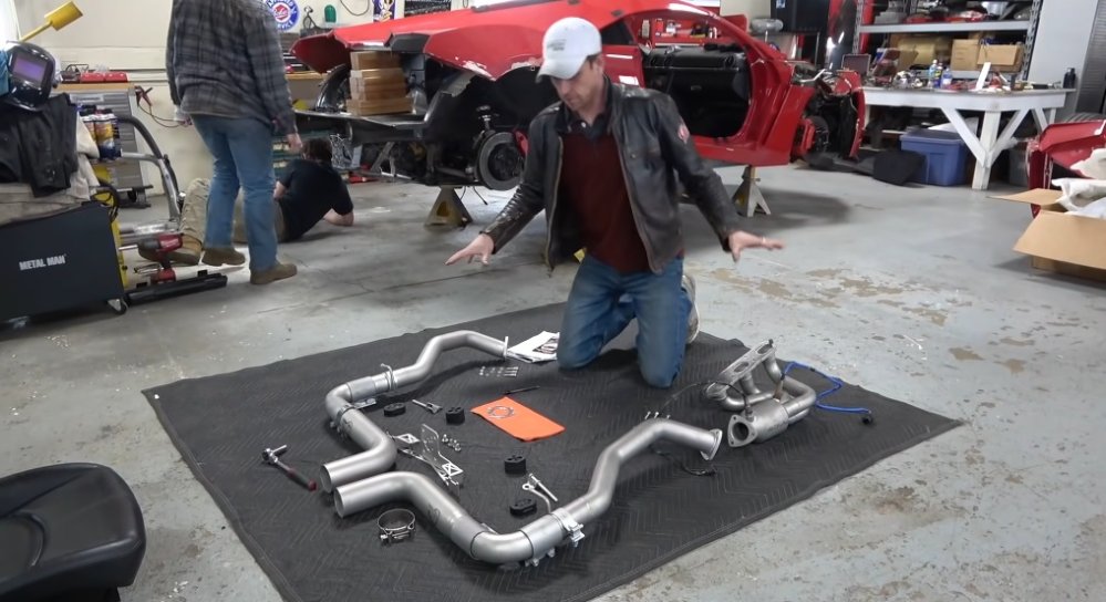

The key focus of this sixth video in the series is adding Soul Performance Exhaust to the Porsche Lykan project. Putsch begins by unboxing the parts, uncovering shirts that he gives to the students to wear during the video before pulling out one of the gorgeous headers. As he looks over the header with an integrated catalytic convertor, he points out the craftsmanship and fine details of the design.
Porsche Lykan HEader
Porsche Lykan Exhaust

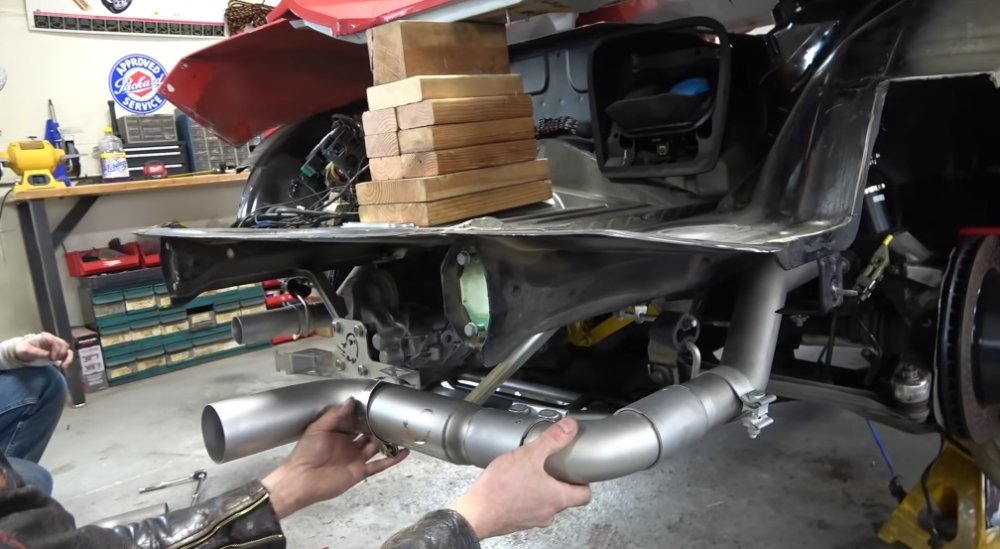

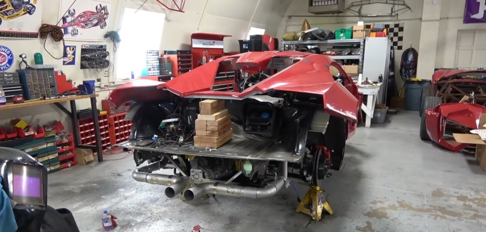

The exhaust install begins with Tyler working on the driver’s side header while Putsch lays out the rest of the exhaust system on the floor next to the car. Cameron removes the stock exhaust bracket and installs the compact Soul bracket, which looks a whole lot tidier. Tyler eventually moves to the passenger’s side header while Cameron and Putsch tackle the rest of the system, adding the mid-pipes and the tailpipes with their heavy-duty clamps. As the three install each component, they continue to swoon about the quality of the system, going so far as to call it one of the nicest aftermarket systems that they’ve ever seen.
Porsche Lykan BRacket
Porsche Lykan Pipes
We don’t get to hear the Soul Performance Exhaust in action, but Putsch plans to have this unique Porsche running within a week of this video filming. Once it does, we imagine that it is going to sound incredible with this race-style exhaust system.
Porsche Lykan Exhaust in Place
