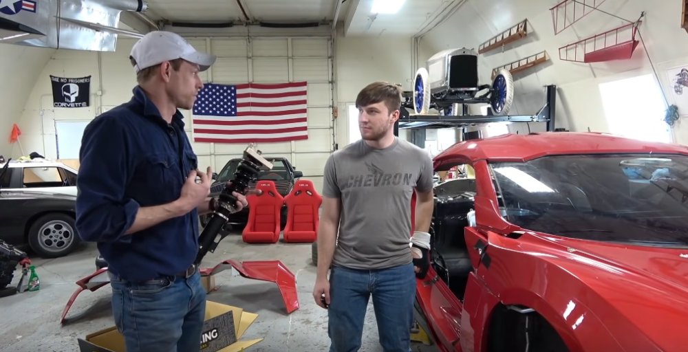

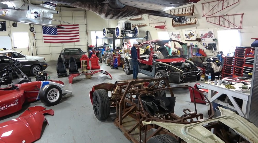

Earlier this week, we brought you a look at the Porsche Boxster S that is being transformed into a Lykan Hypersport by Casey Putsch of Genius Garage Racing. The VINWiki YouTube channel bought the Hypersport replica from the Fast and Furious Live show and Putsch is working with various Genius Garage students to turn the show prop into a running, driving supercar. The donor vehicle is a 2007 Porsche Boxster S and they chose this car because the Lykan is based on a 911 architecture, and while the Boxster is a bit smaller, they believe that the build will work.
The first step was to lengthen the chassis, as the Boxster is about eight inches shorter than the Lykan. Once Putsch and his assistants removed the body and many other components of the Porsche and added the extra length to the wheelbase, they were ready to test fit the body. That is where the video above from Putsch’s YouTube channel picks up, with a student named Cameron Hickson helping to create the exterior look of the Lykan.

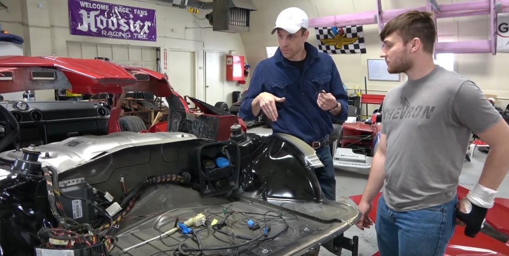

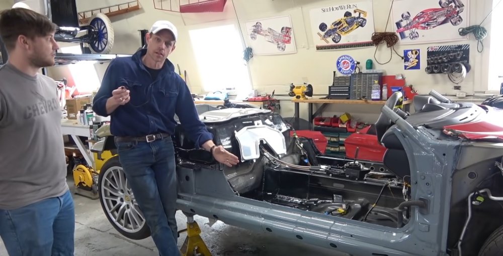

The video begin with Putsch and Hickson taking a look at the elongated Porsche chassis. The previous video ended with the first pieces of chassis extensions being welded into place. When this video begins, all of those items have been welded into place, all of that new metal has been painted to protect against corrosion and the windshield has been removed. In removing the windshield and the a-pillars, they uncovered a section of thick metal tubing that was retained, and which will serve as a connecting point for the custom roof cage of the Lykan.

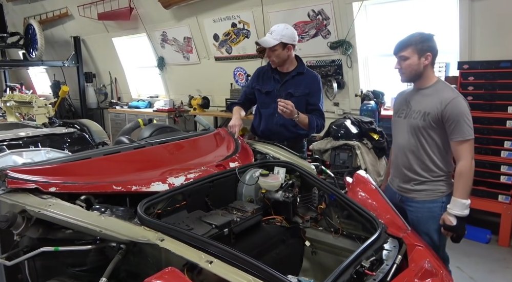

What does not fit with the Lykan body is the cooling system shrouding from the Porsche. The Hypersport front fascia is much tighter to the chassis, so there is no room for the big shroud. Putsch and his team will have to make a custom shroud, but they also have to create custom fender wells, so there is lots of fabrication left just to secure the body. However, Putsch wanted to give viewers a chance to see how well the Hypersport body fits the stretched Porsche chassis, so he and Hickson mocked-up the majority of the body panels with a little duct tape.
