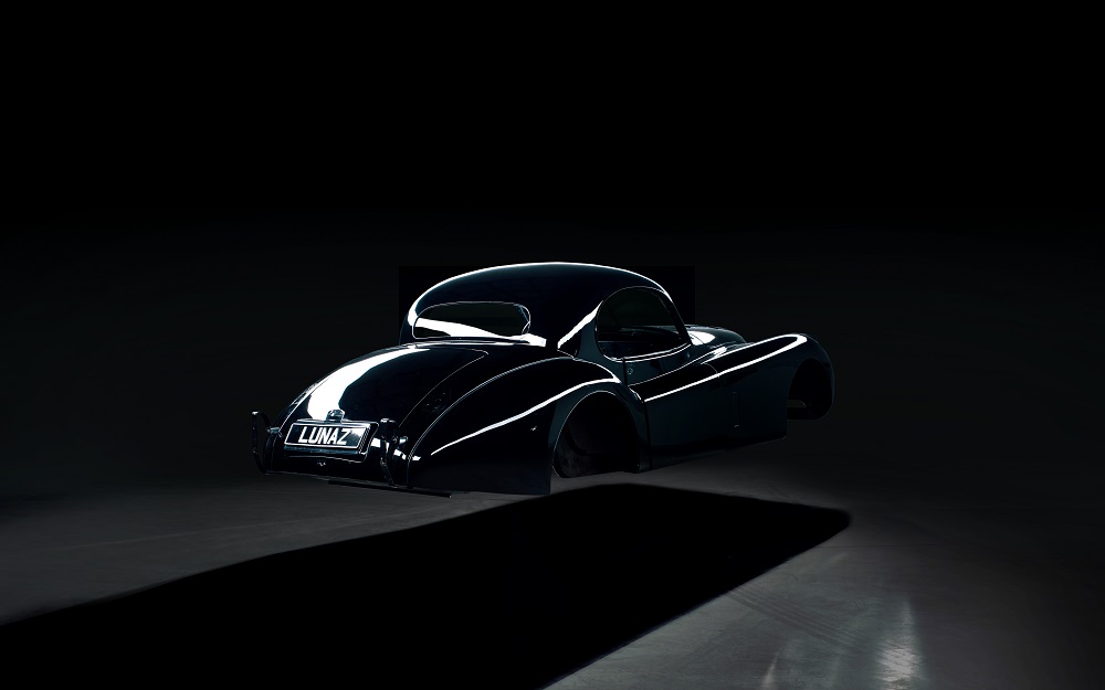

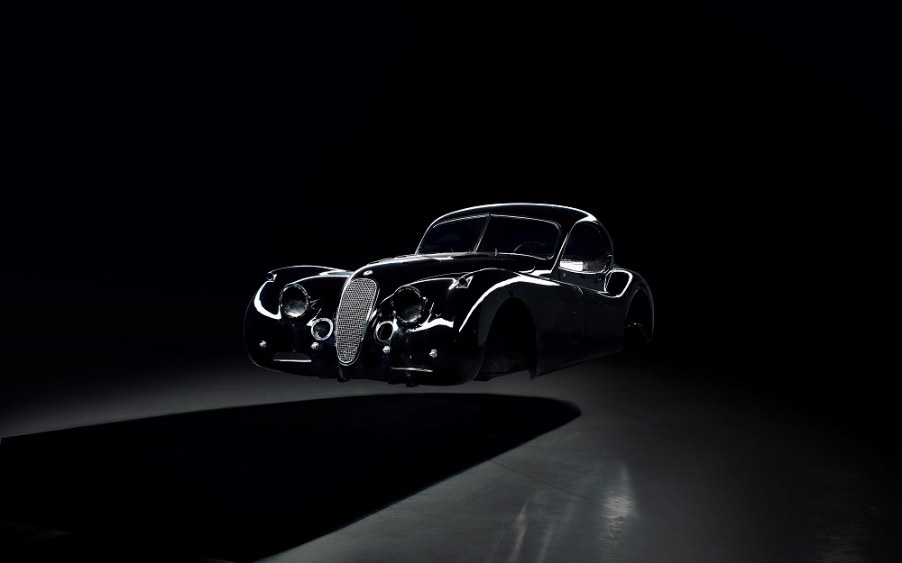

The Jaguar XK120 by Lunaz is currently in its final testing phase and will demonstrate the power of combining new world technology with old world beauty. The Jaguar’s twin motors produce 516 lb-ft of torque from zero engine speed and 380 hp.
XK120 by Lunaz

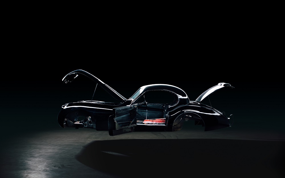

The restoration and conversion process represents re-engineering from the ground up. It starts with an exhaustive inspection. Each corner is then weighed to understand the original weight distribution to the gram. This information informs decisions on chassis setup, powertrain packaging and suspension. The internal combustion engine and associated systems are then removed and the chassis is prepared for electrification.
The car is then 3D scanned; this allows the engineers to create detailed CAD models to ensure technical perfection in every step of the process. The specifics of Lunaz’s electric propulsion technology is closely guarded, but each classic by Lunaz is designed, developed, engineered and tested in-house using the highest specification modules available for automotive applications.
Lunaz build
Traditional coachbuilding and restoration skills are then employed and the car is stripped down to a bare metal shell. Even imperceptible body defects are addressed by hand before the surface finish process begins. The same approach extends to the interior. The in-house design team make subtle adaptations to integrate modern amenities such as satellite telecommunications, WiFi, audiovisual entertainment and navigation aids.
