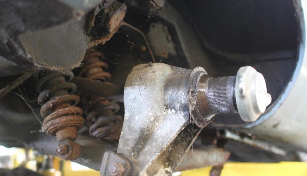

Upon its discovery, this E-type looked as though it was well preserved and rot-free, protected from the worst of the weather by four walls and a roof.
‘A restoration like this is a real challenge for our team; 40 years of inactivity takes an enormous toll on every single part of a vehicle.’

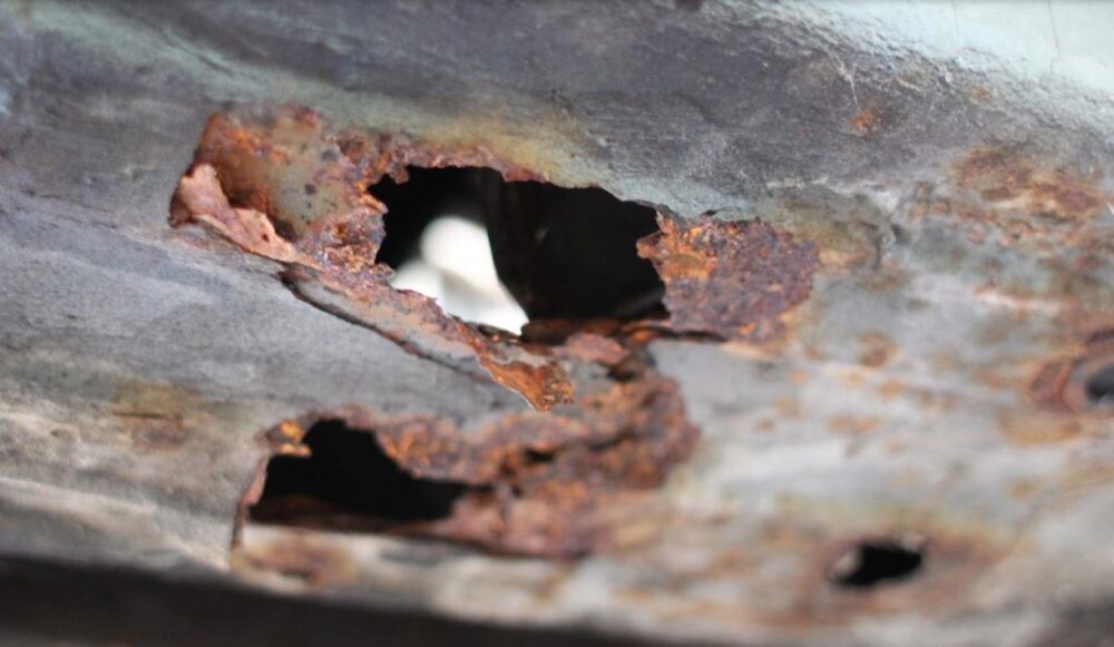

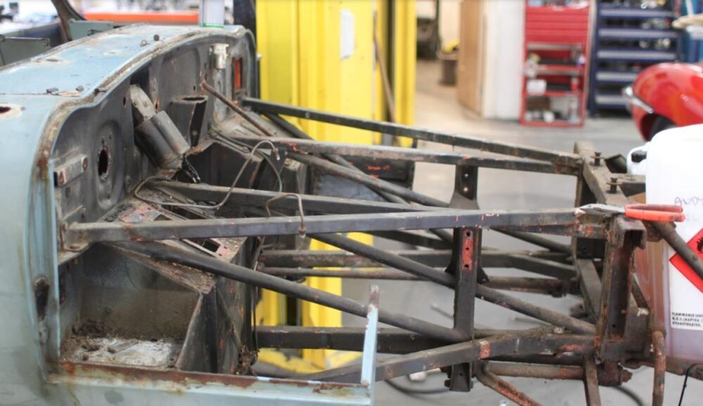

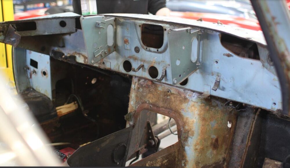

However, after an extensive sandblasting and a three-day strip-down, the extent of the damage caused by 40 years of neglect, coupled with previous cheap repairs and the usual British dampness revealed the real challenge ahead.
1964 Series 1 3.8 FHC Jaguar E-Type

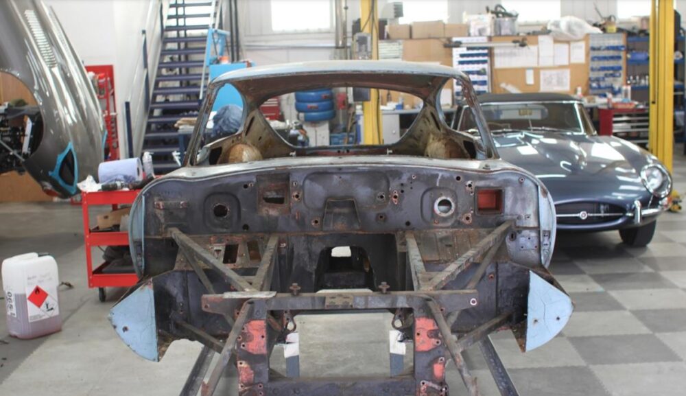

The E-Type UK team set about making sure this E-type would be safe and durable in years to come by identifying and replacing sections that were too rotten to save. The workshop team found that many areas of the floor and the inner and outer sills were beyond saving, opting to replace them completely while also strengthening the body elsewhere. Every suspect piece of metal was eliminated to ensure the structure is even stiffer than the day it left the factory.

Reassembly started with fitting this E-type’s uprated Independent Rear Suspension, which also included improved brake calipers and brake pads. At this stage, the front suspension was also fitted to create a rolling shell, making the car easier to maneuver around E-Type UK’s busy workshop.

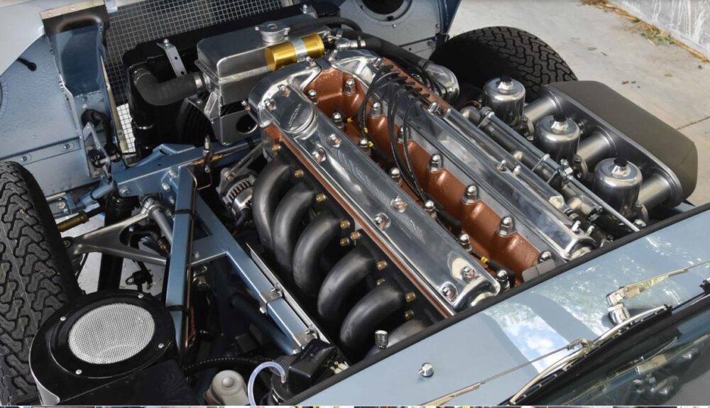

The E-Type UK team then turned its attention to a number of performance and usability upgrades. The original 3.8-liter XK6 engine was fitted with high-lift cams, a balanced and lightened crank and new seals, all of which will help with driveability and reliability. Also fitted were a new five-speed gearbox for tighter shifts and more refined cruising, a new full stainless-steel sports exhaust and an aluminum radiator and header tank for enhanced cooling.

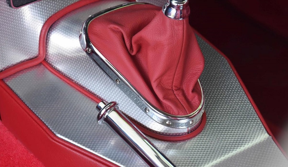

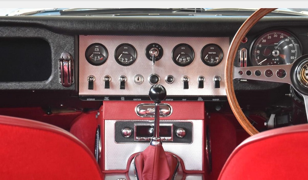

With much of the work complete, the finishing touches were applied, including the newly trimmed Oxblood Red leather interior, along with fresh chrome work and headlight surrounds. In a nod to examples of the rare E-type Lightweight (of which only 12 were originally completed), the new owner requested the addition of a new red vinyl bonnet mouth, setting off the look perfectly.
