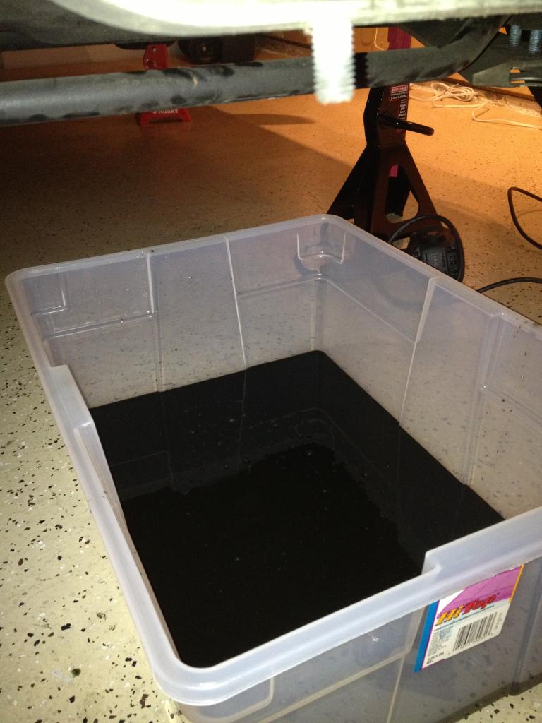

Returned the control module. Next I drained the transmission oil. WARNING Now before you look down further I hope that you are sitting down before you see these photos... This fluid and filter are only 2.5 years and 28k miles old. Keep in mind that Porsche recommends a Tiptronic fluid and filter change every 12 years or 120,000 miles whichever comes first!
It smelled SO BAD and so burnt...

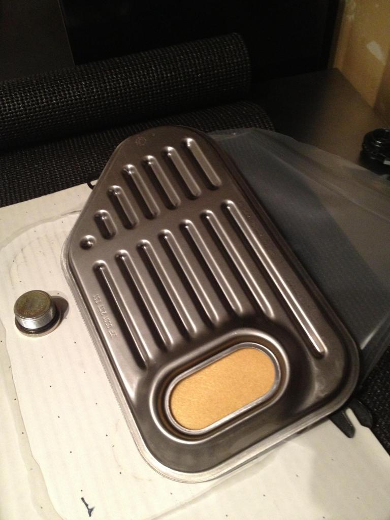

New filter for comparison:

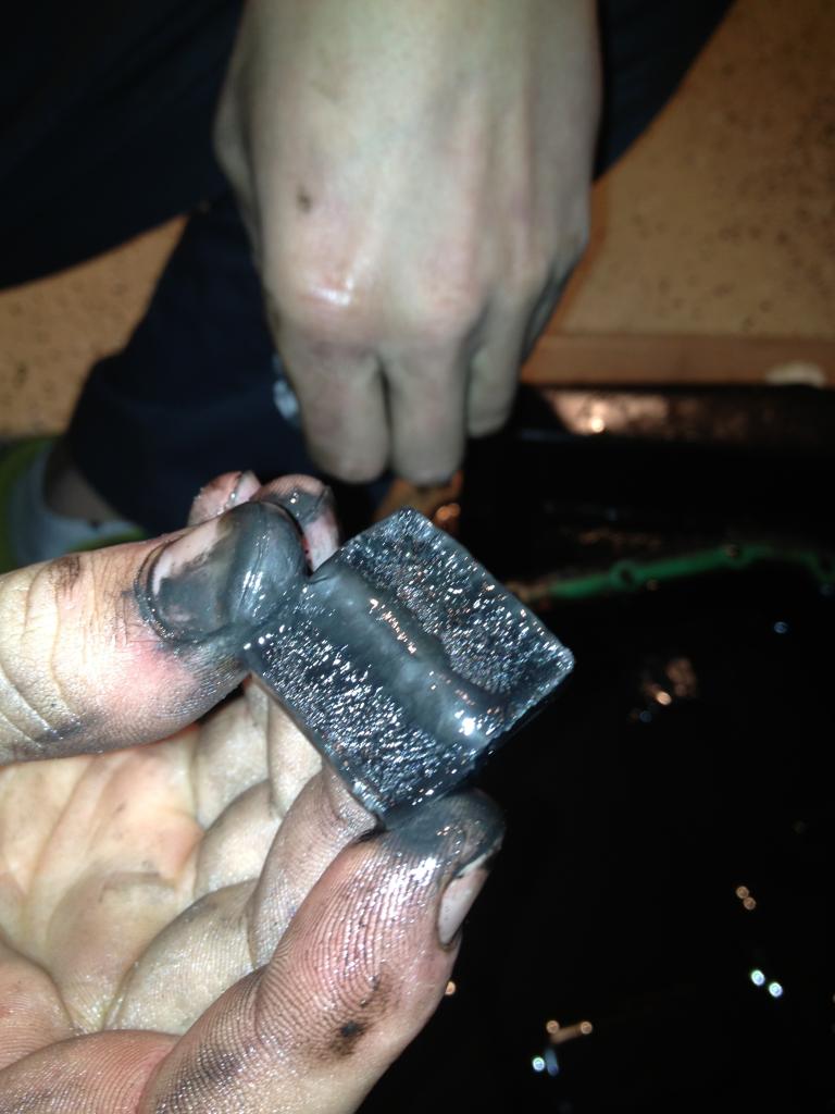

Here's what the magnets scooped up:
