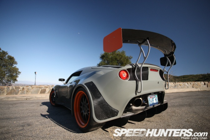

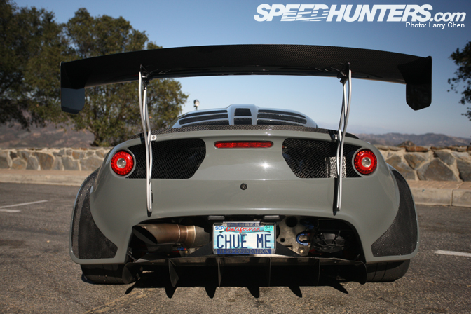

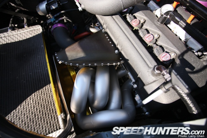

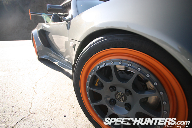

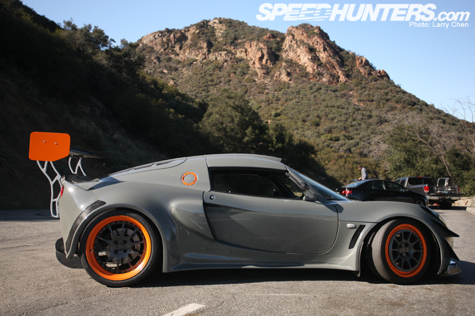

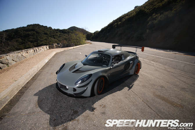

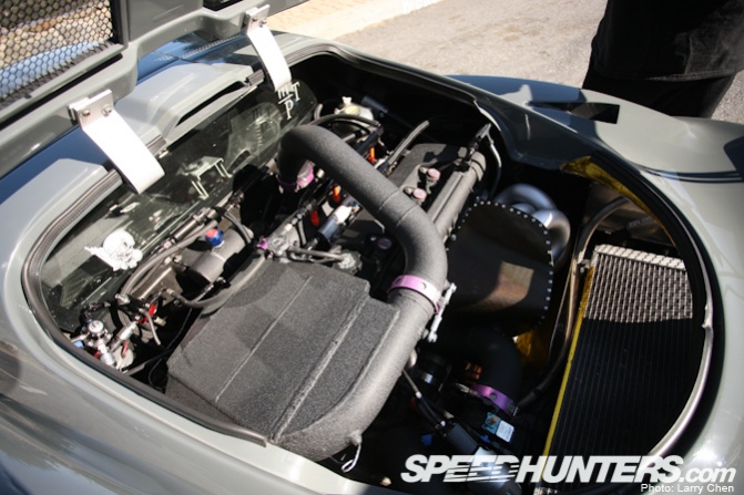

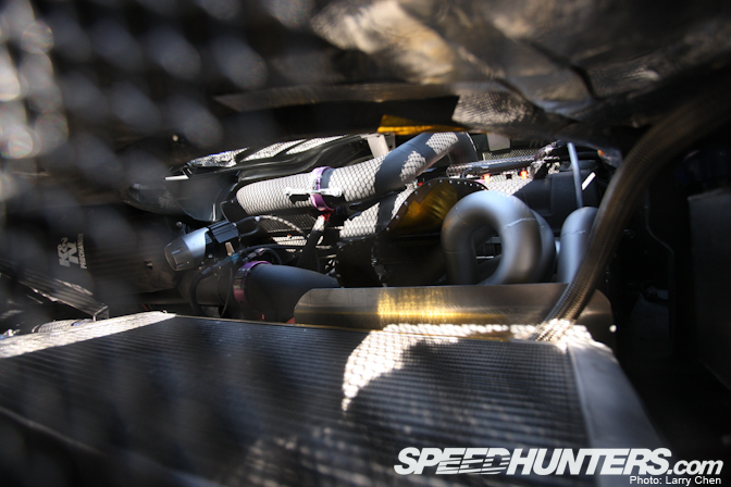

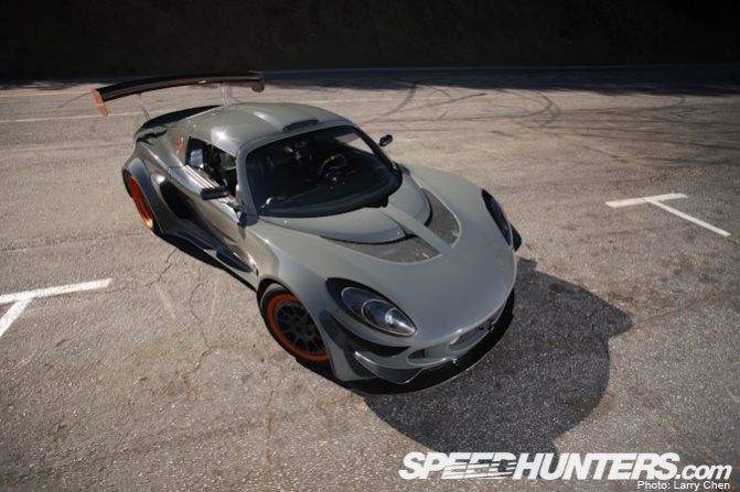

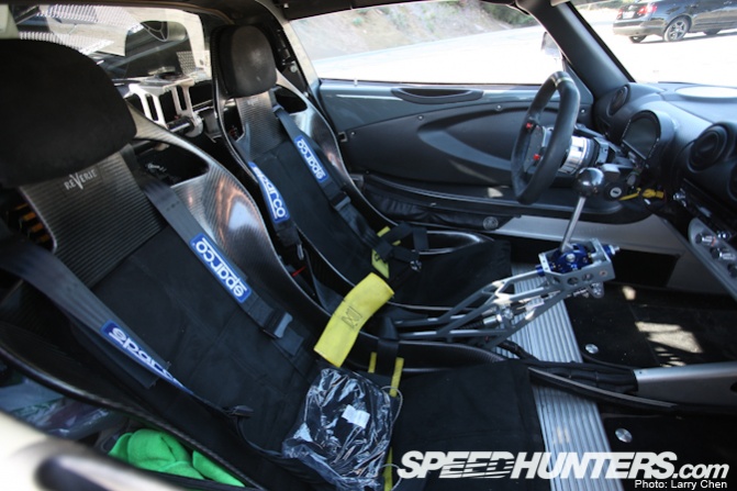

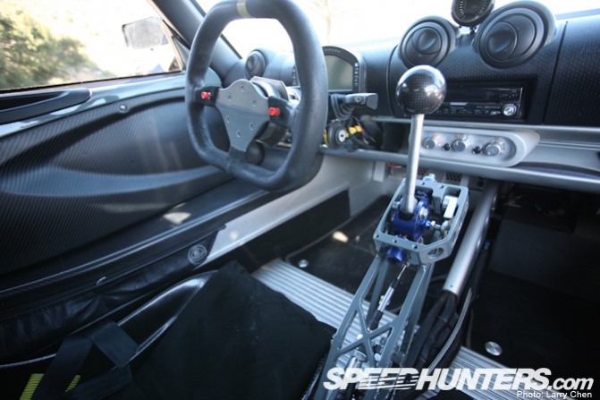

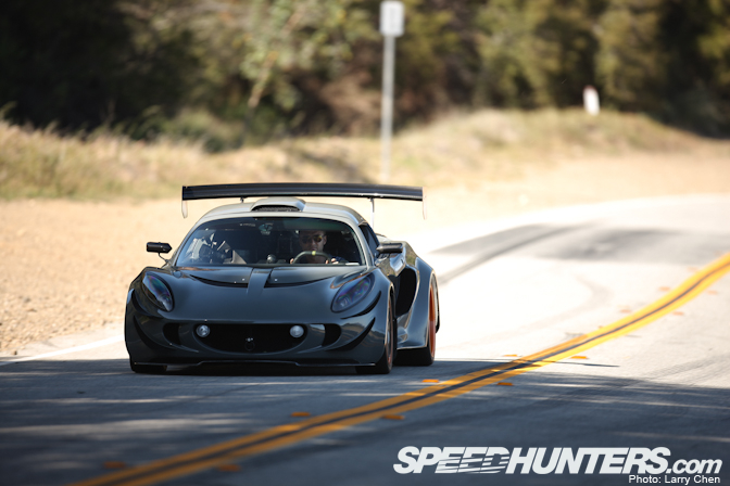

10 Attachment(s) Model: 2005 Lotus Elise Engine: 1.8 ltr. Toyota 2ZZ Power: 680 whp @36 psi. Weight: 2150 lbs. with A/C Dual staged fuel injection. Alcohol/Gasoline Mitch Pederson tuned AEM engine management AIM MXL dash Upgrades 9/1 Wiesco pistons Carrillo H beam rods RS Machine Darton wet sleeved block Stock crank Stage 2 cams Ferra valves/springs Ported head Precision Billet 6262 Ball Bearing Turbo Precision 48mm wastegate Custom equal length manifold Synaptic BOV 4" stainless exhaust Magnuson MP 62 supercharger Custom A/W charge cooler with 4x heat exchangers Two custom engine radiators to handle the heat. 6x cooling fans Remote oil cooler with fan Custom short shifter Toyota E153 gearbox Oil cooler Custom axles AP 4 pot Lotus Racing brakes Pagid R14 pads Kodiak Racing Wheels 7.5 x 16 10.5 x 18 Kuhmo V 710 front 215/40/16 rear 285/30/18 Nitron Shocks, Eibach Springs Custom bodywork Dry carbon fiber.. Canards, splitter, mirrors, seats, door panels, door sills, dash, roof, rocker panels, flairs, naca ducts and wing. Pictures by Speedhunters: Attachment 97530 Attachment 97531 Attachment 97532 Attachment 97533 Attachment 97534 Attachment 97535 Attachment 97536 Attachment 97537 Attachment 97538 Attachment 97539 |
