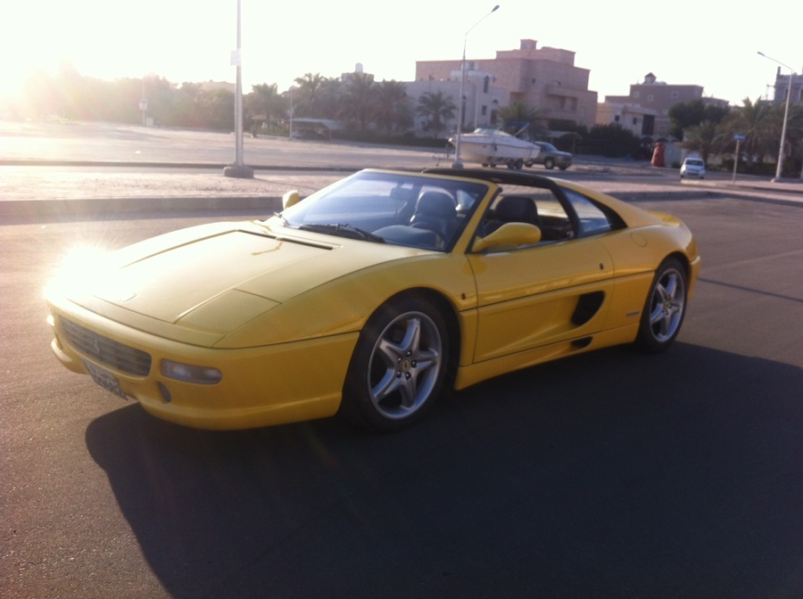

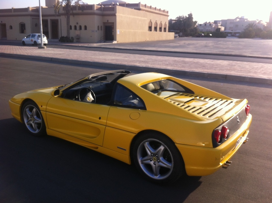

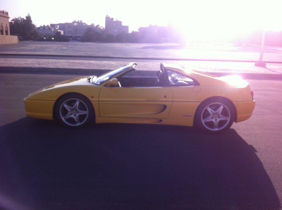

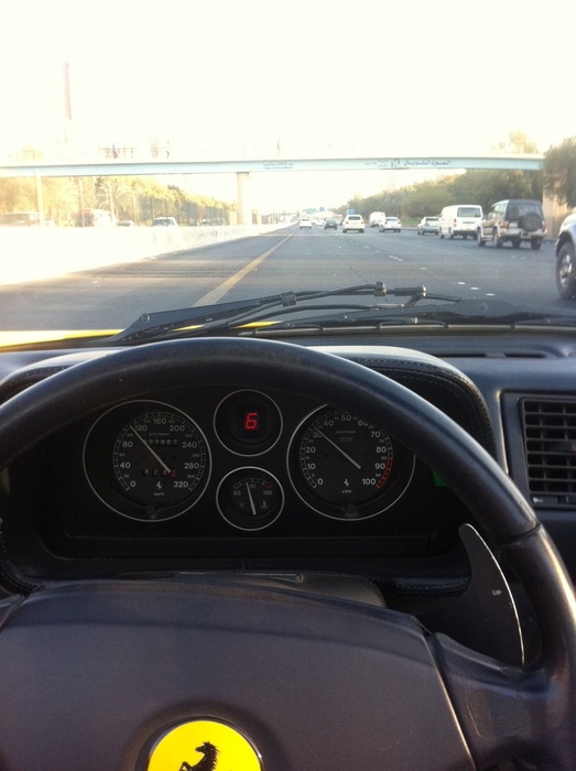

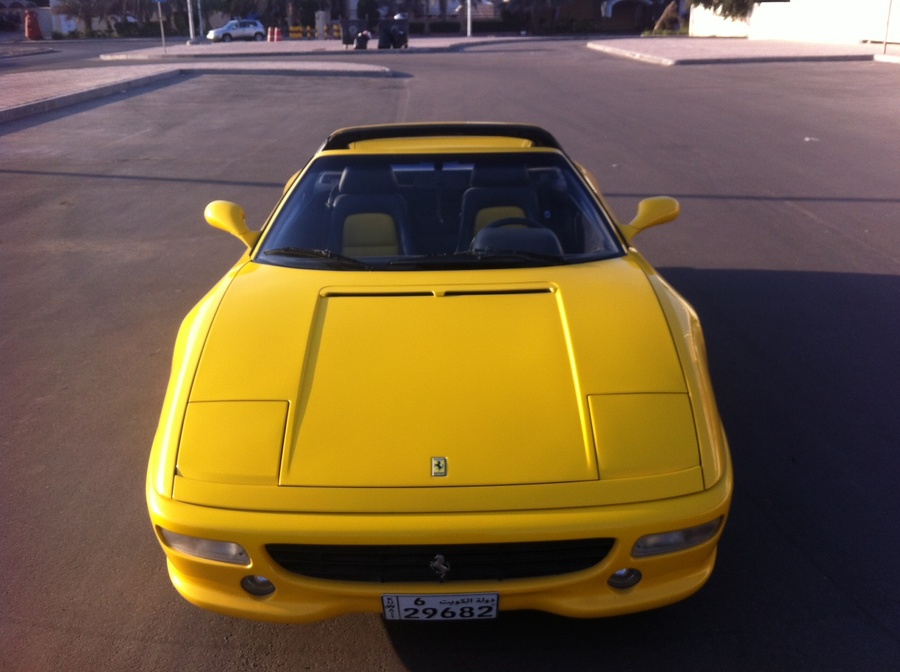

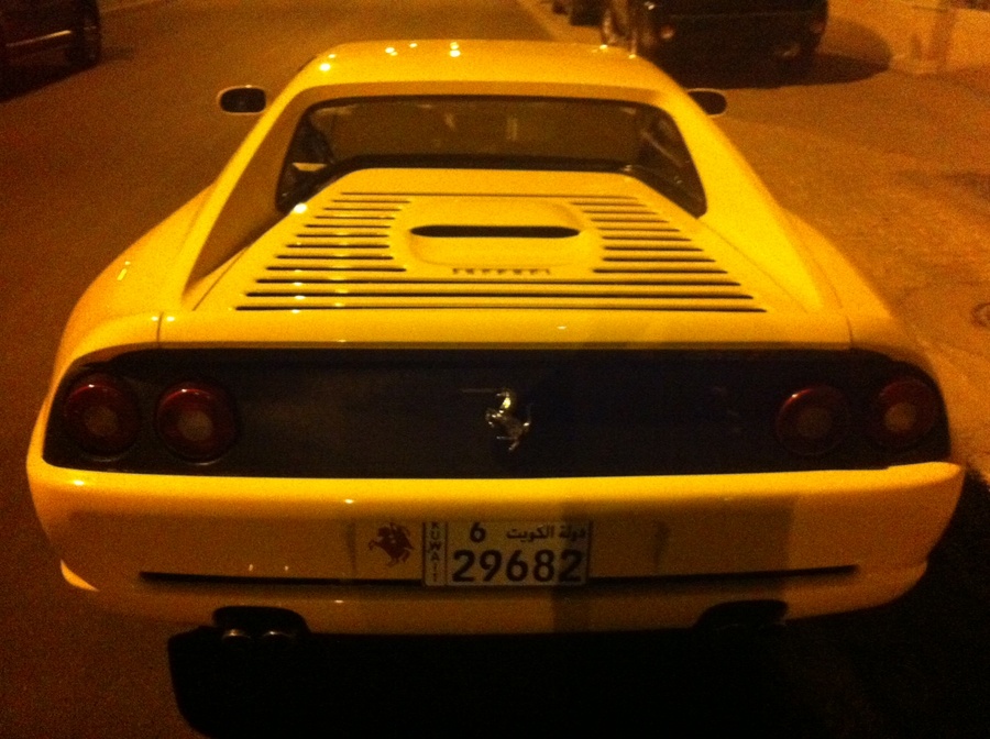

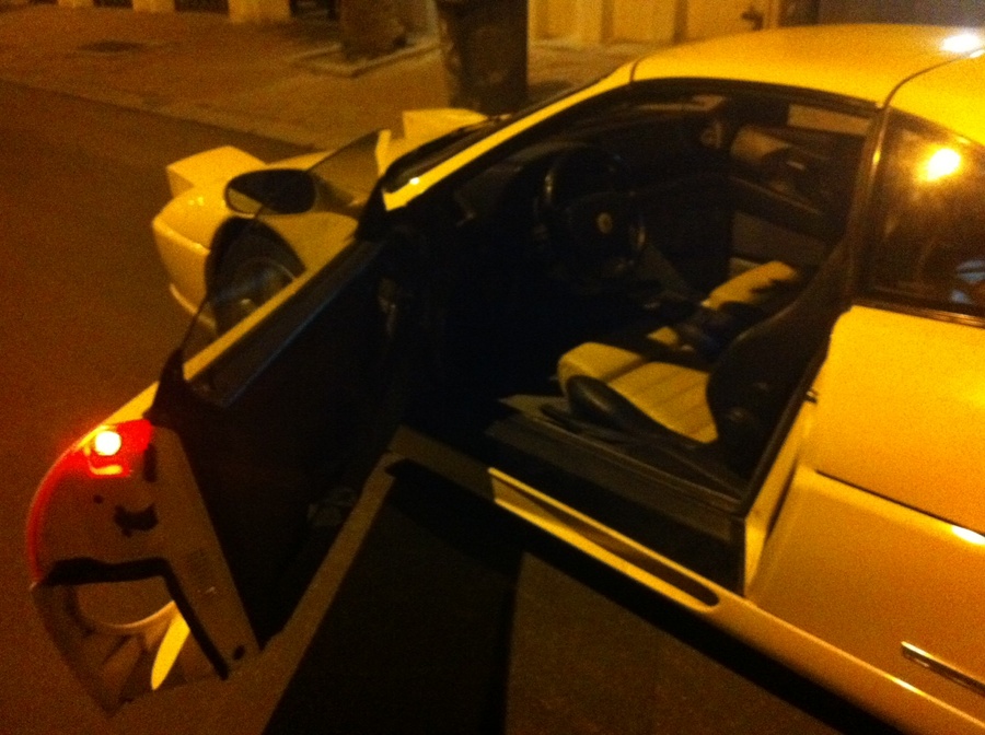

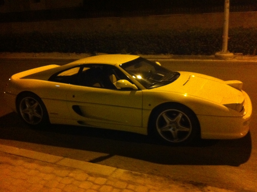

a lot has happened since the post above
but overall, all is well and it has been a long time coming

Nice shots bro! Your car is epic.
